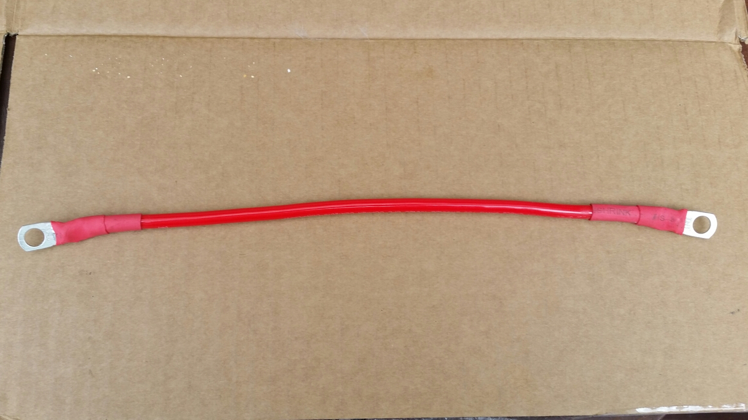

Just before Christmas I was out for a drive on a hot day (around 36deg c ) hadn't got very far and the car started to splutter a bit, and stalled at idle. After a short while I smelt the smell of burning bakelite. I headed home and after a little poking around thought that my Alternator may have fried.
I charged the battery and went to an autoelec. He said it was charging but something was wrong, there was a voltage drop from alternator to battery and even the voltage at the alternator was low (around 13V). As the burning smell had stopped and it was charging he said provided it stayed that way it would be ok for me to drive, as the chances he could fix it before new year were low.
After Christmas I decided to take a look at what was causing the voltage drop.
I took off all of the battery connections and cleaned them with a wire brush, also took off at the alternator end and did the same. Put it back together and I was getting 13.3V at the battery with no load. Which is better than I was getting before (about 12.8V)
However there was still a drop of around 0.5V unloaded from Alternator to the battery and around 0.9V when fully loaded (everything electrical turned on).
I realised that the size of the wire on the alternator didn't match the size on the battery, and figured they alternator wire must have been running to the starter motor. So off came the inlet manifold to get to the starter (not a small job).
The alternator cable was unfortunately crimped into the main starter cable on the same eye connector, not with it's own eye. So I went to Jaycar, got some 8ga wire and some heavy duty eye connectors and made up a short (probably about 300mm) auxilary cable from the alternator to the starter motor.
What a difference!
Now at idle (unloaded) I'm getting 13.9V at the battery and 0.01V drop from alternator to battery.
Fully loaded I'm getting around 12.9V at the battery and about 0.15V drop alternator to battery. That is a substantial improvement!
Attached are picks of my fancy new alternator cable. Do you think the OFC wire will improve my stock sound system :joker:
Tony.

13.9v is still too low, you should be able to easily get 14.4v at 2,000 rpm or if you blip the throttle, so yeah sounds like your alternator is gone. Especially if you drive around with the rear window demister on and your car conks out. Its the voltage regulator pack that is gone. Best idea is to simply replace the entire alternator, not worth it replacing just one component.
Also check the earth strap from engine to chassis, treat it to the same strip/wirebrush routine.
It's the usual source of all sorts of unhappiness in auto electrical systems - all the current passes through it (starter load on start; and all charging return on opposite sense the rest of the time) - since the alternator uses the engine block for 0v return, this little strap is in series with all measurement at the battery, yet it's often a pitiful little cheap thing usu. mounted low-down where road salt and everything else attacks, too.
The go-to, everytime charging voltage appears low: simply use a DVM to measure Vdc between the engine block (say, a convenient unplated bolt) and similar on the body nearby; aim for <0.1v under all loads.
HTH.
I agree to ensure each and every connection is solid before buying anything.
I have noticed that one of the diodes will often go bad. It definitely should be up over 14 volts and steady.
On many newer cars the brushes can be easily accessed and inspected, might be worth a look.
The the battery can be topped off(electrolyte), and charged up entirely for hours before evaluating things.

I did clean up the earth straps at the battery but I didn't check the Engine block and body connection points. There was some slight resistance (around 0.1 or 0.2 ohms) that I could detect between block and body before I cleaned up the battery connection, but I didn't think to measure voltage drop from block to battery or block to body!
I'll have a look at that this weekend, as all alternator voltage measurements were done with negative lead connected to the battery terminal. I could have another 0.5V drop on the earth side!
