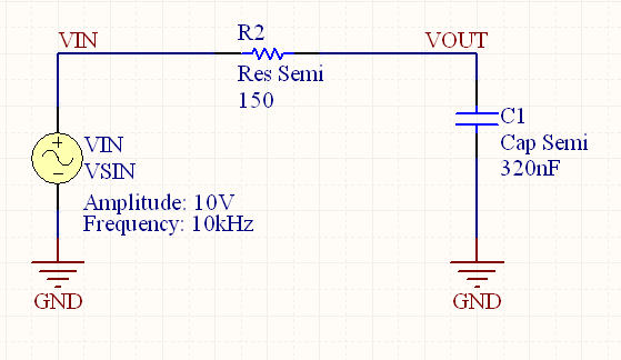

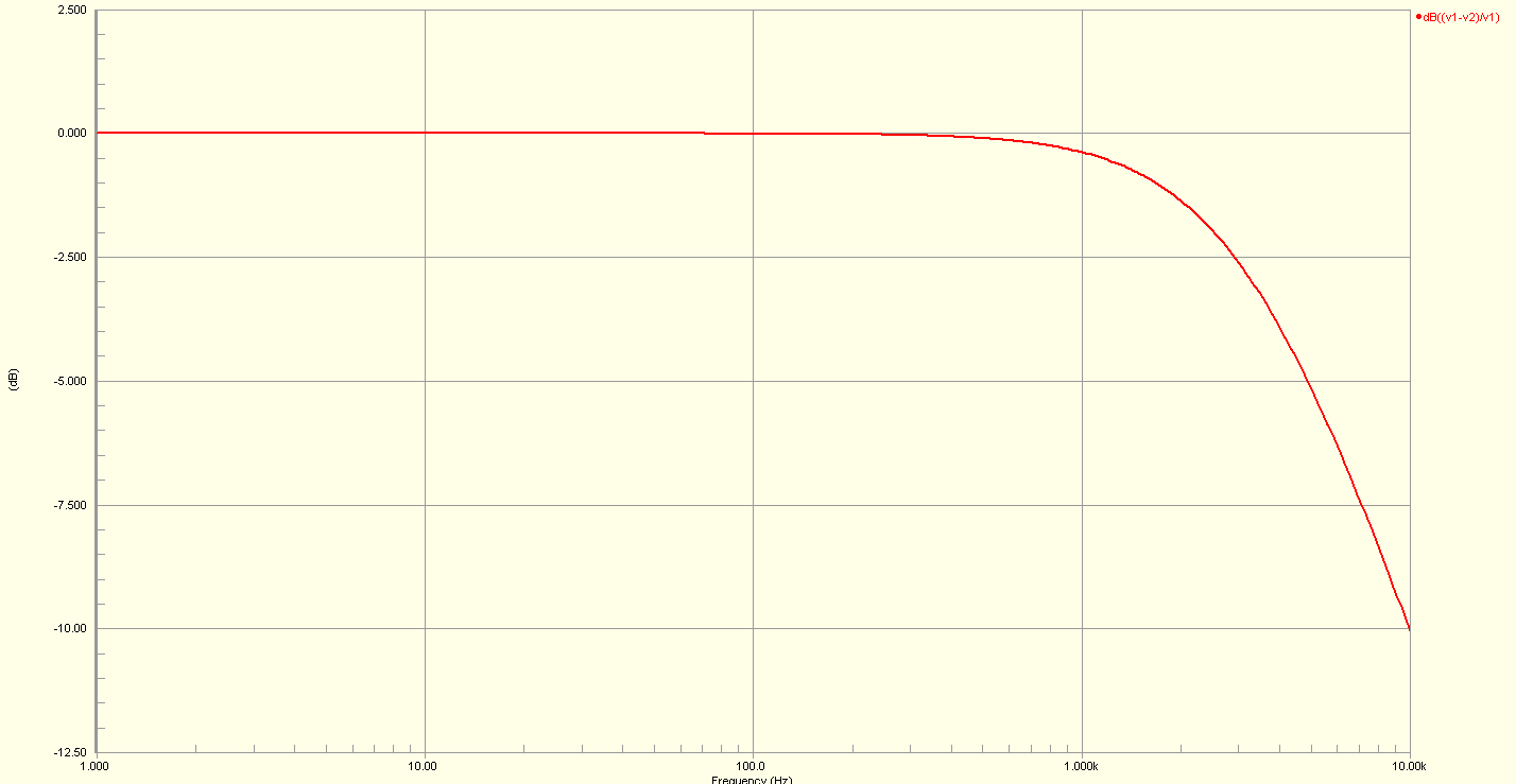

Saturnus, I just stumbled across this thread incidentally, and I have to say - I think Andrew is right.
I've gone and simulated the resistor/piezo network to show you. Attached are the circuit and a graph of the frequency response of the network, with C1 being the piezo driver, VOUT being the voltage across the piezo driver and VIN being the input voltage waveform. The response looks like a characteristic RC lowpass filter to me.
Below is the SPICE code for the simulation, so you can verify:
Change the position of the cap and the resistor.
Disabled Account
Joined 2008
Yes, then it becomes a high pass filter.
What does this have to do with your application, though? The piezo is driven by the voltage across it, no? And the piezo is represented by a capacitor in this instance. So, we should be comparing VOUT (the voltage across the piezo/capacitor) to VIN, as I've done.
Ohm and Kirchoff, long before the relatively worthless CTS app note, said that it wont make any difference. A series circuit will always have the same response no matter what the sequence. If there are no polar parts within it then you can even flip them. If you do that with the tweeter here, of course it will be 180 out of phase in one direction, but the frequency response will be the same.
I figured he didn't mean that we should directly measure the voltage across R to directly measure the voltage across C. That would be fundamentally confusing. It might be important to mention that that no matter what you measure, the tweeter is only going to play the voltage across C.
It might also be helpful to actually run an impedance sweep on the tweeter. Manually would be good enough, just pick a dozen frequencies and plot them out. This test wont lie to you.

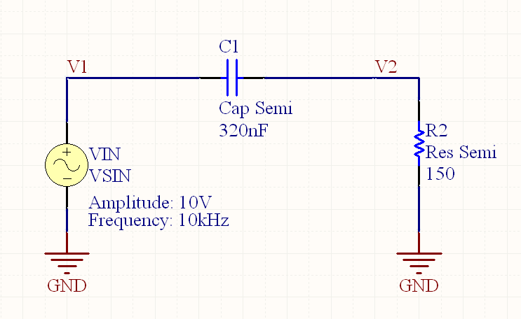

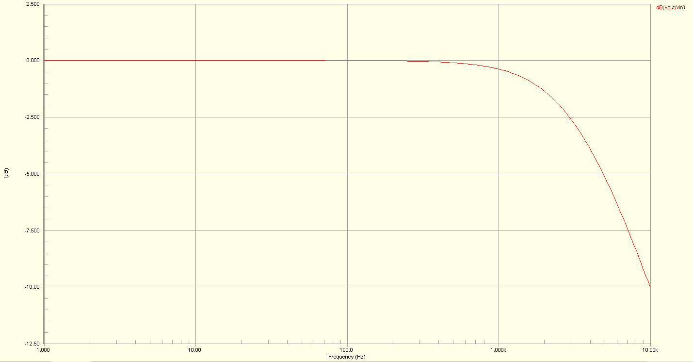

OK. I've swapped the position of the capacitor and resistor. I've also renamed the voltages to a more generic V1 and V2. Now, the output waveform is going to appear across the capacitor (representing the piezo), which is (V1 - V2). The input waveform is V1. I've attached a plot of the frequency response. Still a low pass filter.
Below is the SPICE netlist:
Code:
*Schematic Netlist:
C1 V2 V1 320nF CAP
R2 V2 0 150 RES
VIN V1 0 DC 0 SIN(0 10V 10kHz 0 0 0) AC 1 0
.SAVE 0 V1 V2 VIN#branch @VIN[z] @C1[i] @R2[i] @C1[p] @R2[p] @VIN[p]
*PLOT AC -1 1 A=@C1[i]
*Selected Circuit Analyses:
.AC DEC 100 1 1E4
*Models and Subcircuits:
.MODEL CAP C()
.MODEL RES R()
.END
