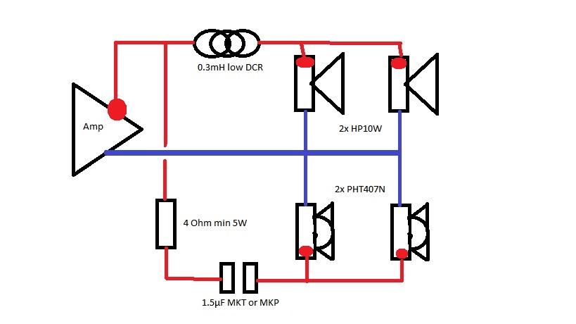

Here's a sketch of the commonly used passive x-over for the PHT 407N.

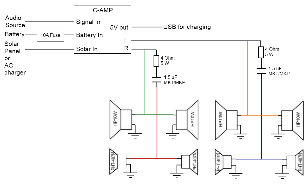

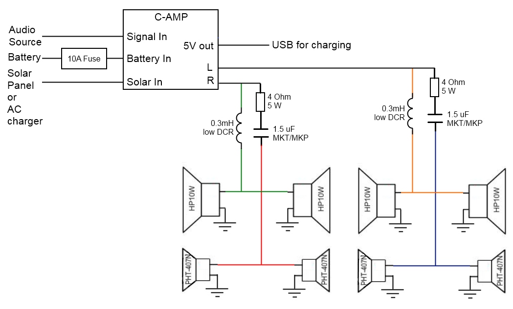

This is my updated diagram. I added the filter components for the PHT407s (thanks Saturnus for posting the filter values). I also added a fuse on the battery input. Just to confirm, the cAMP takes care of the filtering for the HP10s, correct?
Anything missing here?
No, the cAMP is a full range stereo. If it filtered away the high end there'd be no signal for the tweeters. You need the series inductor.
Oh, right, that makes sense. Sorry for the basic questions, I just want to make sure I have everything right before I get started building.
I actually miss the point, why there is a series inductor needed for HP10W, it just acts as a low pass? (Nothing to do with the tweeters)
He means that if the cAMP itself filtered out the high frequencies, like I had incorrectly mentioned/diagrammed earlier, there would be no signal for the tweeters.
Since it outputs the whole spectrum, you need the full crossover circuitry.
