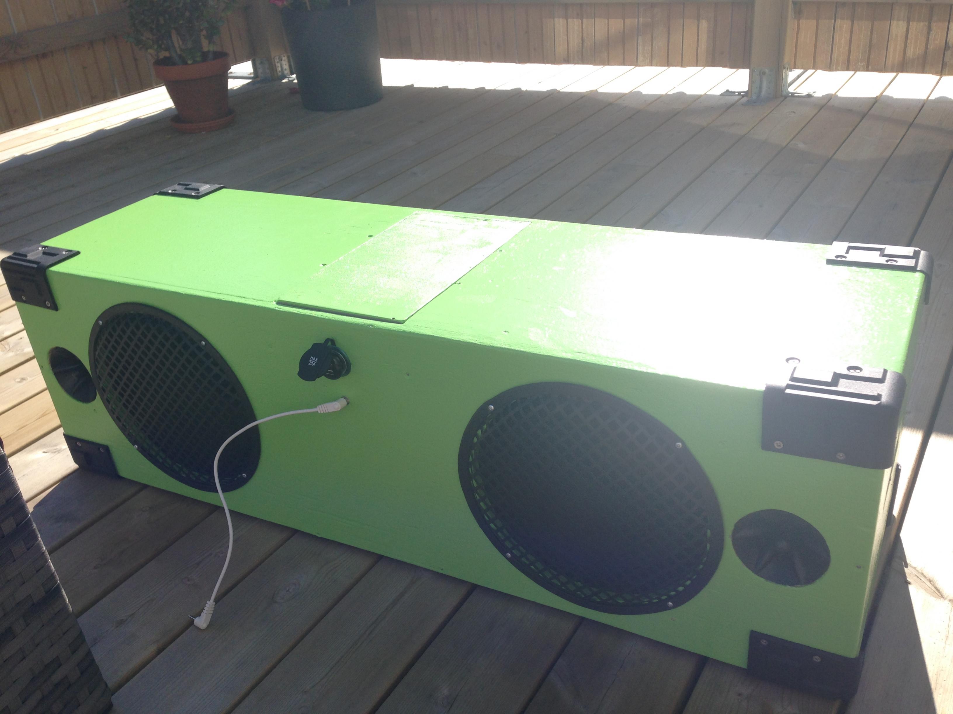

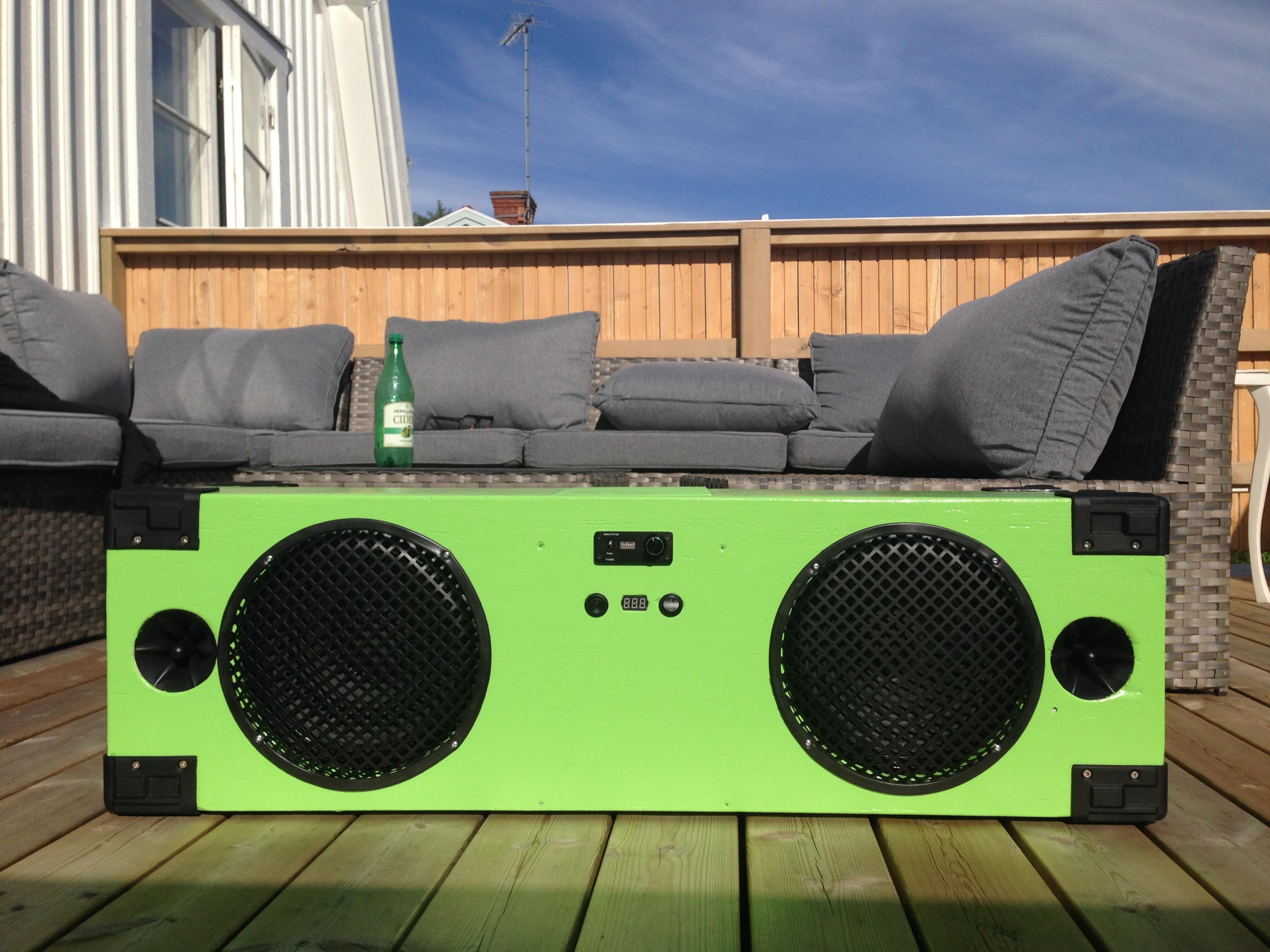

Im quite heavily into home Hi-Fi and needed a bluetooth 'boombox', long story short, during the browsing session came across the V2 boominator mini and though i'd spend my money wisely and build rather than buy, found this thread and built one .... got it finished tonight and Im 'ABSOLUTELY BLOWN AWAY' the little box is a bloody animal, bought the set from accusafe along with a maxamps 20, didnt pack but wrapped the inside with eggbox acoustic foam and a cheap bluetooth receiver ,
I finished the case by dark oak waxing a carbon slide for the 3300 4s lipo and a Fender leather handle,
just had 6 hours running the speakers in outdoor's in the moonlight with Pink Floyd, The Door, Santana and a little Morcheeba and Im in love, Saturnus you are a Legend thank you
money has been well spent and as you can probably tell Im a happy bunny

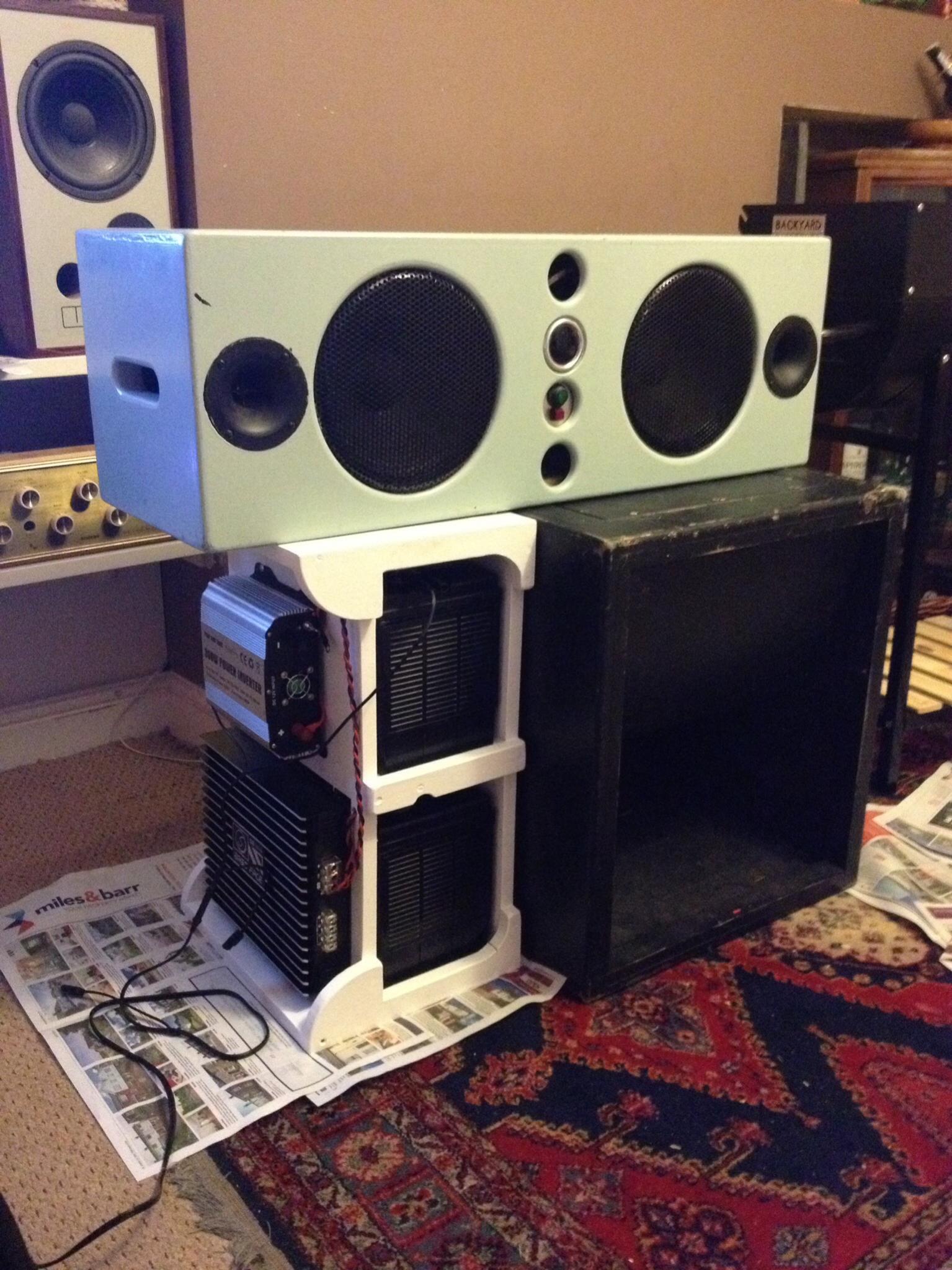

Inspired by shortropes Tham15 system I thought that I'd put one of my HD15s to good use....... I've wanted a battery system to run inverters for decks, laptop chargers etc for a while now......
So, two 110ah deep cycle batteries, one running a 300w inverter and the other running a bassface db1.2 mono class D subwoofer amp, connected to a HD15.....
Not fully tested yet but I'm a little disappointed already. Great to have a power plant all built into a single integrated unit, I knew it would be heavy but jeez, it is so heavy, it kinda defeats the object of portability..... I may as well cart a generator about.....
I may have to split it into separate units....
Will be using it in anger at the weekend so I'll report back....
