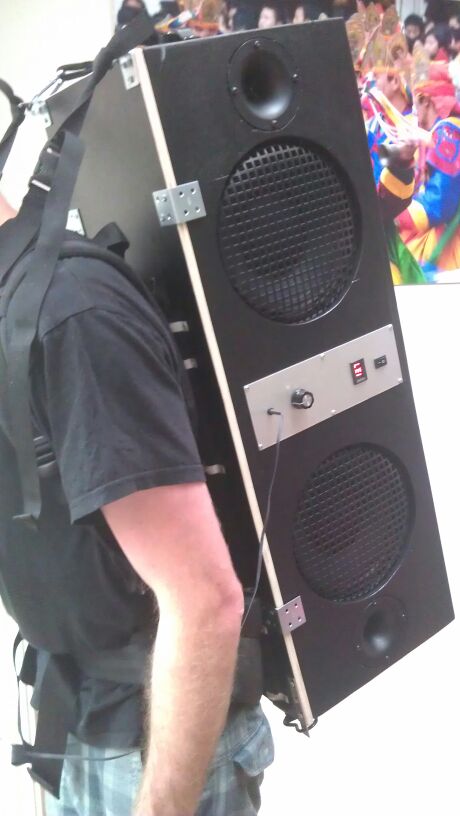

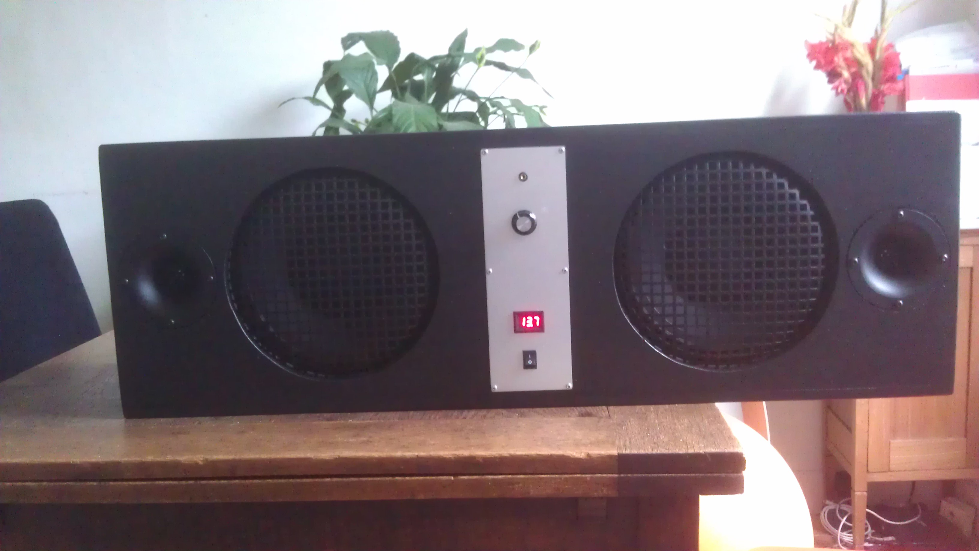

I've finaly finished my boominator backpack! Thanks to Saturnus of course, and thanks to Wesley who has been incredibly helpful. I've called him so many times with probably dumb questions... THANKS!
Because I wanted to make a backpack boominater I used the lightweight Basslite S2010 woofers. I can't compare the sound to the other designs, but it's impressive! Not just the loudness, but especially the sound quality. Probably due to the 2 maxamps and Mini DSP as well. I've used two 9.2 Ah LiFePo4 batteries, so it should last a long time...
So now its time for the mini... Good luck to everyone, hope to meet you all someday at a boominator meet up in the Netherlands - Wesley? :)
Tijl

Nicely done! Big backpack, the mini should be a lot more 'backpackable' :). Any photos of the build process?
There are only 4 Boominators in the Netherlands to my knowledge, but a general boombox meetup would be cool. The Boominator is making it's way up tho, so maybe next year there could be a real Boominator meeting :).

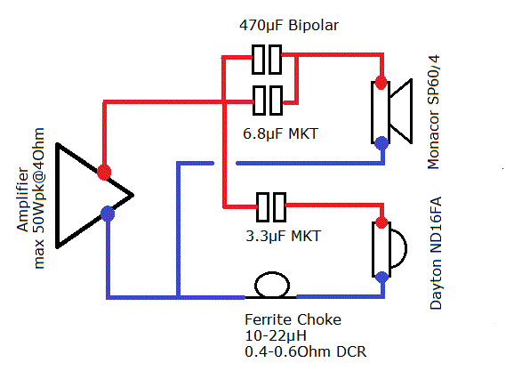

Over the last several weeks, I've read through a good-size chunk of this thread (realistically still only 20-40% probably, haha), and the entire thread over at speakerplans. I've seen that this question has been asked a few times, but I don't think I ever saw an answer - or at least forgot, then could not find it again after searching over the last few days. I seem to remember that after the original aura speakers were discontinued, Saturnus made modifications to the cabinet to accommodate the SP60s.
First, is it feasible at all to try to get another speaker "close" to the SP60? Just trying to match on listed specs, this speaker seemed to be the closest I've found so far. I'm not so concerned with the lower sensitivity, if it only means less volume, but I'm more worried that it would be unsuited for the cabinet or that the different frequency response couldn't be compensated for by adjusting the crossover. The difference in price for me to purchase these vs shipping speakers from europe is over $70, so I thought it worthwhile to ask.
Second, when I was looking back at an amp I'd found back before I discovered the boominator project, I noticed that it is also a max9744 based part. Would this be a reasonable substitution for the maxamp20? I notice that the maxamp is using two caps vs one showing on the adafruit. Adafruit says theirs is for smoothing out the input power (which shouldn't be an issue on battery power, right?), where I'm guessing the maxamp might be using theirs on the outputs. Looking at the datasheet for the max9744, I see that it supports two output modes: Filterless Modulation and PWM, for which they recommend using an output filter. Would I realistically even hear the difference between the two modes and if so, could I just add my own output filter using the specs in the max9744 datasheet?
