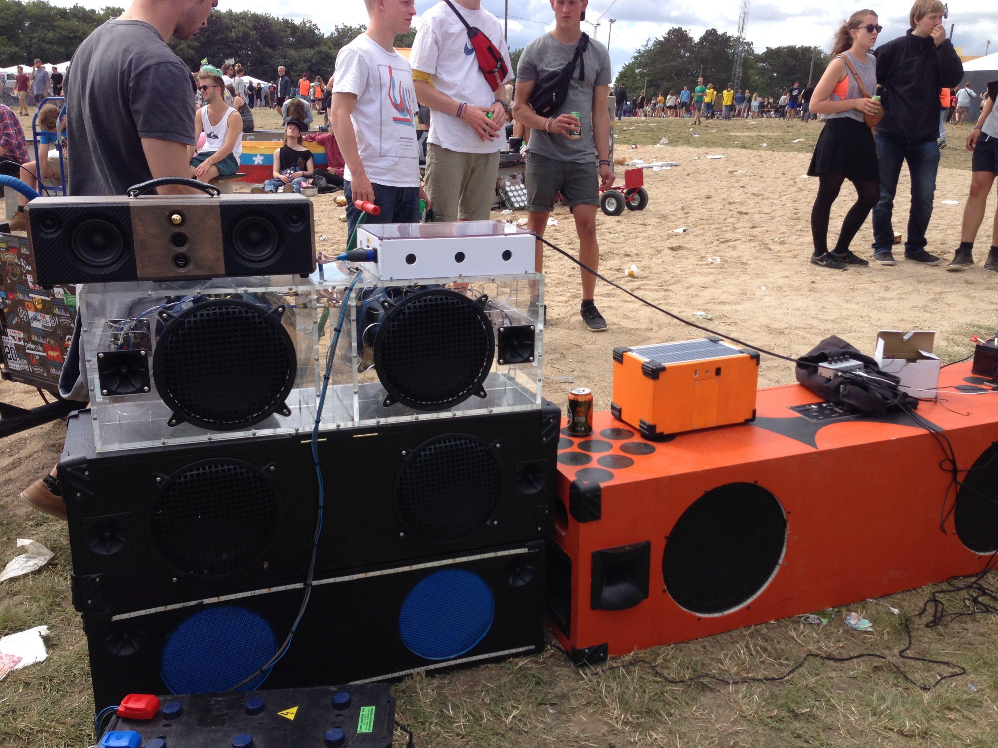

I guess it's my time to share a few pitures
It all started back in january, where i began ordering parts for my Boominator Mini (Aurasound NS525 255)
I made the electronict room 80mm to fit four Headway LiFePO4 10Ah cells, and had a custom aluminium front panel made.
I chose to have a latching switch for on/off, a speakon plug for power in/out and a type d blanking plate with a 6mm hole for a female minijack plug.
I made an error while designing the front plate... The screw holes are +/- 1mm to far away from the center, so i had to drill new holes... Otherwise everything looks great.
I bought the wood and had it cut out - won't get i done at that place another time.. Price was great, plywood was great but cuts were a bit uneven. Oh well, life goes. I used a hole saw for the bracing, and rounded the corners a little:
Time for the crossovers. This was a lot of fun, since i love electronics and soldering I think it ended up great
While doing all this work I started to get hungry. I was doing all the work in my mothers basement, so i found something good
Time for the front panels. I had a 127mm holesaw, but I finaly had an excuse to buy a router, so I had to get one. After playing with it for a while, I figured it out and made some nice holes. I made a 45° cut to give it a nice look and to make sure there wasn't any "sharp" edges.
I painted the holes before mounting anything, just to make sure I could get it all covered. Here's an early view of the final result. You can also see four holes on the top, theese are used for a handle.
I used kick-proof nylon cloth as speaker grills, and monted the tweeters in four small pieces of wood, so i could place the nylon cloth between the tweeter units and the speaker cabinet. Woofers are mounted the standard way, so nothing special here. Everything was glued up (and a few nails). I used the router and a flush trim bit to make the hole in the wood for the frontpanel, after glueing everything together. This way i made sure, the hole in the front wood, would fit perfectly with the electronics compartment. Here you can see everything while i was painting it with Warnex paint:
Sunday morning, a few hours before Roskilde festival, the female minijack died, and since i only had a really short cable for my Maxamp, i had to make i go between the cabinet and the aluminium front panel... ugly solution and not good in rain since i couldn't tighten the front panel, but it worked, and i didn't have time for anything else. Here you can see the final result from the Boominator meetup:
Oh, another fun story... I chose to buy a $10 china solar charge controller - bad choice. It couldn't charge and discharge the batteries at the same time, and after five days it died completely. The fuse was soldered on, but even after making a short circuit, the board didn't work, although the LED's on the board worked again. Lesson learned, don't buy things too cheap
While I'm at it, here's a picture from a standard morning at Roskilde. Using a peg? (the things to hold the tents to the ground) as a spoon, I could put tomato paste on some crispbread. Worked great, and I could use my Boominator Mini as a small table

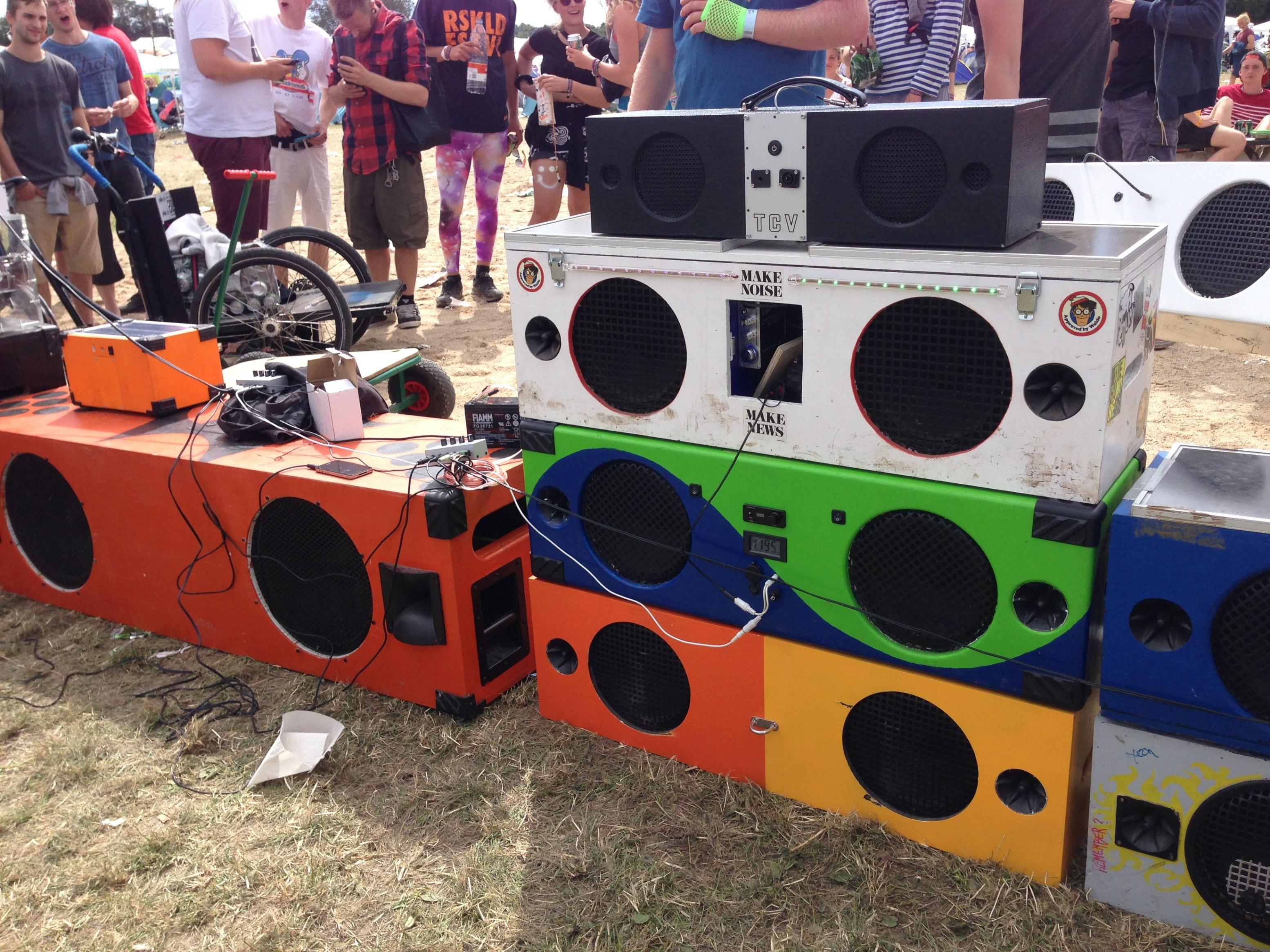

Good work Thombi!
I saw your Mini V1 at the Roskilde Meet.
(Ours were the only minis there, mine was the V2)
Yours looked good and I liked your use of the 4 pole speakon for break out cables.
Also like that you fitted a 10Ah battery in there.
The meet was fun though it would have been nice to have got to listen to the individual systems properly.
I managed to get my V2 home safe and sound. (Yay!)
Although we didn't use it all day and all night like some camps, we still used it a fair bit.
It has a LifePo4 8.4Ah and after 6 days at Roskilde, one half day at home, and charging my iphone 4 times, the voltage still read 11.6V.
So super pleased with Roskilde 2014 and the Mini V2's performance.

Lukteveld,
The orange box was a solar powered non boominator boombox.
I sadly didnt get to compare the v2 to anything.
Mostly there were at least 6 boominators hooked up to a distribution amplifier playing at the same time so didnt really get to hear anything on its own.
Obviously the v2 will take a beating from its bigger siblings but our camp loved the sound and volume of the v2. And though there is always ambient noise at a festival it had a nice full sound provided you weren't too far away.
I do wish I had got to hear Thombi's v1 though.
