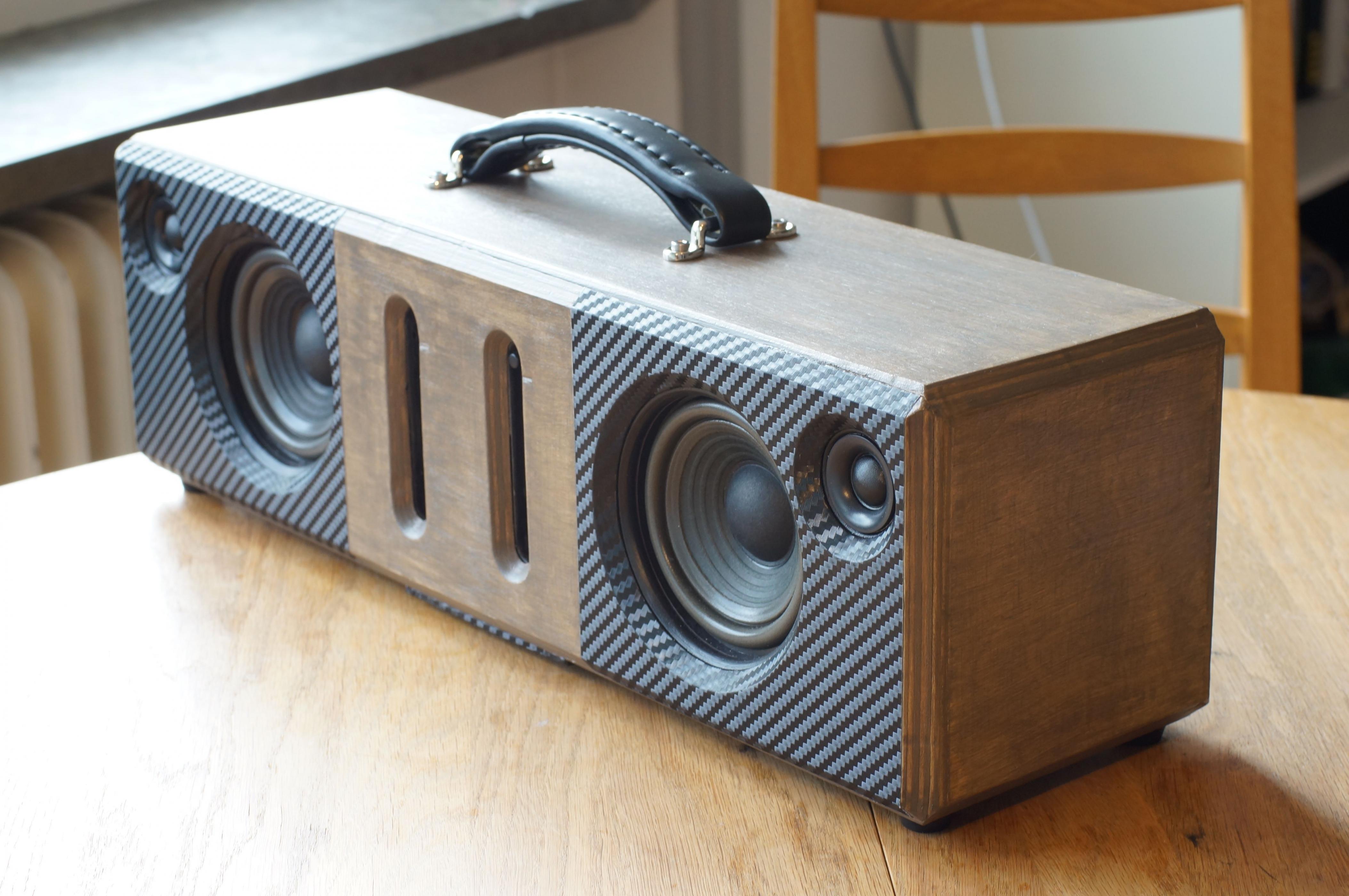

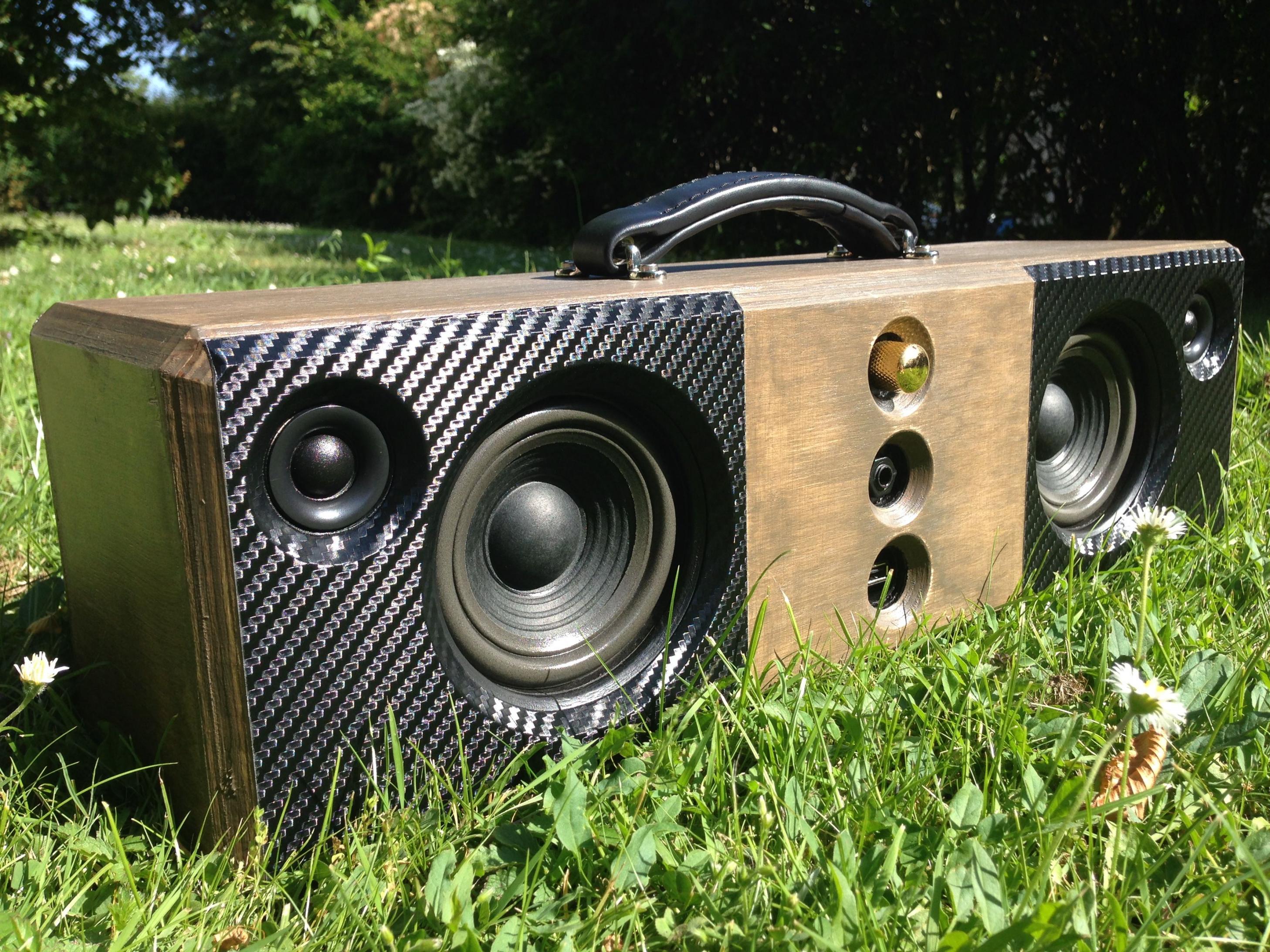

Managed to finish my Mini V2 in time for the midsummer weekend.
Sounds very nice though it does respond well to a bit of added base on the in app eq on my phone. (I use the eq10 app)
A huge thanks to all the people who took the time to answer my questions and of course Saturnus for making the design available to us.

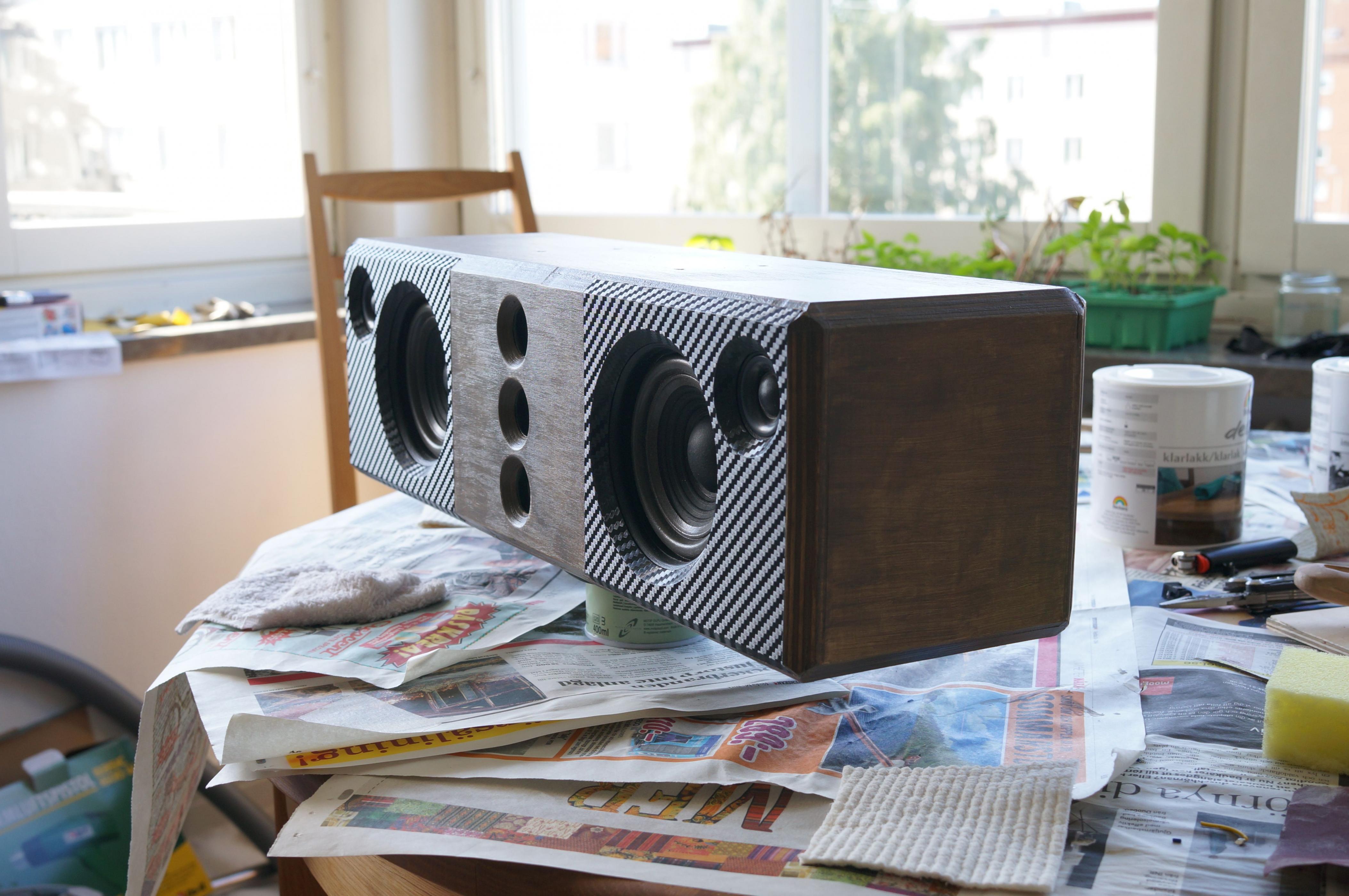

Got stuck in deciding to go for a retro or modern look and tried to go with both in the end.
Also due to time restraints (i.e tidying my mistakes) I went with the rough sawn look instead of the original plan to try to get everything as straight as possible using filler and paint.
No I haven't got speaker grills as I just couldn't decide on what to do. I will need to keep an eye on it but then it doesn't have corner bash protecters ether.

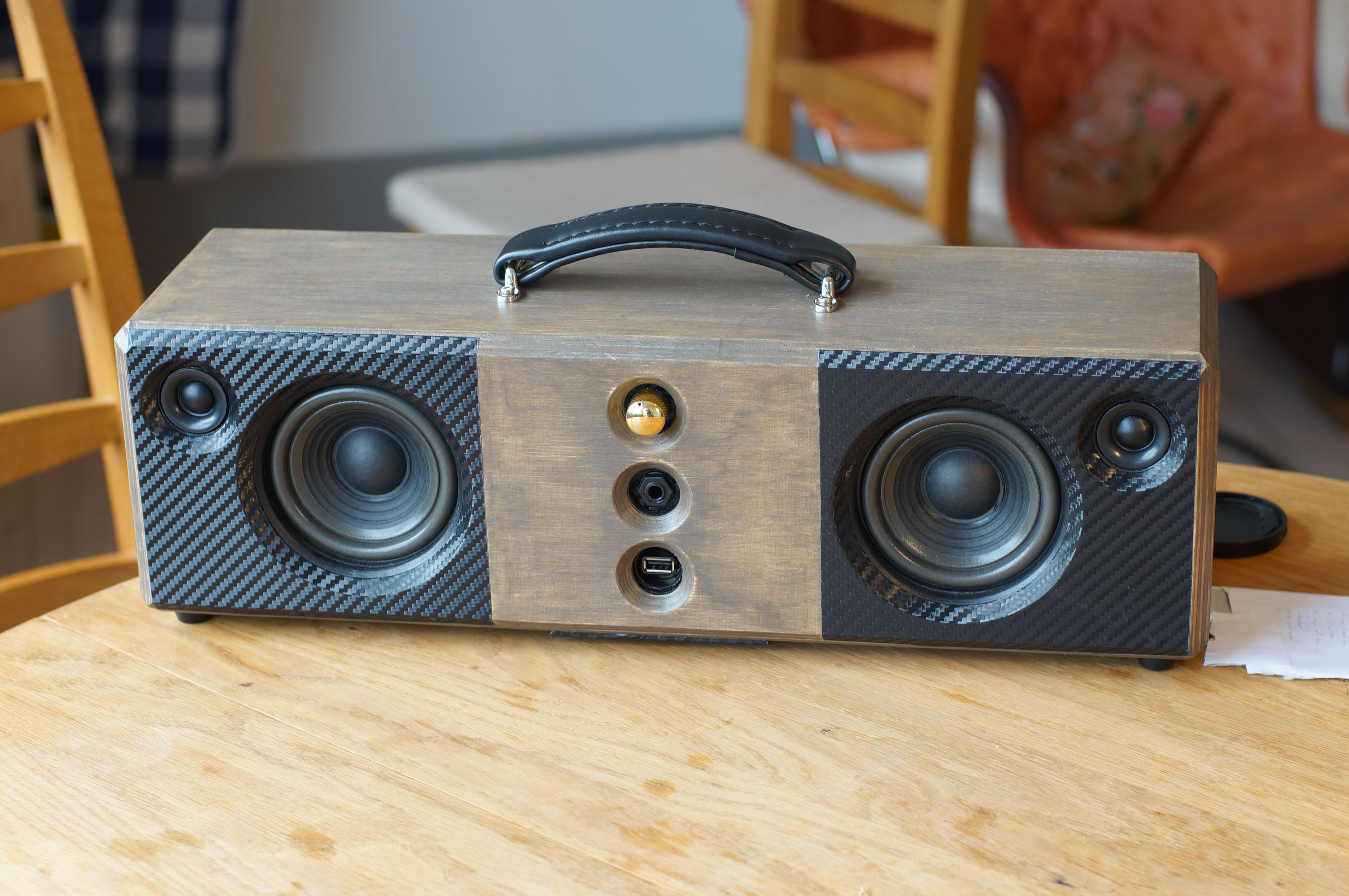

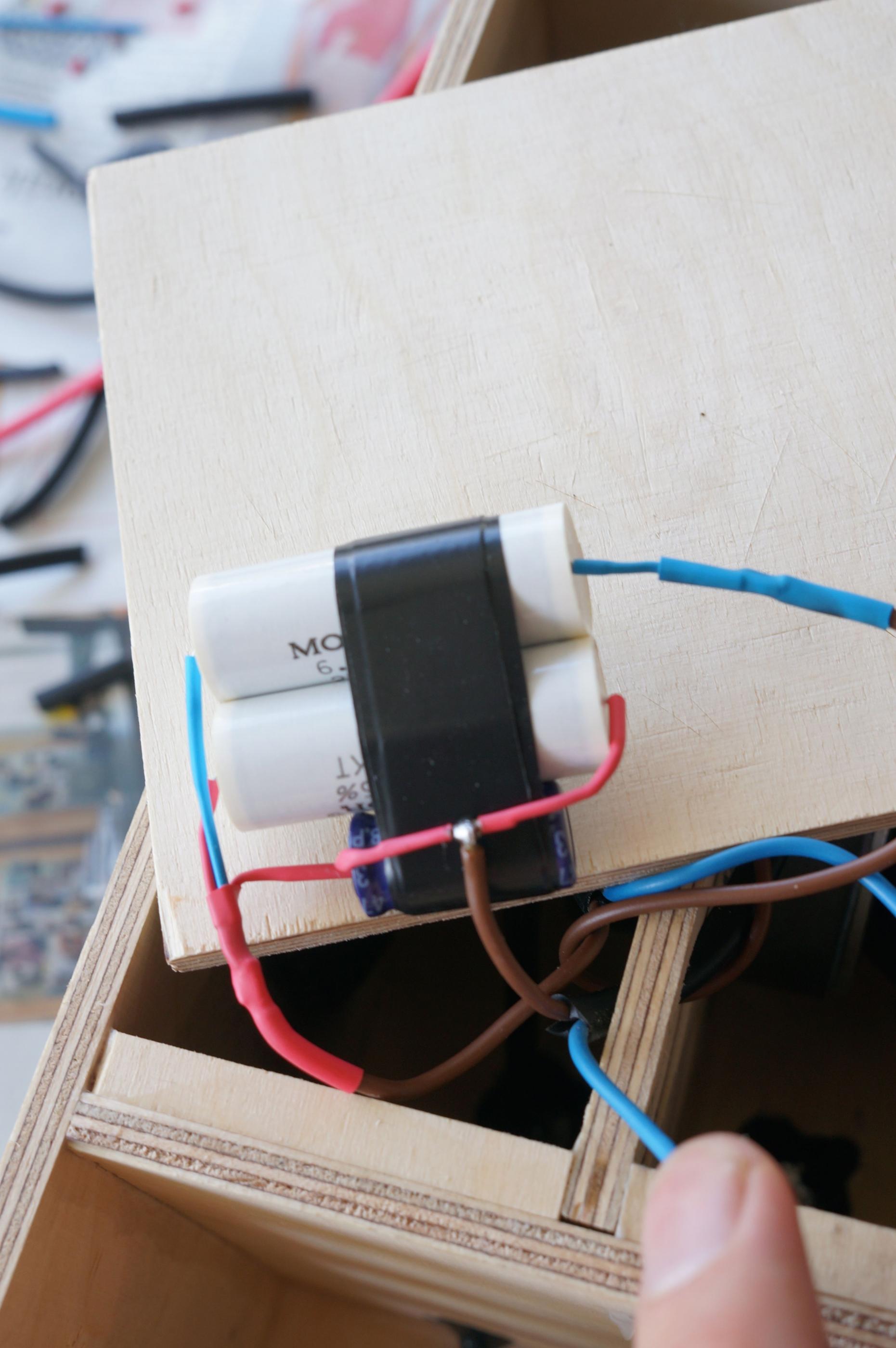

Good news is I managed to squeeze in bluetooth as well as an 8.4Ah 4S LifePo4 batt and a full charging management system with fuel gauge which makes charging super easy.

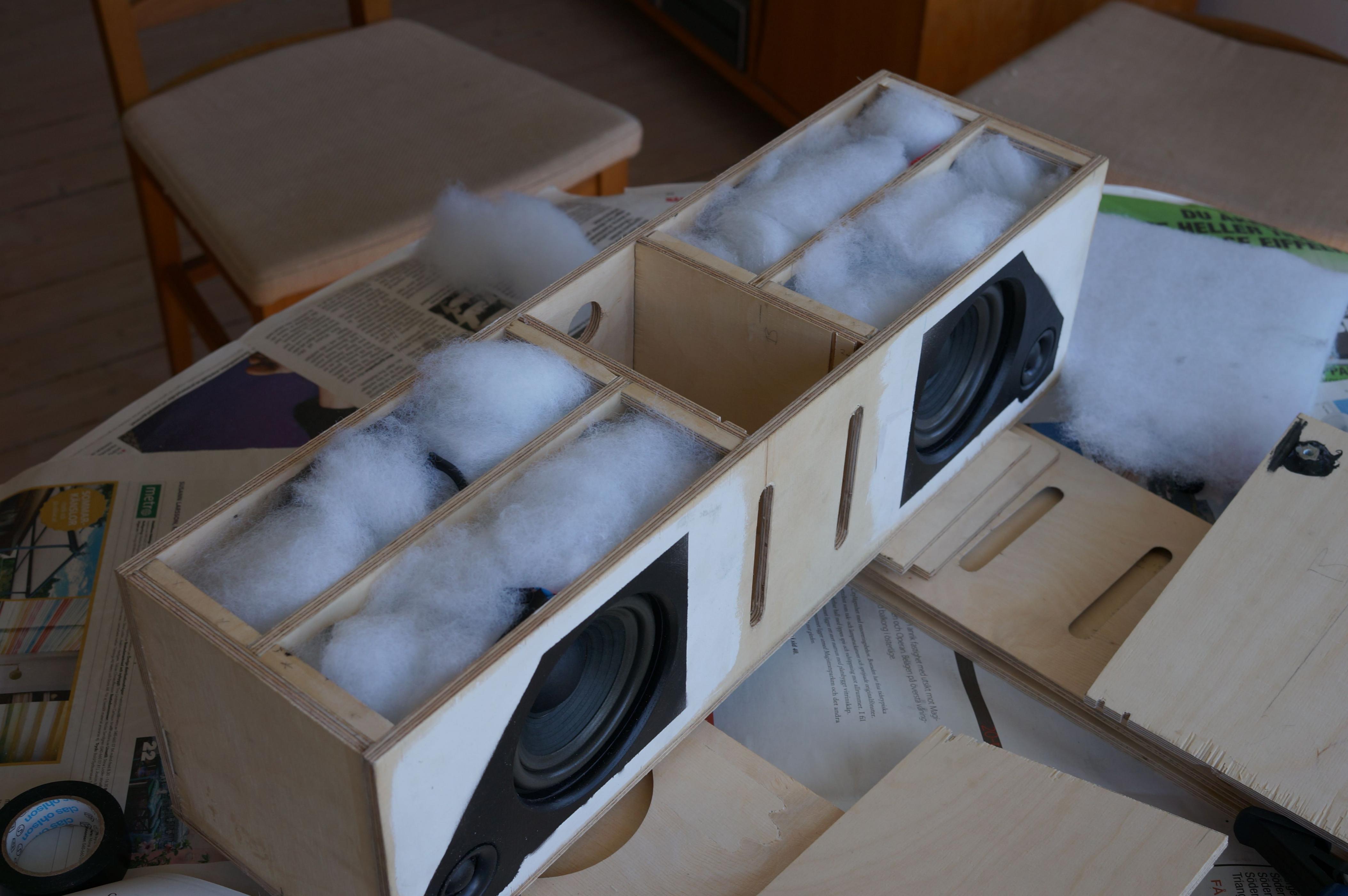

Total length is 510mm as I needed more space for electronics (76mm) and a bit more space in the enclosures as I had to beef up the corners for the routing.

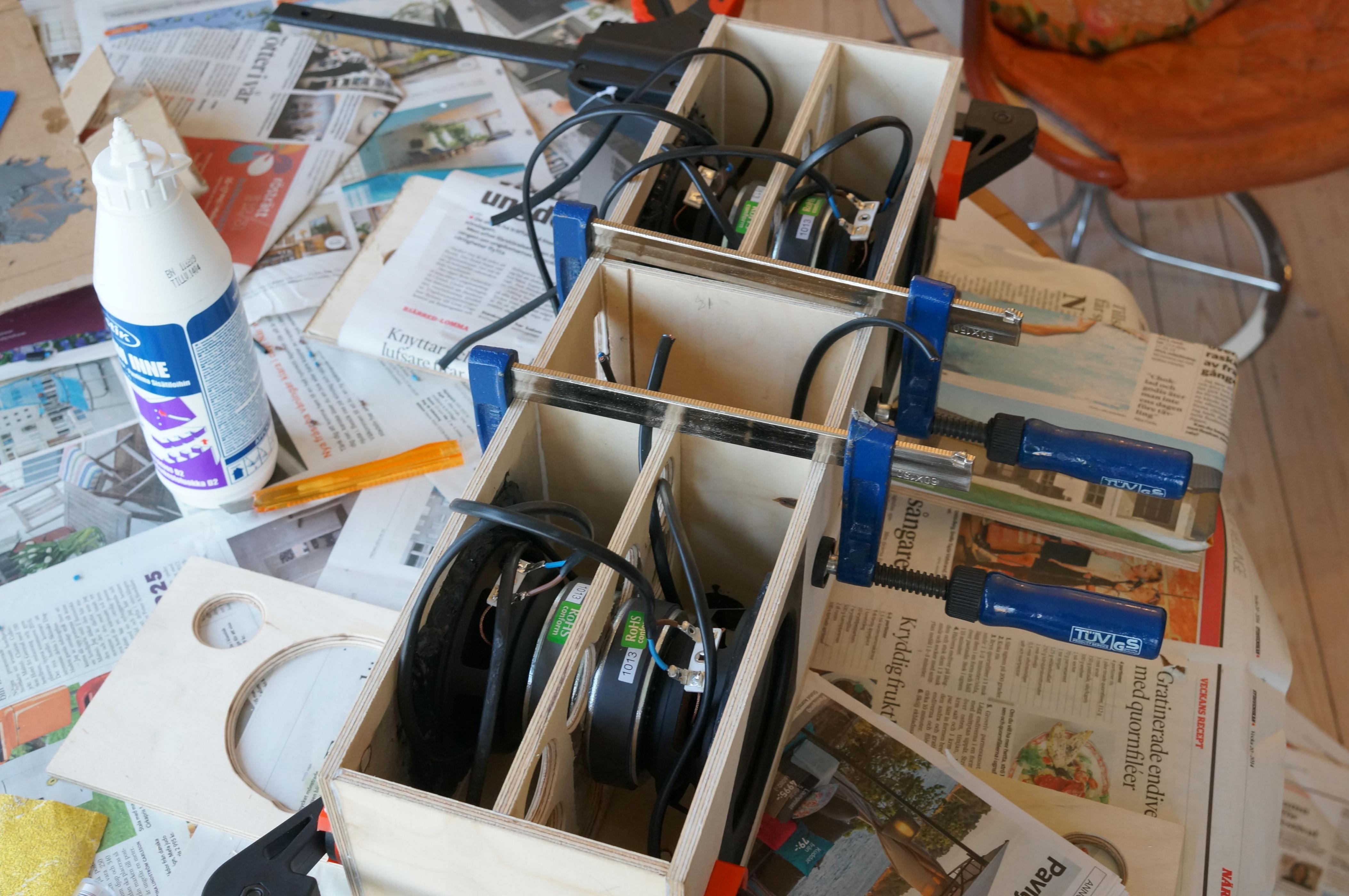

A few tips:
Everything takes a lot longer than you think..
The sp60 seems to me 61mm deep instead of 60. (Off the top of my head)
And check the thickness of the ply as Saturnus said. I managed to get caught out even though I had been warned. (It was sold as 6mm but was 6.5mm)
Bluetooth has its limits but I use it 95 percent of the time so it is worth it for me.
But be gentle with the Sure BT units when installing as they are super fragile.
Have more pics of the build if anyone wants them.
Looks very good, what kind of BT module did you use and what kind of power supply ? I am guessing the fronts are the solar cells so you have a charge controller ?
Cheers!
Donnib,
It would be sweet if they where solar cells but sadly they are not.
The BT Module is made by Sure Electronics.

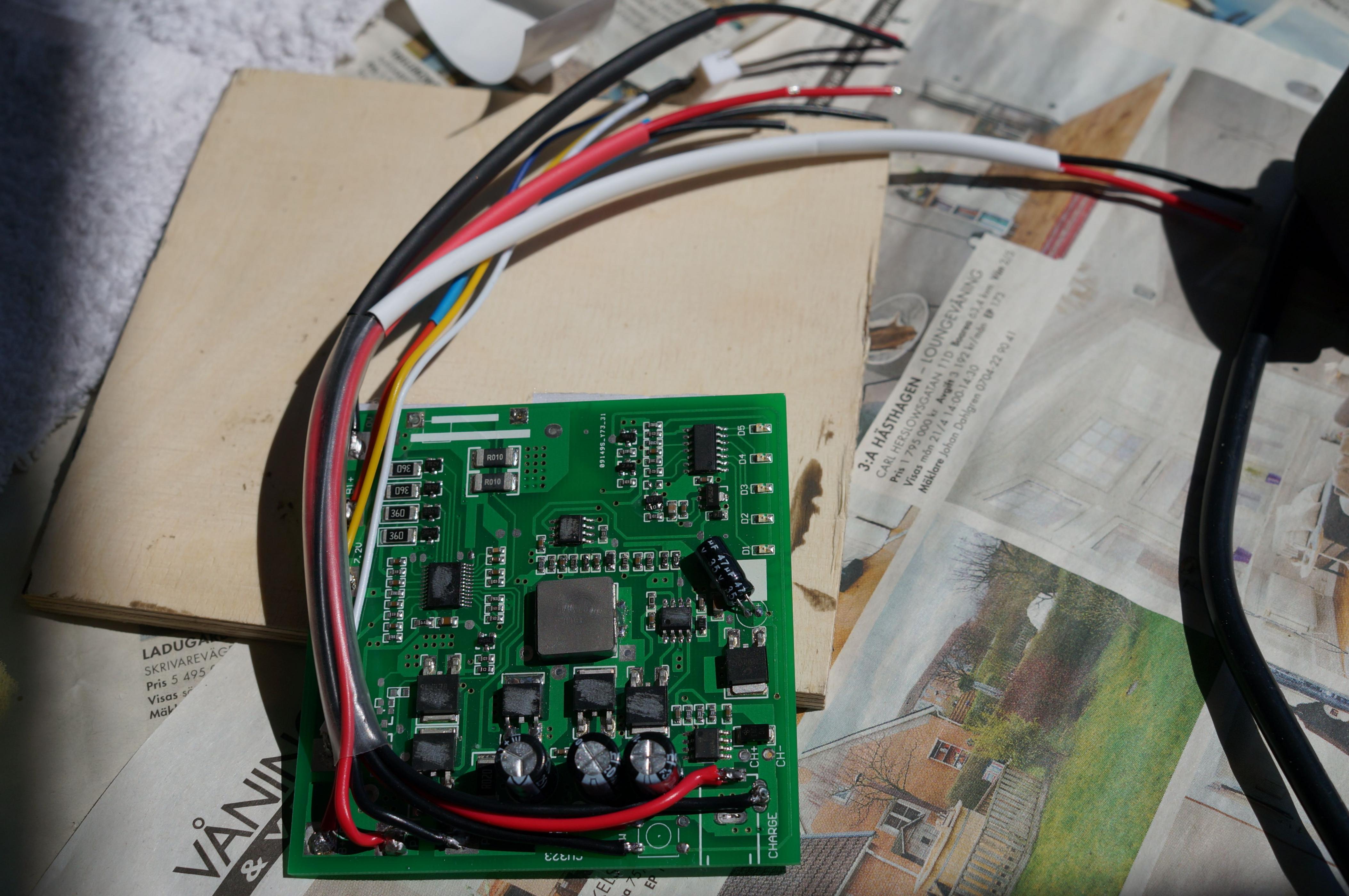

The Charge Controller is from Alibaba:
Amp is a maxamp.
CV323 -CMB(charging management board) For 4S Lifepo4 battery pack, View lifepo4 charging management pcb, AYAA Product Details from Shenzhen Ayaa Technology Co., Ltd. on Alibaba.com
I just plug a 19v switch mode PSU into a socket which is located in the top of the left front grill to charge.
There is a momentary button on the top of the right grill which lights up leds behind the grill cloth to display the voltage.
The Charging Management Board seems to work well and the company was good to deal with though it takes ages and you need to order at least 4.

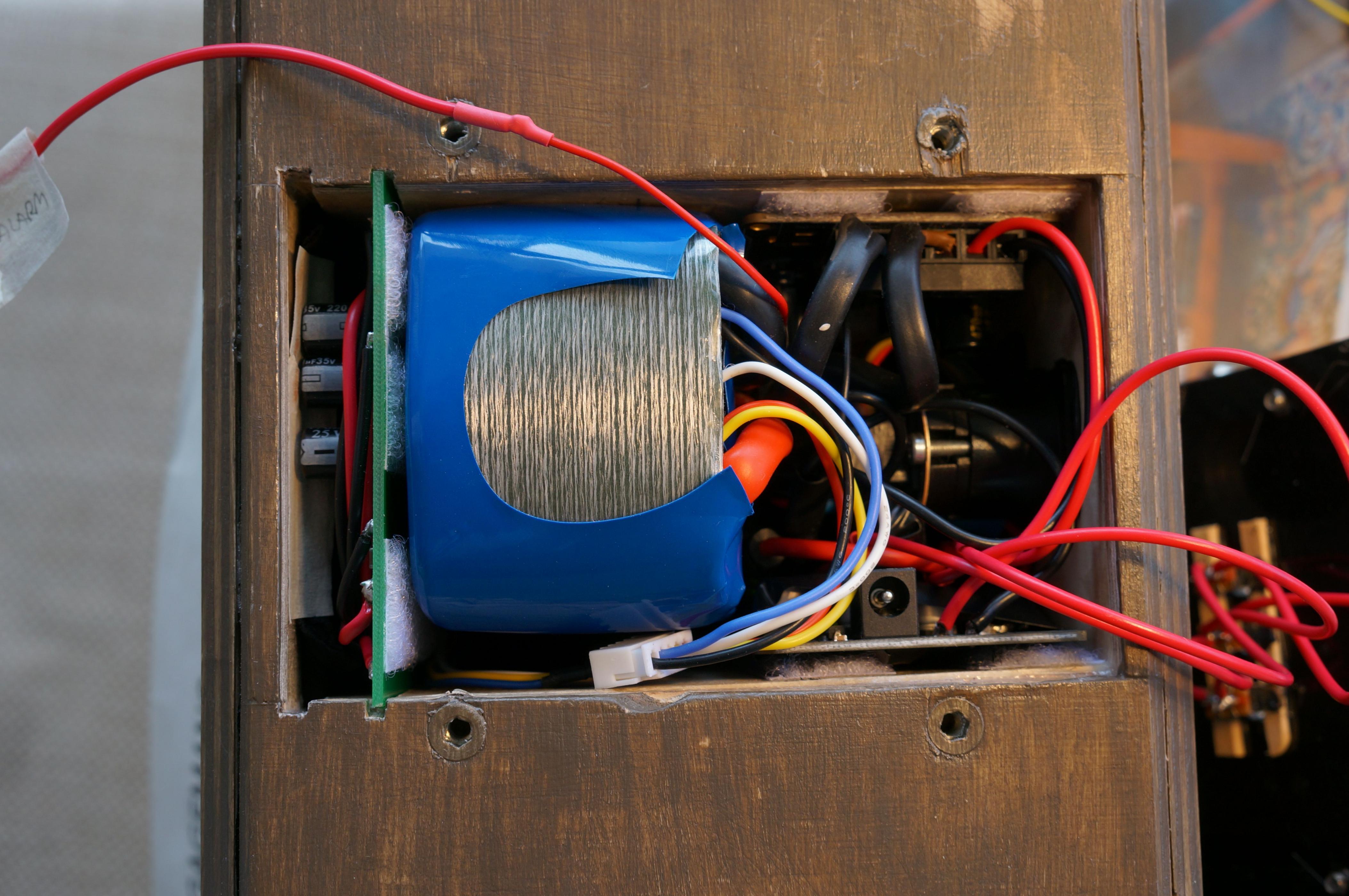

The battery is from HobbyKing:
Radio Control Planes, Helicopters, Cars, Boats, FPV and Quadcopters - Hobbyking
Note the battery is 150mm long which means the bottom is flush with the outside of the boombox and the reason why the electronic cover is not recessed.
Hobby King do a smaller 4.2Ah batt that will fit easier but I already had the bigger batt and love the run times it can achieve.
Also note these batteries do not have a BMS or anything. I have used them in the past without a BMS and just used a hobby balance charger but if you forget to turn the boombox off it will kill your expensive batteries.
I love the simplicity of having a BMS or even better a CMB as it looks after the charging. (Charging Management Board)

Woytek,
Haven't had a nice quiet open space to really test it out properly yet.
That said I have had it on a lawn near a busy road and a fair bit of wind and as long as you were close enough it could punch through the ambient noise well.
Its important to keep things in perspective as its a boombox with 4 inch drivers.
That said the biggest problem for me with boomboxes outdoors is ambient noise and provided you aren't too far away the Mini V2 copes very well.
I find it benefits from a bit of an eq base boost, at which point she cranks nicely and has a full large sound. However it is possible that at higher volumes the base will be more prominent even with a flat eq.
One other thing you notice is the weight, its super heavy for its size!
It makes it feel more like pro audio but make sure you fit a decent handle if you plan to carry it around a lot.
And lastly most speaker systems sound better after a burn in period so its exciting to think it may sound even better soon..
