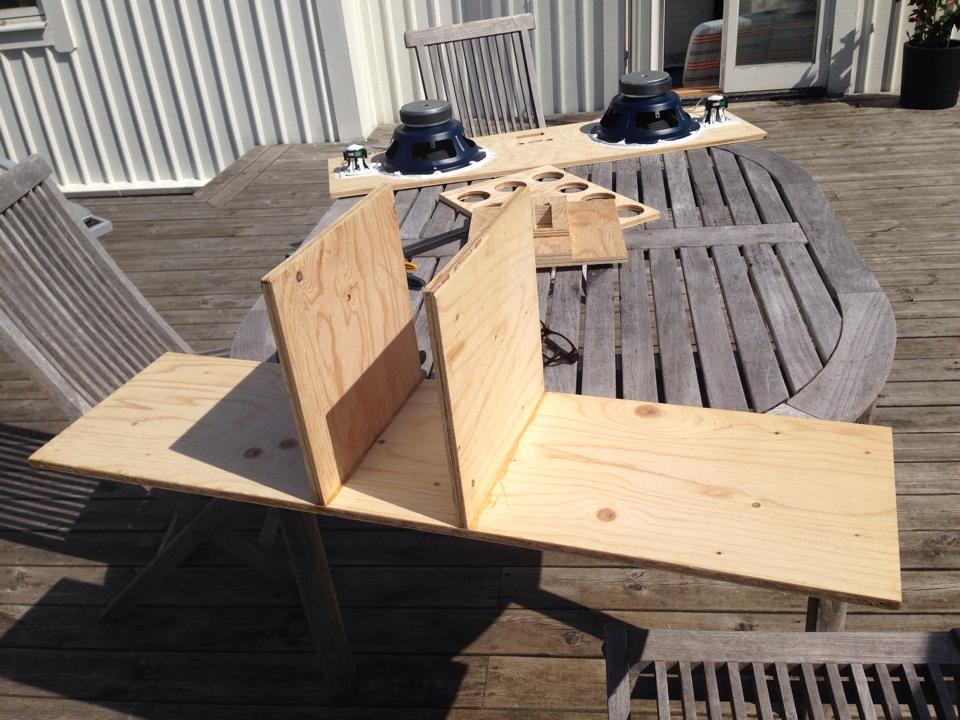

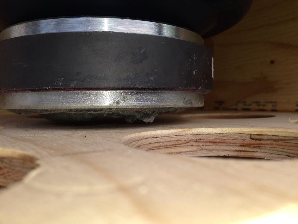

I have some problem with my build...
Ive glued the braces together with one side of the magnet and when i was about to glue the other side with the other two magnets i saw there was a gap about 5mm wide. What do I use to fill this gap? Chemical metal glue? fog?
I also have another gap between the handles and the braces, not as big tho, maybe 2mm. How do i fill this one?
I suck with the saw...

Chemical metal is an expensive but effective solution.
But hey, it's good to learn your own limitations.
Haha yeah it has become a couple after this project... What are my options besides chemical metal? Is chemical metal the optimal solution between the magnets and between the plywood gaps?

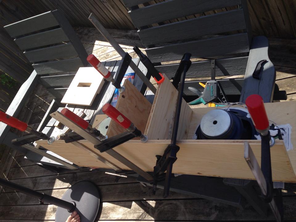

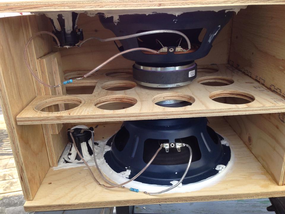

Hi, here is a update from my build.
As you can see on the last image I have this gap wich gives me sleepless nights... Saturnus you said that Chemical metal glue would be a good option but I dont really know how to get it there, its very tight...
This is how long Ive come with the electronics, Whats my next step? Am i supposed to solder the + and - poles on the tweeters together? Its hard to explain how I meen, maybe someone can explain my next step in a better way?
Many problems and many questions! Thankfull for all the help
Didn't you measure the pieces before and after cutting? Seems very strange that it can go this wrong.
Anyways. I think the best solution for you is, if you haven't yet glued both front panels on, is to get busy with the saw again and actually get the measurements correct. Filling that large a gap will only solve half the problem. The cabinet doesn't have the right dimensions as it is now so you can't expect optimum performance unless you cut the cabinet down to the size it's supposed to be.
You can probably shave off the needed 5mm or so all the way around without taking everything apart.
Did you use chemical metal between the center brace and the magnet on the other side of the brace that we can't see? If not, do it over. The magnets must be glued to the center brace with chemical metal (two-component body filler putty for the Americans). If that means having to cut new boards for some of the sides that can't be saved, so be it, consider it a learning experience. Plywood is cheap. A speaker that doesn't live up to expectations is worthless.
If you indeed have to cut new boards. Consider having it done professionally where you buy the plywood. Usually it's not much extra. SEK10 or so per cut. Somewhere in this thread is a precise and optimized cutting plan. Note that you'll only need to replace the pieces that can't be saved.

Damn... I think the measure problem is because I chosed to have the grills on the outside of the box and therefore the magnet gap. And I have allready glued both front and back panel on, and one of the magnets to the braces... What shall I do now?
The grill don't actually take up any space. They are not your problem.
Either your measurements are incorrect or you used force when mounting the drivers to the front/back baffles. The mounting gasket have a lot of give. Screw in lightly only to hold the speakers in place. It's the silicone and chemical metal that is supposed to hold the speaker in place. Not the screws.

I ended up with a bit of a gap like that (perhaps no quite so wide) and it was because I screwed my drivers down to the baffles too hard, they only need to be held in place while the sealant goes off. I did what you suggest and I filled it with a sliver of wood and chemical metal. However, as Saturnus says, if it is down to mis measurement, you really need to fix that because the precise dimensions of the box are cruicial to the speaker tuning.
