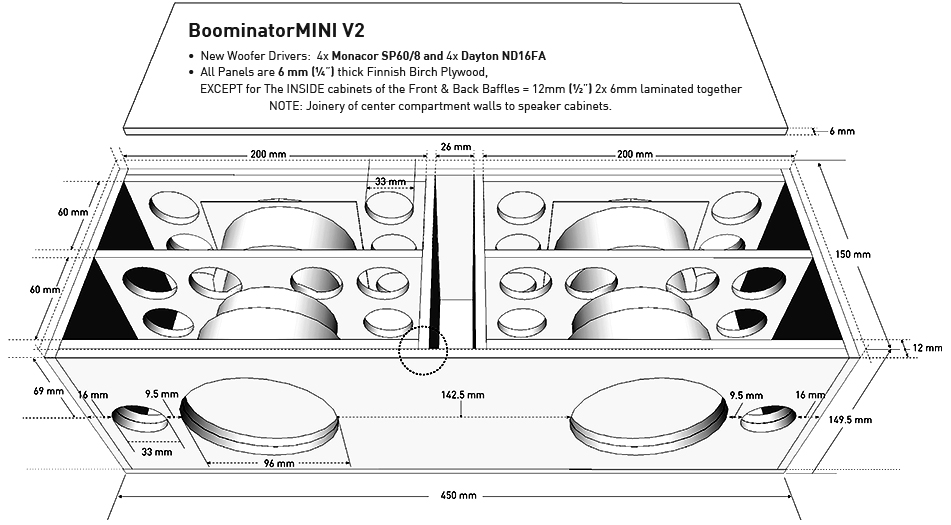

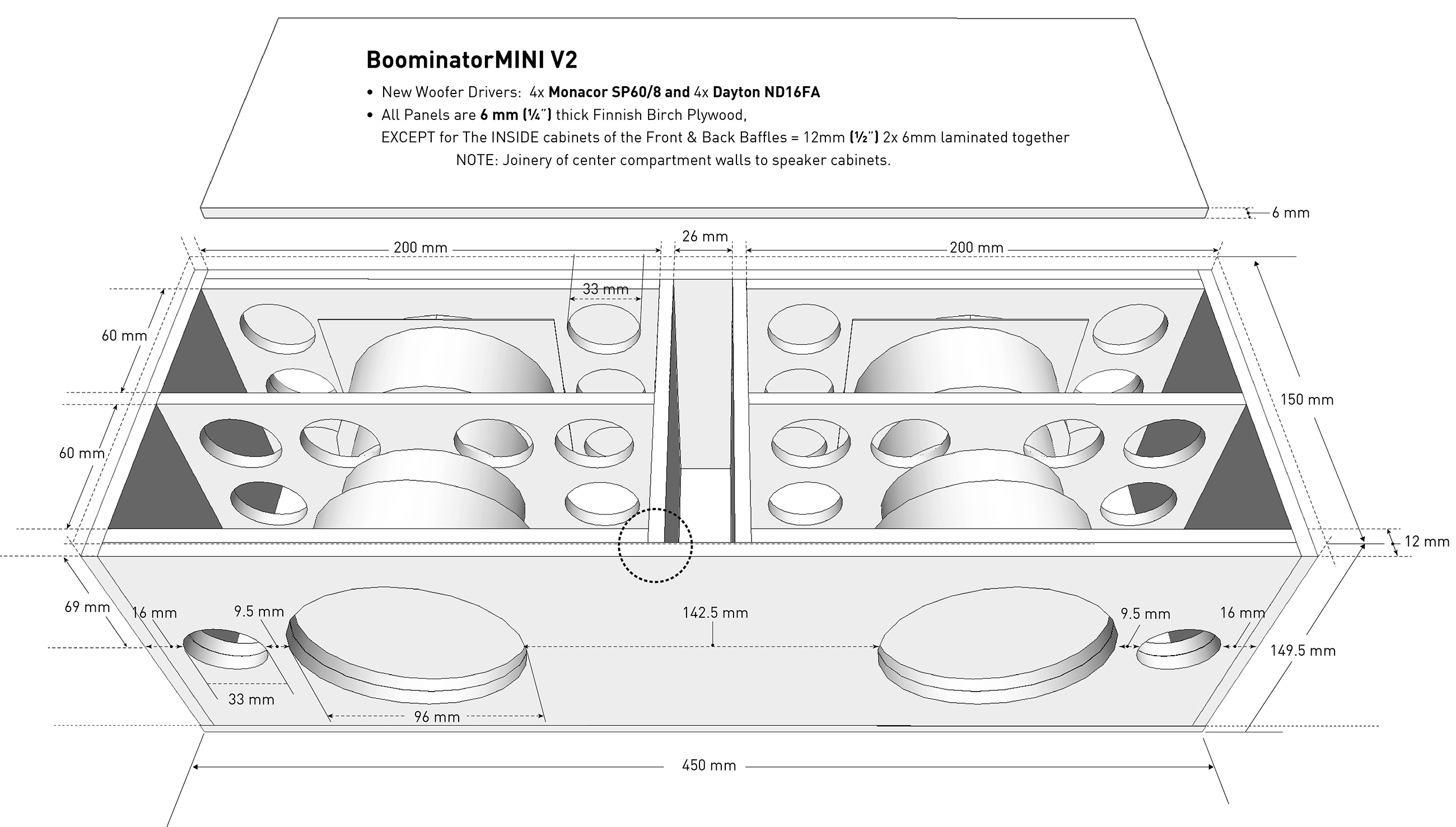

Just to clear things up. The above sketchup is for the MINI with 4x monacor sp60/8 and 4x dayton nd16fa. The MICRO is the same drawing. Just only take one side just like a halfinator. In that case you use 2x monacor sp60/4 and 2x dayton nd16fa. Filters are the same or different depending on how you chose to connect it but more details on that to follow.

I'm using the actual effective volume, 3.3L, when stuffing is considered. Also you might be calculating the volume of the drivers wrong due to them only being placeholders to show the outer dimension, not how much the drivers actually take up in volume. Also, have you considered the volume of the holes (it's 0.1L)?

I also did a quick dimensions diagram I thought I would share, while I anxiously await the details of the MINI's new filters.
View attachment Boominator MINI V2.pdf
