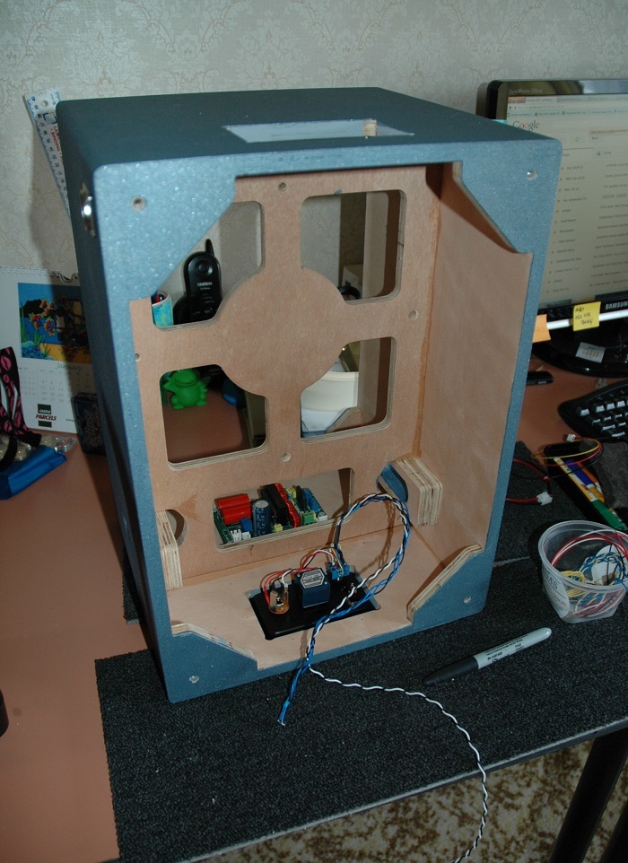

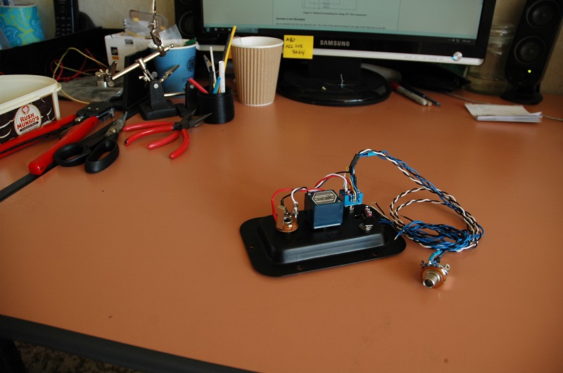

getting close to wring up my first halfnator. I have remixed the boominator by cutting it in two. Each half has two smaller ports (same overall area) and same internal volume as a stock boominator. The box was cnc cut and will have removable faceplates.
I am working on having a pair so that each can work as a mono box and when you link them with an interconnect cable they will run as a stereo set.
I hope to get the link working using a 12v fm transmitter as then we could have a party on wheels (I use them as our longboarding sound system.
I just read that the holes in the brace need to be that way to brake up the standing wave... BUGGER... I cut these like so as I was thinking airflow was good and the holes were a method used for simple saw/drill construction.... Should I just stuff with a little batting?
I have had real trouble getting decent tweeters so had to settle for these:
Surplustronics - Piezo Tweeter - 85mm x 85mm 100 Watts max.
they are ok, sound a little average to be honest....
Surplustronics - Piezo Horn Tweeter - 7 Inch x 3 Inch 150 Watts
These were a little better but still poo....
Could any one make a suggestion as to the best tweeter option from this store or a good online source that wont charge $100+ in shipping to new Zealand....
PS still looking for an amp 9 basic and amp 6 basic/sneaky build instructions so I can upgrade from the amps that will sub in for the time being.

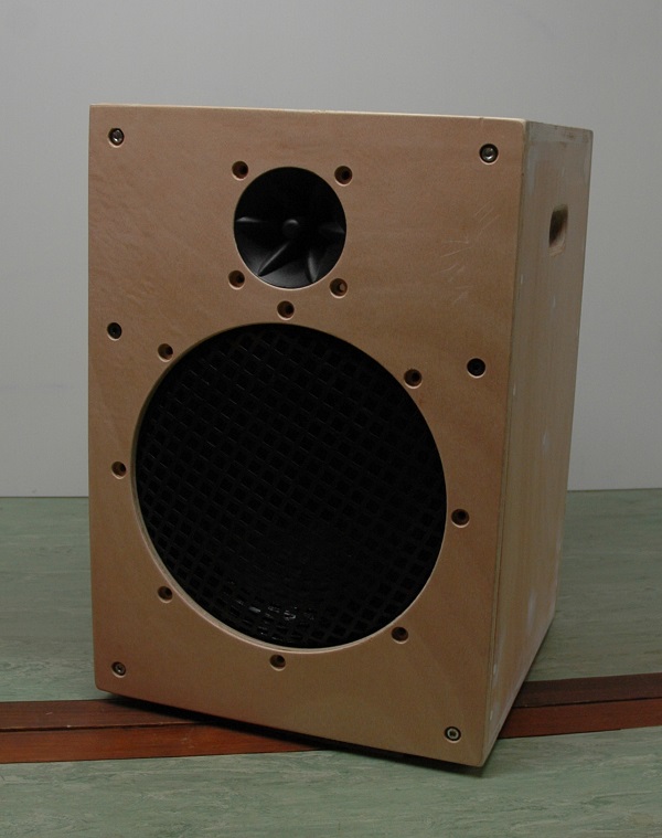

I am using p audio pht 406 hornloaded tweeter. What can i use to lower the volume on these tweeters? They're dominating the soundpicture.
You could try dampening the tweeter even more but it won't help that much really. It's not a driver that is suited for this purpose.

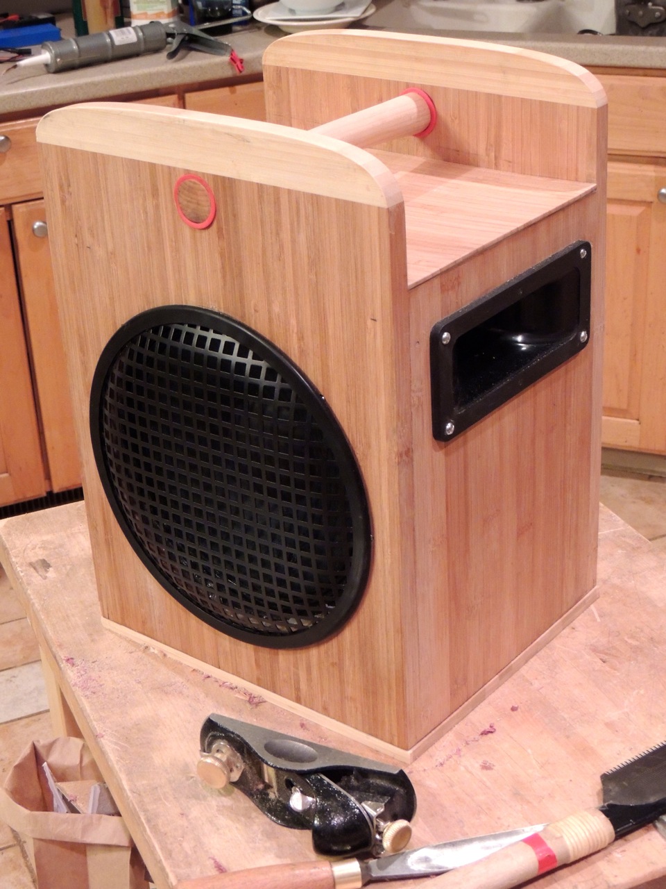

Breadboard busking amp
Not anywhere near Boominator league, of course, but we did put this together after reading through the thread and thought we should thank all of you, especially Saturnus, in the way we've been invited, namely, posting pics.
We needed something to play through at a rally. Had been using a Crate Limo, which gave up the ghost. Built this with parts to hand and very, very low budget, applying as many principles gleaned from this thread as possible.
Uses Eminence Alpha 10-A, no name piezos, Lepai 2020, no name karaoke board (which powers mic, gives echo option, acts as pre-amp and channels two inputs into a mono line output), lithium cctv battery and, of course, several bread boards.
I'm sure it doesn't sound anything like a Boominator, nor a Qubinator for that matter (from which the idea was cribbed), but it beats the hell out of a Crate Limo, or any other mass produced busking amp we've heard.
So, thanks!
So, thanks!
How does it sound?
Hard to say, depends on what the comparison is. We applied as many Boominator rules & lessons as possible given the limits of our budget & materials already on hand, ending up with something that sounds dramatically better (and is hugely cheaper) than commercial gear, but we certainly skewed way off of the very exacting Boominator thread recommendations, so seems safe to assume that the thing is but a pale rendering of what it would sound like done right.
That being said, it sounds great to us -- plenty loud enough, lots of bass, and the mix between mid/highs is satisfactory enough that we used the "direct" button on the Lepai, bypassing bass/treble and saving power there (also removed the two diodes which light up the volume).
We did the"2-plane" setup because we had these really cool looking bamboo breadboards and it was only way to fit the speakers. This thing does have pockets of deader sound as you walk around it (best angle is slightly off-kilter to a tweeter plane), but compared to the Crate Limo it replaces, which only projected forward, it has superb surround sound.
Still futzing around with getting the mic/guitar inputs installed (regretfully setting aside attempt to build in phantom power), so haven't stuffed & sealed it yet, so should end up that much better.
