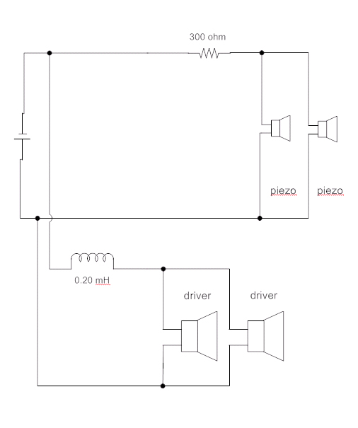

Most piezo horns have a sharp peak in the 2KHz range and then a deep dip in the 3-4KHz range before becoming more linear above about 5KHz. Generally it's that initial range peak that account for most of the bad qualities in a piezo horn, so generally they should just be used over 5KHz. Luckily that's an easy fix. Just add a series resistor. That will work a highpass filter in itself and at the same time make the piezo a reasonable load for the amp since a piezo is a capacative load the equation is exactly the same as for a normal 1st order highpass but instead of calculating the capacitor, you calculate the resistor value you need. R = 0.159 /(C*f) R = resistor value in Ohms C = piezo's capacitance in Farads f = desired x-over frequency in Hertz(a good starting point is 3.5KHz).
edit: found this from an another thread. Too bad that the manufacturer doesn't tell me the capacitance of my piezos.
I don't use a coil on woofers in the piezo version, and yes, you diagram is technically correct but I parallel the drivers directly on the amps outputs because that way you don't have to change anything if you go with an amp9basic which has 4 outputs instead.

But really, no coils after all? The first post that mentions the 0.22 mH must be from a previous version then?
I thought this was the way to install the speakers if using Amp6Basic, 2x8 ohms in parallel per channel to get to 4 ohm per channel. Or did you mean that you just plug everything straight to the output instead of "combining" wires like in my drawing?
I'm starting to feel quite stupid again...
Ok,
my speakers have arrived, it's time to do some installing.
My setup is very similar to boominator, 4xdrivers combined with 4xpiezos. Drivers are 8 ohm, so they will be put in parallel combination together with piezos as described in the picture in my previous post, but without any coils after all.
I have one question though, in my picture I've put 300 ohm resistor for the piezos. But from yet another re-reading of this thread, I believe that what I should do is exactly the opposite, to use 75 ohm resistor instead. I used 300 ohms because I thought that was the way to go when I wanted to have 150 ohm resistance per piezo tweeter.
Sooooo... which way is the correct way when using the setup in my picture?
Thank you for the answers.

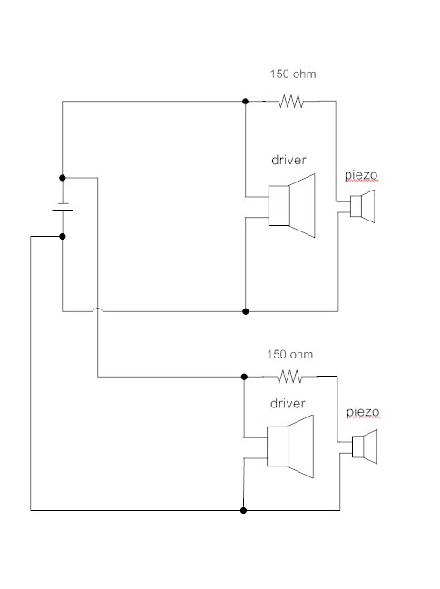

Wiring up 4x 4-ohm speakers for Boombox
Hopefully getting around to making the first version of my boombox this weekend.
I got given 4 x 40watt 4ohm 6.5" Clarion marine speakers.
The sensitivity is only 89db, but should be OK for round one until I plan ahead and get something a little bigger and more sensitive.
I got the thiele-small parameters from Clarion and according to WinISD I need a 23.5l enclosure for each pair of speakers.
I have two 12v, 7ah batteries that I will wire in parallel and a solar panel on it's way to help with the charging/battery life.
I am running a Lepai LP2020 Class T amp, rated for 4ohms.
I was wondering if someone could help with the best way of wiring the speakers for my 4ohm amp. If I wire them in series each cpair will be at 8ohms, if I wire them in parallel each will be 2ohms.
-Should I then wire a resistor in series/parallel with each pair of speakers to get closer to 4ohms?
-Or should I be fine either at 8ohms/2ohms?
-Or should I only use 2 speakers total as the gains from the extra speakers will be negligible?
Any help appreciated...
-Vinnie

Wow, 50 liters! That's gonna be a gigantic boombox. Can that be right, folks?
Anyway, there's no point in hooking up resistors to raise the resistance, because then you're just wasting power. I suggest hooking them up to the amp with no cabinets and try it as just one pair, then try with both sets in series (8 ohms), and see what you like better. It obviously won't sound like it will when they're in the cabinets, but you should be able to gauge the relative loudness.
And of course, if you're using this thing in situations where people will be listening from all sides, then that's one more reason to use both pairs.
One additional solution would be to add a second amp to power the second pair of speakers (you can add this later). You can have a switch which will allow you to turn them off when you don't need them or want to conserve battery life.
FYI, with my 6 watt solar panel, I can run a 2020 at mid-volume in full sunlight. It helps to have the solar panel separate so it can be positioned for best solar exposure, rather than stuck to the top of the box.
--Buckapound
--Buckapound
