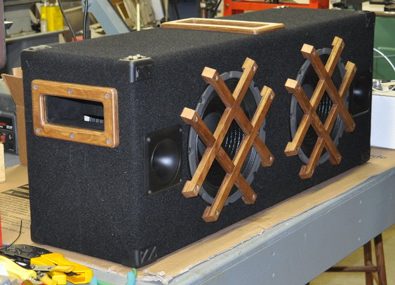

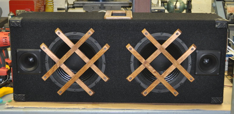

Well, I've not visited this thread much in the past two years but had started on a couple boominators back in 2009, finishing one of them at that time for a Christmas present. It's really cool that you started this thread Saturnus; there are lots of interested members out there! A couple weeks ago I thought it was about time I finished the 2nd one for myself.
I used Goldwood GW-1058 woofers as recommended substitutes for the originals Saturnus used, and am using some cheap copies of the 1165A (I think that's the number) Motorola piezo tweeters. I'm using 20 ohm resistors in series with each tweeter, then 8ohm resistors in parallel with the tweeter & 20 ohm. 8 ohm L-pads are used with this network; a 6.8uF cap is in series with the L-pad input to set the cut off at about 2900Hz.
I've been playing with both the 15w x 2 Sure amp board and their 100W X 2, running either one or two 9VA 12v batts respectively.

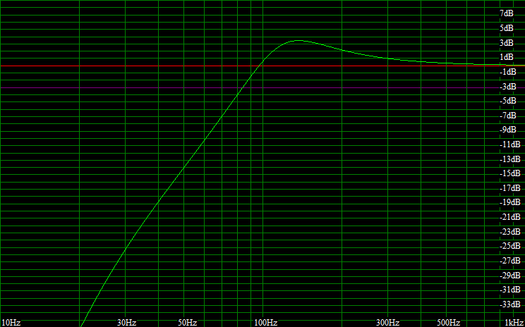

I'm no audiophile but am impressed thus far in the performance, cheap piezos and all. Using WinISD, tuning the enclosure for 70Hz, the response is predicted to be as attached. I'd like to check my work and measure the resonant frequency of box but am not sure how to go about that. I did try monitoring the voltage drop across a 10 ohm resistor in series with the speakers (with an o-scope having amplitude and frequency readout), looking for the point of least current flow. Doing this I found minimum current around 128Hz.....way off from the 70Hz I was aiming for. Is this method flawed? Maybe that technique is only valid for testing a speakers resonance in free air?

Somehow I wound up with a double post..oops! I"ll add that I mounted the woofers from the outside and am not taking advantage of the efficiency gain from butting the magnets together; I have about an inch between them. Do you think I'd gain a sound benefit by filling that 1" gap with something solid, like a hardwood, gluing the magnets to it to add more structure to the enclosure? The dimensions are not that much bigger than the speaker itself so I thought perhaps this wasn't necessary. I used 1/2" 9-ply birch plywood.
