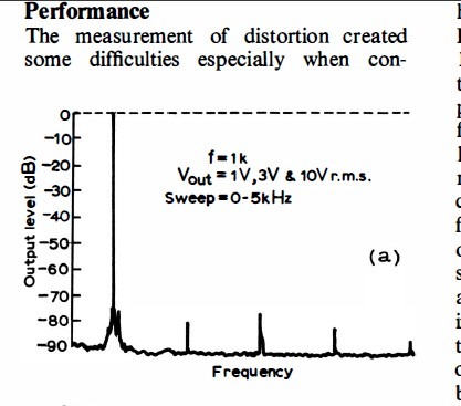

Mr. Blomley wrote in him paper: "The amplifier design is hopefully only a source of ideas which may encourage further research into the whole approach to design"

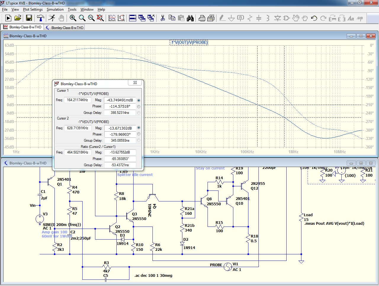

If my simulation is correct, we can state the following: the loop gain corner frequency is low, as expected from a single pole compensation, beyond that the gain drops relatively quickly. The UGF surprisingly low (164kHz), it would be much better at several 100kHz, say 800kHz or more. What if we use multipole compensation to achieve more or less constant loop gain in audio band? It will decrease the phase intermodulation distortion as well. Any opinion?

Yes, at least from my opinion you are on the right track. I added two pole compensation in the design of my TGM8 amplifier with good results. It works best with (requires) a compound VAS, so I’m not sure what you have shown here Is sufficient.Mr. Blomley wrote in him paper: "The amplifier design is hopefully only a source of ideas which may encourage further research into the whole approach to design"

There is the risk that this is a slippery slope to ongoing improvements in the technical performance, likely ending when the amplifier sounds and measures great but has lost much of it’s original character and becomes similar to many others. Nevertheless, until you go down this rabbit hole you will never know what this topology is capable of and the exciting part is you are possibly the pioneer doing this. You may end up with a topology that is similar to my TGM8 (which is my best sounding amp) in some regards but the differences may elevate it further?

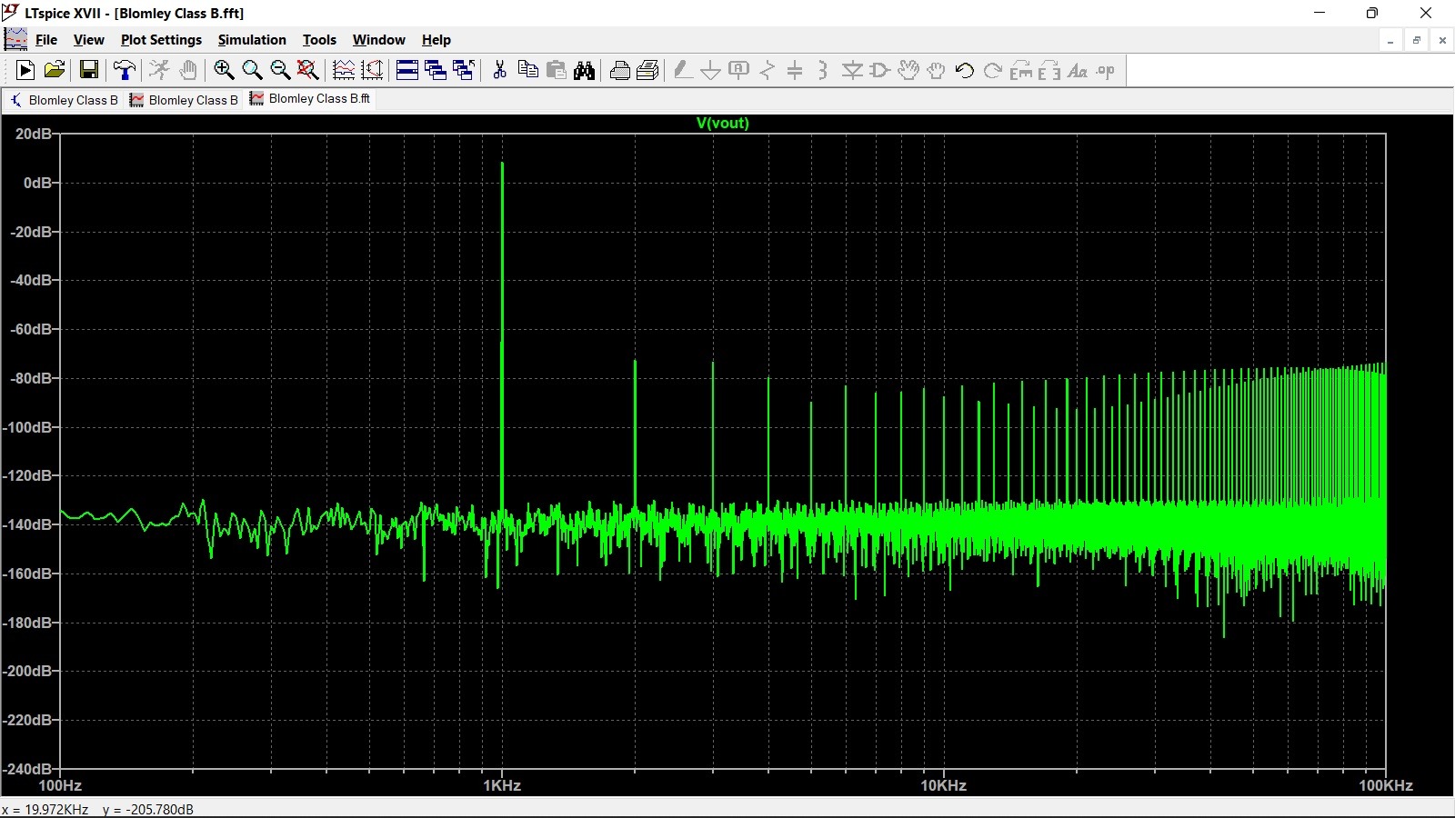

I tried hard to get the best sim out of blomley design using bc337/327/bd139 and mjl power trz.. but as far as i could do it i never saw a functional sim with 60mA idle current.Actually i can't get decent results below 1.2 Amp idle current .If the amp works as presented in real life, I find it impossible to sim with the original idle current using normal transistors so i concluded there must be something that either i don't get about it or the trz models i use can't replicate the original trz behavior.

I have the same experience. Its sound, however, is impeccable. Similar to VHEX+ amplifier. The LT Spice simulations show a grossly poor result, but based on the measurements and listening tests, it is still a very good amplifier.I tried hard to get the best sim out of blomley design using bc337/327/bd139 and mjl power trz.. but as far as i could do it i never saw a functional sim with 60mA idle current.Actually i can't get decent results below 1.2 Amp idle current .If the amp works as presented in real life, I find it impossible to sim with the original idle current using normal transistors so i concluded there must be something that either i don't get about it or the trz models i use can't replicate the original trz behavior.

Does it mean that we aren't really talking about a class B amp, but a full class A amp instead? 1.2 Amp idle current means bussiness...I have the same experience. Its sound, however, is impeccable. Similar to VHEX+ amplifier. The LT Spice simulations show a grossly poor result, but based on the measurements and listening tests, it is still a very good amplifier.
Looking at the schematic, I see that R11 biases the OPS to whatever idle current you like while the class-B operation happens before the OPS in Q4+Q5. The output is not class-B but the pre-driver is. So I have to wonder, if you are going to run the OPS class AB, there is no efficiency benefit nor any thermal advantage, so the whole idea seems a bit pointless.

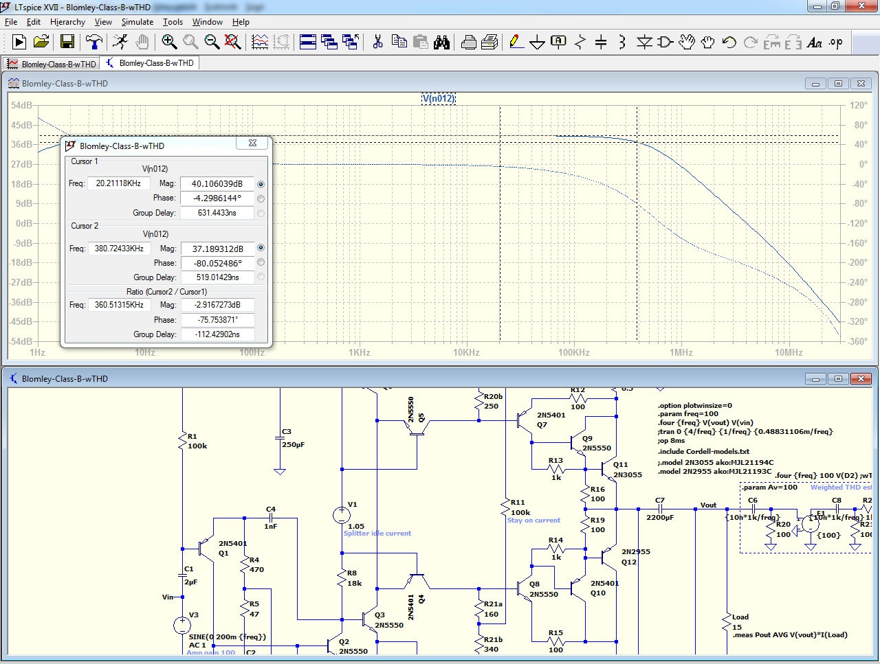

Changing all the resistor values to limit output stage current the min limit is arout 500mA...Unless your sim has a different schematic than the original one it is impossible to get below 500mA idle current measured across the 0.56 ohms resistor but even with 1.2 Amp idle current H2, H3...H7 can't go below -50db at 10v output on 16 ohms and -40 db on 8 ohm output.I thought the sim agreed quite well with the original article tbh. This is running at 24.5ma bias current and 2.83vrms out into 8 ohm.
I can't get anywhere near your results with the original schematic values.
I also tried the Hartsuiker variation which was only able to improve on the noise but nothing else.Even if you remove the bias resistors in series with the bias diodes entirely I can't get below 500mA...
Thank you! I found that the real culprits for the high idle currents were q7 and q8 .I used qbd139/140 ...any other small power transistor was better than that.Here is the sim. All default models apart from a 2N2955 in the output stage which I've attached a file for. Should click and run.
