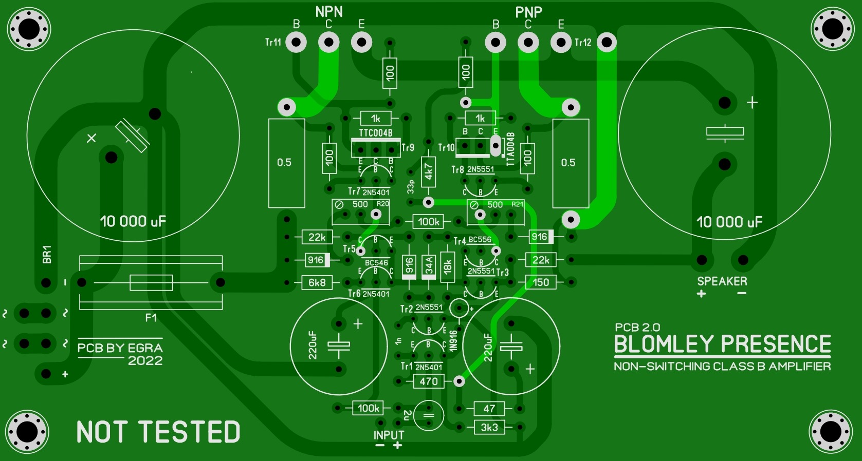

Here’s the new Blomley PCB, as I promised. This is not the final version, some refinements are needed yet. Not single-sided design, but the signal paths are much shorter and clearer in two-sided version. The numbering of the transistors is the same as can be seen in the original Blomley schematic. If anyone finds any errors please let me know. View attachment 1039074

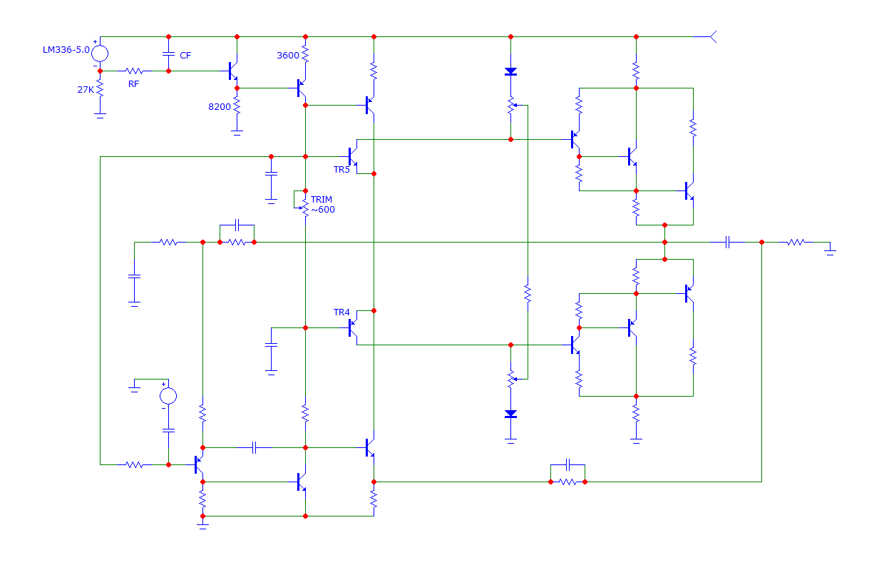

One possibility is replacing the 22K resistor with a CCS that is temperature stable and ditch the diodes, using a trimpot to get the desired voltage (~0.9V). Add an electrolytic to the base of TR4, to ground. The same that is already present at TR5.
This CCS is very stable with temperature when dissipation is equal in the NPN and PNP, which is the case with the values shown. The Vbe vs. temp of the NPN and PNP cancel out. I chose LM336-5.0 voltage reference because it has low tempco, 20ppm/degC according to TI.
The 3600 ohm resistor is chosen to give ~1.4mA current and can be trimmed to make the speaker output 30V (or mid supply). BTW the supply to the Blomley must be regulated IMO.
The trimpot is adjusted to ~600 ohms so you can use a 1K trimmer.
RF and CF form a filter for the voltage reference and it might be possible to eliminate turn on thump by choosing a large time constant. CF should connect to the positive, as shown.

I think it's worth considering that the end result you're after is stable phase splitting by TR4 and TR5. The voltage bias between their base junctions is part of the equation, but I assume the other part is the sum of the Vbe drops in TR4 and TR5. The key is the bias voltage that separates their base junctions relative to the voltage at their common emitters. At least I thought that was the way they work.
Yes, I understand, and you are correct of course. And to be honest I'm not familiar with the temp characteristics of the gold bonded germanium. So I just thought a good starting point is a stable bias voltage AND the possibility of adjusting it. There must be a point that is a good compromise over the required temp range.
I guess we can ask the question, what are the temp characteristics of that combo (1N916 + OA47) and how to replicate it with the CCS + trimmer.
I think you are on the right track with the CCS, it uses parts that are more common too. Can you arrange for the CCS to track the temperature of TR4 and TR5? Perhaps they just need to be physically pressed together like you would do with an LTP. I'm too lazy to figure it out right now but one of the CCS components will be the right choice to put in physical contact with TR4 and TR5 (if not then the bandgap reference could be replaced with a transistor wired as a diode etc.) and some tweaking afterwards - it's actually possible to simulate it all in LTSpice because you can specify the junction temperature of each transistor involved and set it as a parameter during the simulation. I used this method to design a proper bias control for the Naim amplifier. Sorry if it seems like I'm giving you work to do!
Bigun, I gave it some thought, tried some simulations, and this is the best I could come up with. Vbe tempco is aproximately -2mV/degC. At much lower currents such as the ones in the splitter the tempco can be as high as -2.6mV/degC, as Bob Pease explains in "what's all this vbe stuff anyhow", but that will not be important for us, it's just a reminder that there are assumptions with these rules of thumb. You would need a custom spice model to represent this. But as I said this is not important, we just need to aproximate the tempco to get consistent splitting over temperature. So we use -2mV/degC. Because we have two splitters, two Vbe drops, we need a bias voltage with -4mV/degC. With the trimmer set to aproximately 600 ohms, we need a CCS with -6.6uA/degC. I found that a common ring of two CCS has approximately half of that, according to Microcap. Not thermally coupled - just considering ambient temperature. So, this way we can probably get -2mV/degC for the splitter bias. I am satisfied with this compromise, I will build it like this, with a very well regulated supply.
OK, I just realized this: two schottkys + trimmer in conjunction with the temp stable CCS is a better approximation. I mean the CCS I posted previously with schematic. Schottkys have a tempco of -1 to -2mV/degC, but have a slightly lower Vdrop than needed, so we include a trimmer in series. Best to pick a Schottky with -2mV/degC.
You could consider a constant current diode - these come in various current values see for details and graphs https://nz.mouser.com/datasheet/2/362/P22-23-CRD-1729293.pdf Temp can be set with a high value resistor - possibly with an NTC thermistor.

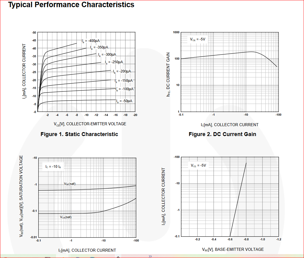

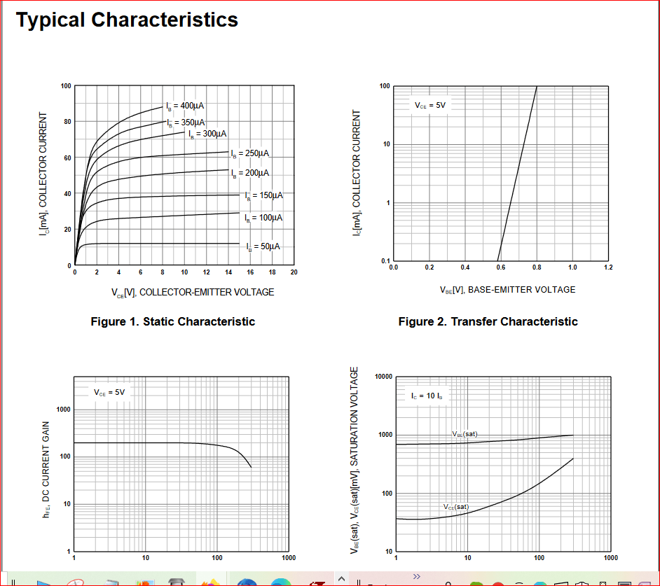

I used BC546B and BC556B as splitters. The typical characteristics of these are not identical the former is more linear in its' 50uA working range outside of the turn on area. The BC556B plot has a degree of slope

One of the main points of the circuit according to Linsley-Hood was to avoid temperature issues with the output stage. The problem of setting bias currents for the output stage is then removed to the splitters. I used BC546B and BC556B in simulations. These give acceptable but not stellar results at 1kHz with low output quiescent current. Unfortunately things fall apart at 20kHz. Linsley-Hood drew a simplified version of the circuit using an op.amp and in this made use of constant current sources in three places. I can post the circuit if anyone is interested.
