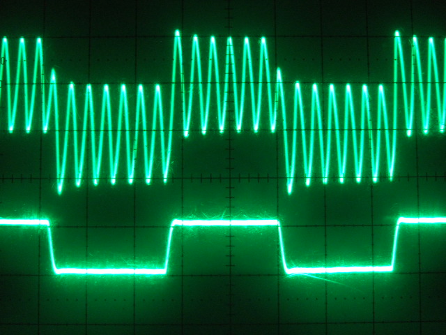

I've reported about issues using LT1028 where it oscillated when "dropped" in one of my amps. That was when using a single to dual SOIC to DIP adapter.
This time I tried LT1028 DIP version "dropped" in another amp completely stable with a nice square wave when using OPA827. This is how LT1028 looks with and without proper compensating caps. Andrea, guess which channel that's not properly compensated
So, LT1028 is NOT a drag-and-drop opamp. It has to be properly compensated.
How does it sound? Not neutral. No doubt it's brighter than neutral and slightly sibilant. Details and soundstage are good. More fun and alive than LM4562 but the latter is more neutral. Not as good as OPA827 or AD797. This is with no burn-in time, but I don't really believe in burning in parts other than for a few minutes.

What's the gain of your circuit?To mock a mocker:

That said, check page 13 of the LT1028 datasheet for unity-gain follower configurations that are stable. Inside my DAC, at least one of the conditions (source resistance) was satisfied... and I'm pretty sure it was stable.
I don't consider the LT1028 as being unbalanced in an apparent way, nor sibilant... maybe when not working correctly! Try it in a DAC output stage... possibly the ACN8.

5 or 6, I don't remember. Still it took some hefty compensation to tame it. BTW, the square wave shown is 1 V @ 100 kHz.What's the gain of your circuit?
In the DAC I'd also tried the LT1128ACN8, compensated for stable unity gain operation. It was very good too, but nevertheless I liked the LT1028ACN8 better...and it really didn't sound like it wasn't stable compared to the former.5 or 6, I don't remember. Still it took some hefty compensation to tame it. BTW, the square wave shown is 1 V @ 100 kHz.
