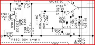

Hi Andrea... the upc4570C in your Pioneer looks a likely candidate for an upgrade, having looked at the data sheet.
Is that something you might consider ?
The feedback around that opamp is quite unusual in it's implementation, taking DC feedback via the 820k and AC feedback via the driver and output stages via R312 and R304. Also look how low R302 is.
You also have a mute transistor Q304 (like many CD players in it's implementation).
That may be used just for a "soft mute" when changing inputs etc as the main outputs (speakers) have a relay delay....

I can list some simple mods if you like... components to perhaps change... I'll leave it too you what you fit quality wise.
If you don't mind...thanks, so we'll see if you come up with something similar to what I already have in mind. However, I don't know when exactly I'll get around to doing it, since in this period I'm a little busy with study.
BTW... why not just make it into a power amp by isolating one of the RCA inputs & connecting them to one side of C301 (of course I'd replace the cap)? I could momentarily use my 24V CMOY as the preamp. Sure, that way the opamps in the signal path would become two.
Have a look at these, other channel in brackets.
Main PCB
C319 (C320) 10uf 50 volt...
C317 (C318) 10uf 50 volt...
C305 (C306) 10uf 50 volt... important quality wise
C301 (C302) 10uf 50 volt... important quality wise
IC301 opamp

Actually, if you look closely you'll notice that in the volume assy in "direct" mode the signal doesn't pass through any capacitors. The inputs/outputs are in the bottom connector in the schematic.
I did check this better because I saw that those two 10uF in the "volume assy" are not Nichicon Muse... and of course I knew from what I'd experienced that DC offset in the CD inputs could reach the volume pot freely.
So... there are only 4 10uF 50V Nichicon Muse FG in total, and they're located in the main pcb: C301/302 and C305/306. Besides, there are two larger Nichicon Muse's but these must be on the opamp's power supply lines.
Those 4 10uF caps are all that I'd bypass with Wima MKP's. In fact, directly in the signal (meaning not feedback signal) path there's only 1 electrolytic... and it hears.

Regarding the muting transistors... I wouldn't want to find myself with pops when changing source and such. Besides I'd tried this little tweak in an older Super Pro DAC and the difference was...none.
Soo... it comes down to changing opamp (probably I'd try LME49720HA/LME49725/OPA827), plus bypassing those 4 electrolytics, plus adding a couple of 100nF Wima's on the opamp's power supplies (just for peace of mind), plus maybe replacing that 220pF cap in the inputs of the opamp with Wima FKP2.
