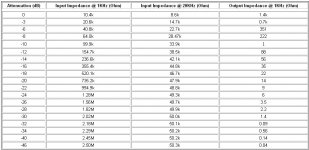

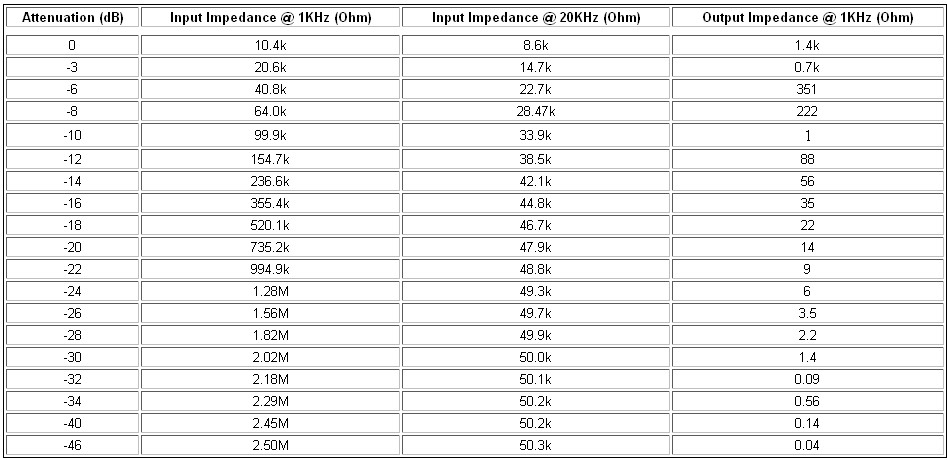

offering 6dB gain, high input impedance and low output impedance,
Its a transformer so the input impedance depends on the input of the next stage, and the output on the source impedance, and with 6db gain the input impedance drops to 1/4 the amp input impedance which might overload the source. (this is worst case, without the schematic its hard to say what the attenuater is doing). And with no buffering any noise on the output of the pre will get back to its input.

Ok, didnt know the attenuation was done by xformer taps. Still: "In the case of operation with 6dB of gain and with 10kOhm load on the output the worst-case load impedance on the source will be 2500 Ohm plus copper losses. This is a very severe loading and many items of consumer electronic will not be able to drive such a load adequately! "

2 more disadvantages:
The input to the TX-102 must be COMPLETELY free of DC offset; the presence of DC current materially degrades the performance of the TX-102 Transformer (and) The Source impedance in general should be as low as possible, the lower the impedance from which the TX-102 is operated the lower the distortion and the wider the effective bandwidth.

I don't were you got this information or heard it.
This is one of the Lightspeed Attenuator's hallmarks, an absolute lack of background noise, it has the blackest background you will (not) hear.
The Lightspeed Attenuator as I supply them has less measured noise than my top end Tektronics scope can measure, and that is 10uV, which is quieter than any pre I have measured.
This is why the power supply in my production Lightspeed Attenuator has first, a 12vdc regulated "linear" wall wart supply and then a 5vdc regulated internal supply.
Sure if some of the DIYer's start using smp supplies these are going to be nosier, as far as I'm concerned smp supplies have no place in this application, or any other high end audiophile product.

Can keep the impedance of entry fixed like a stepped ladder attenuator with resistors?
Shallco or other switches attenuators don't use DC in the signal path, so "zero" noise, & I am sure that a very good passive resistor added less noise than a LDR....

The guys I know that have these perfer the 1 to 1 gain setting over the 6db gain setting, and from what I've seen I can understand why, at the +6db setting they start to ring like a bell but at unity gain they behave themselves.
Cheers George
Everybody whom I know, including 6moons reviewer, preferred 6dB setting. My personal units are permanently set for 6dB gain.
