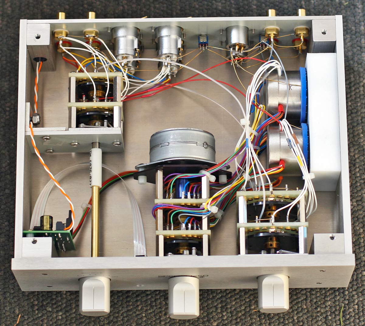

There is quite a bit variation in the MKI resonances and you must be empirical, plus you need a solid measurement setup.
First measure the frequency response at 0dB setting with your intended source and load impedance (include all parasitics you can account for).
Add small chokes or choke/resistor parallel combo's to the input and RC snubbers to the output (across transformer secondary) if needed, to attain a flat input impedance and a flat frequency response with a well controlled rolloff (uaully around 35K). Try to keep the capacitance values in the snubbers as low as possible and the resistor value as high as possible.
Then crosscheck the impulse response and if neccesary allow some peaking in the FR to get good steep slopes.
Depending on the exact pair of transformers you got and operating conditions you may find not a lot of need to correct the 0dB Attenuation FR/IR and may be able to correct using LR input circuits only.
Next switch to the range you normally use most.
Repeate the process above using a series RC circuit from the 0dB Tap to the wiper of the switch.
This snubber can be a bit more brutal, value-wise, but not too much, as you increase attenuation it will more and more load the transformer and source.
The optimum values for this vary sufficiently between units that if I gavce the values applied to the sample discussed they would likely be wrong for your application.

Well, strictly as a pure volume control there is little to choose, I am sure different devices from different manufacturers sound different and may be preferable to one or the other for a range of reasons.
What I find attractive with a true transformer as VC is that it can be employed in a wide range of "unorthodox" applications and that it can break earth/ground loops and so on.
An Autoformer simply can never do that and the performance gained with the unorthodox applications certainly convinces me.

Well, the comparison is not that simple. The TVC can actually work as stand alone preamp, offering 6dB gain, high input impedance and low output impedance, it can be wired for phase reversing and unbalanced to balanced (and opposite) conversion, all without any additional active circuitry.
Can your Lightspeed do all that?
Well said. And this isn't even the best quality of a TVC. With every signal there is power (watts), which is voltage times current. With a resistor type attenuator, the voltage drops, but the current does not proportionally increase, resulting in a loss of power. With a TVC, as the voltage drops, the current increases, maintaining the original power (less a small amount for the transformer windings).
ALSO, as the voltage drops, the impedance drops by a factor of squared. So, LOTS of punch and detail at low volumes.
