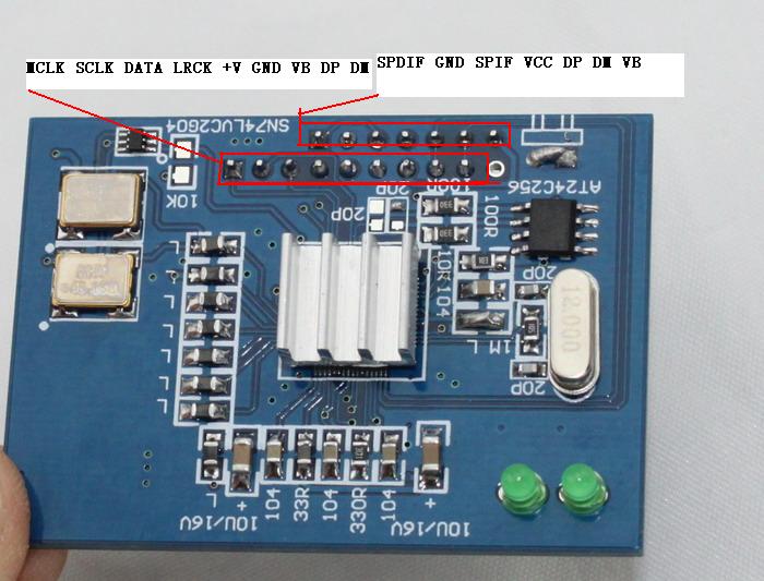

I have SA9227 USB card. SA9227 (32BIT 384K) daughter card supports 32BIT 384K-in Amplifier from Consumer Electronics on Aliexpress.com | Alibaba Group
see last 3 images
Does anyone know which pins to connect from card to get DSD. I do not have documentation and do not know where to get it.
see last 3 images
I have SA9227 USB card...
I can't see anything to suggest it has DSD capability?
It's DSD. First diode is DSD indicator. It lights when i play DSD. DSD playback http://hifimediy.com/download/SaviAudio-SA922x_DSD64 _DSD128_playback_on_foobar2000.pdf.
Datasheet http://download.esm-cn.com/ATTACHMENTS_201408_101635_20140829860_pdf/SA9227-v1.3a.pdf page 24 is solution to my problem. I think...
