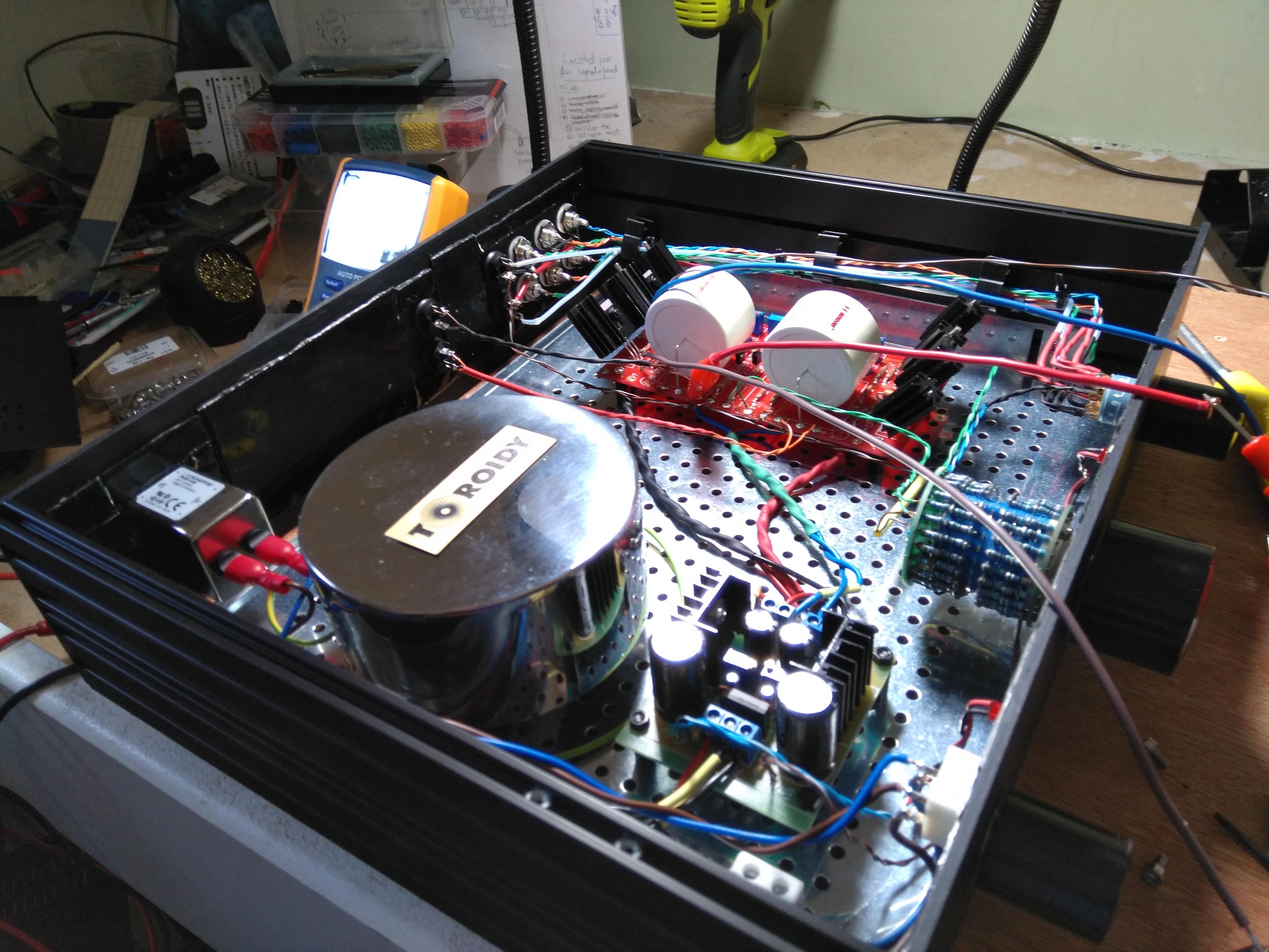

Looking good! Have tweaked P3 for harmonics?
No I haven't yet. I just set the pots in the middle for now. I want to get to know it first.
Cheers. I'll get another pic up.
Hey there all. Got my BA-3 up n running a week ago. It's making me smile. Seamlessly fits into my system with an 834 phono clone and Marantz cd player and F5.
It worked first time! Big thanks to all that helped me out. Including 6l6 and the mighty ZM.
BA-3 FE + F5 = bliss. Nice matchup.
What value do you have on the stepped ladder? Have you or anyone compared with stepped shunt vs ladder on low volume?Hey there all. Got my BA-3 up n running a week ago. It's making me smile. Seamlessly fits into my system ...
If it's any help, I run 10K ladder type stepped attenuators into BA3 pre feeding F6. (Source Marantz network player)
I found the big blue switches with Dale resistors sounded better than the smaller Dact type attenuators with surface mount resistors.
Not tried shunt type.

My first thought was that BA3 has an input impedance of 47k(?). So a low value of pot is better. Second thought is if the source sees example 10k even in low volume with ladder compared with a 10k shunt that have a bigger impedance on low volume, right?
So how do the sound differs with shunt vs ladder on low levels?
I’m struggling to understand the impedance so don’t take my questions as science.
Nice I been looking at that in 10k.
I searching for a good sound at the volume “husch, the children is sleeping”.
The difference between shunt and ladder is not big at all if I look at resistor values, if you have like me a dac with utput of 75ohm. So I paired BA3 with F4 instead of F6. Less gain with clearer image. Thats the beauty of this DIY, to mess around.
