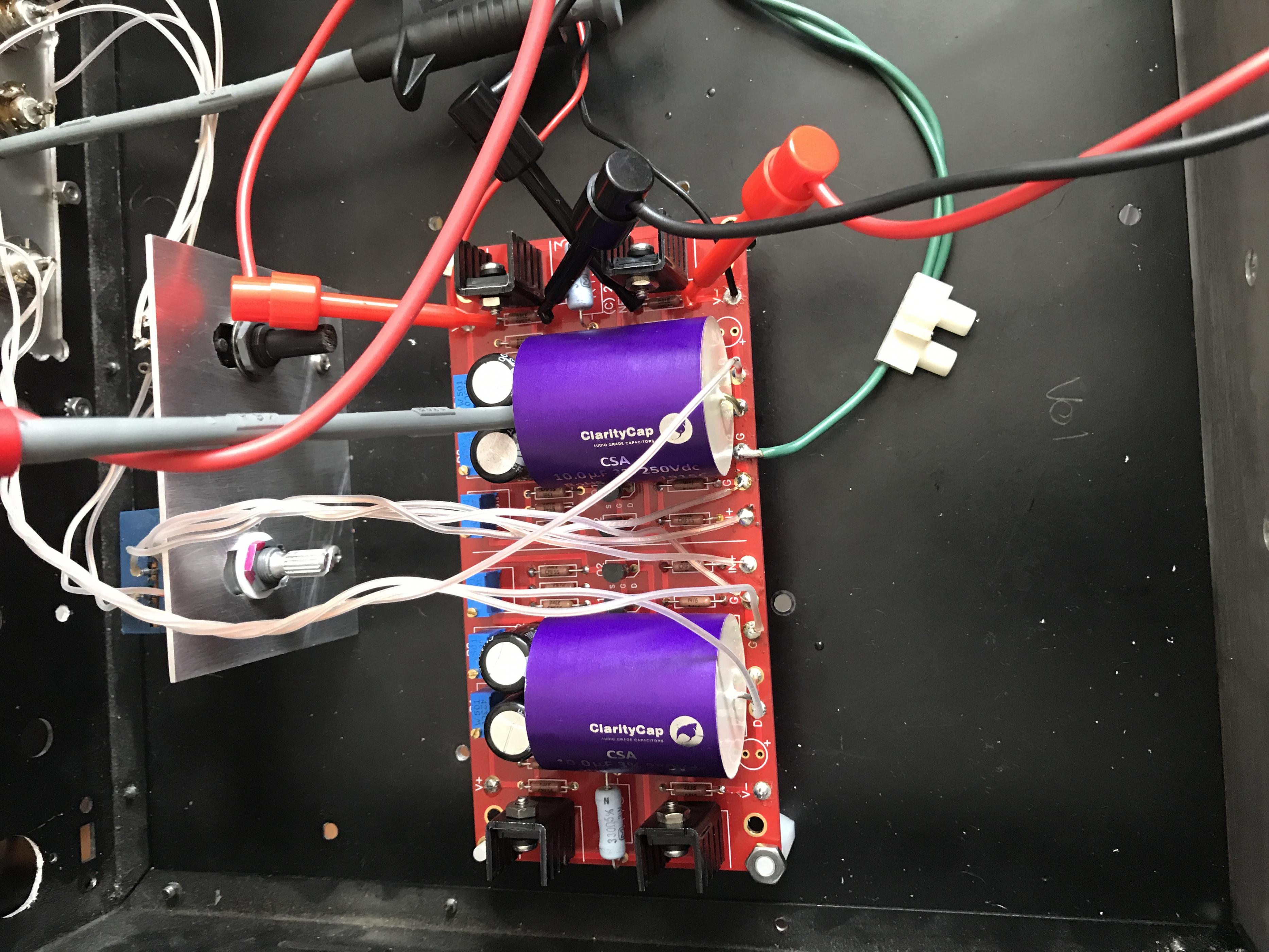

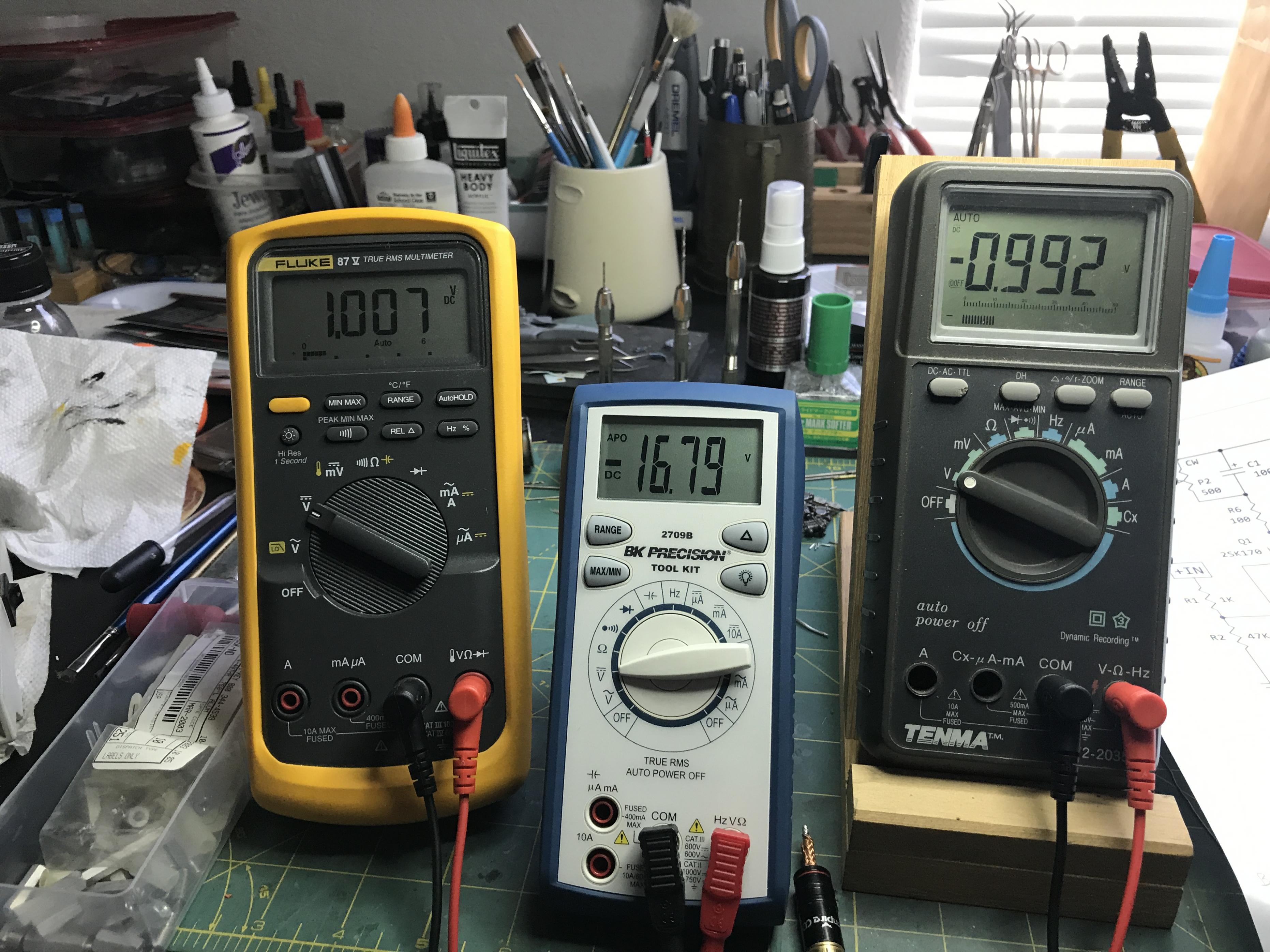

Ok after checking all connections it seemed I didn't have a good contact point on the negative rail I fixed that. I zeroed out P1&P2 and started over I attached two photos to show my hookup for biasing. P1&P2 do work now when I turn them I was able to get 1vdc across R10 & R11 but the DC offset is -17vdc not 0vdc not sure if I have something not hooked upright.

Sorry if I am not getting this. So this is where I am at with 1vdc across R10 the MOSFETs are warming up to 110F
Where is the meter connected for DC offset?
From the top of the cap, it's the same if I connect the probe to between R12 & R13 to ground When I adjust P1 up the DC offset goes down but when I bring P2 up the get the voltage across R11 DC offset goes right back up. Because when I bring P1 up the voltage goes up on R10 and the same for P2 voltage on R11 like there reversed Shouldn't P1 adjusting the negative voltage on R11 and the P2 positive voltage across R10

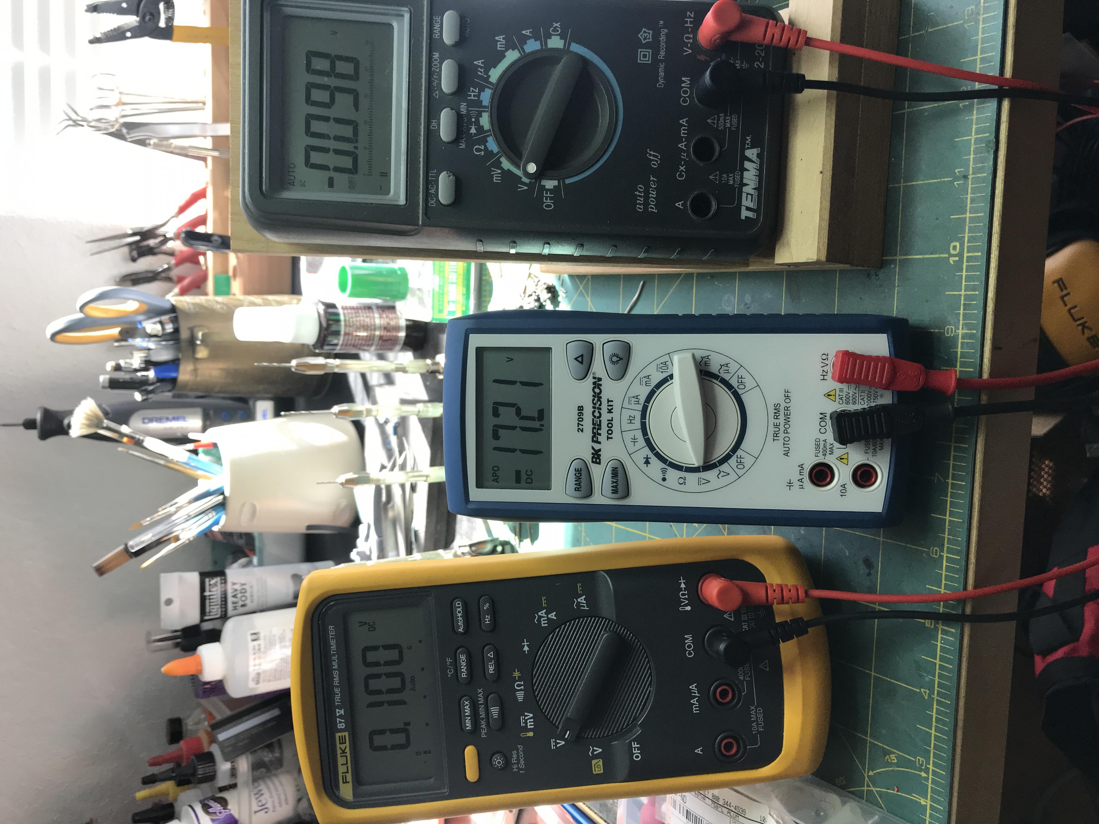

With P1&P2 zeroed DC offset -16.90vdcIf you go back to zero on P1 P2, do you show zero offset?
I could not get to zero P2 brings it right back into the negative and the R10 read 17ohm and R11 22ohmWhile your setting it back to zero, back off P1 first (-V on the meter), see if you can achieve 0V offset, note the voltage readings across R10 & R11. While the meters are hooked up, power off the BA3 and measure R10 & R11's resistance.
So as fo this time I have been working on the Right Channel So I moved to the Left Channel to see if I could bias it. I moved the probes over DC offset from the get-go was Zero as I dialed up P1 & P2 slowly they started to work in tandem with each other like described in post #2 and I was able to get zero offset with 1vdc across R10 & R11 see attached photo. I just need to figure out what's going on with the right channel
Well with further investigation 6L6 was a correct bad solder joint at the ground of the right channel RCA jack those Cardas jacks can be so difficult to get good contact. Once I corrected that at power up the DC offset was zero so I restarted to bias all over and am able to get 1vdc across R10 & R11 and the DC offset at zero. I will get some more photos when I get everything finished up I am excited to get some audio through it. Thanks for helping me out I am sure I have more questions.

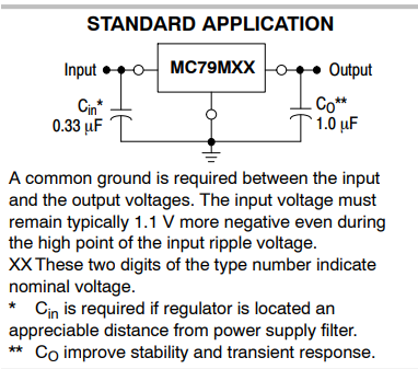

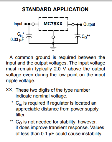

Anyone know the cap values I should use for the schematic using the regulators?
The datasheets linked in post #1732 include standard capacitor values, right on page 1. I've screengrabbed the relevant portions below.
