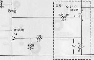

In Aleph design, R15, R16 and Q4 form a sort of clipper to protect the active side's hexfets by setting the maximum value of the current in ea. hexfet.
What to look for when adjusting the values of those resistors (R15, R16) for different source resistors values and bias?

Ref Q4, R15, R16, you simply set the values up so
that you don't blow up the negative output stage, so
I set them fairly high, and it takes a short to ground
to trigger it. In the Aleph X, you don't need them at
all if you can be certain of not shorting to ground, as the
positive current sources will set a limit for you.
