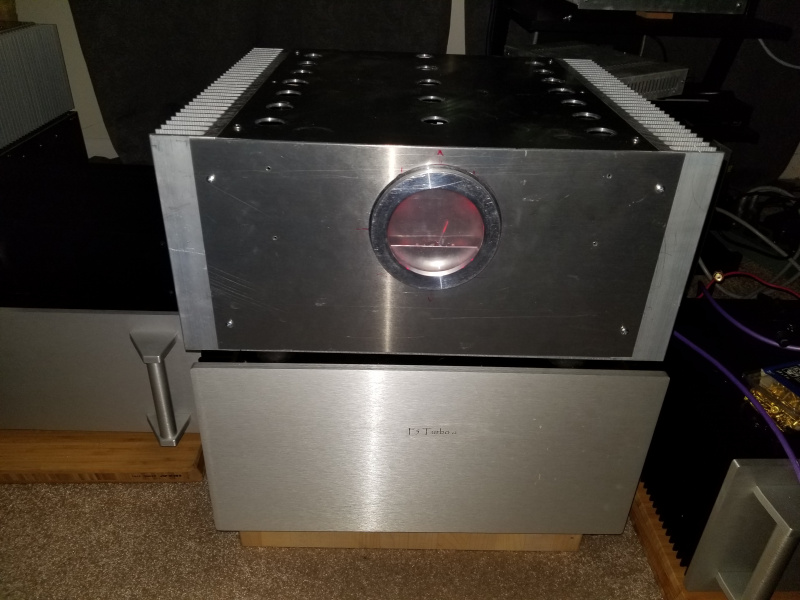

With this board the output mosfets need to be mounted off the board, creating a bit of a nest of wires. Going to try to zip tie some wire where I can. I missed the bit about Q6 mounting on heat sink.
I didn't match the output mosfets. Just used irfp044 shipped in a tube of 25 count. Still managed to get 16mV and 20mV offset. I can barely hear anything with ear in the speaker.
I was worried the heat sinks wouldn't be large enough but they are. Used. 33 for R5 and R40 and their counterparts. It's set to .525v bias for now, still less bias than when using .22 source resistors.

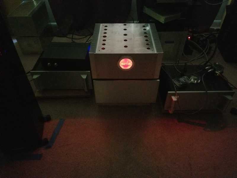

I'm planning a meter for the front panel. We'll see if I can pull it off. Once I soak in the sound of this one, I'll try to find literature for making upgrades to it. I know they're out there.

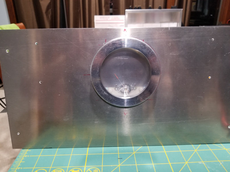

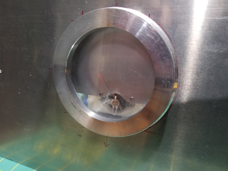

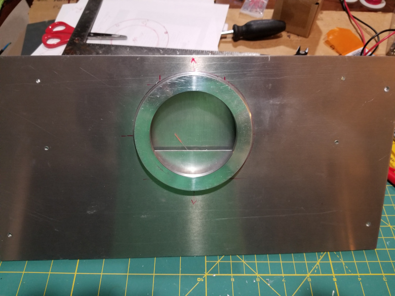

Here's the meter. Needs more work. Adding a longer needle when it comes in. It does work. Want to install a switch to check bias on both channels.
It there a simple way to protect a 1V meter?
Maybe a fuse or diode solution?

What kind of protection for the meter do you have in mind? If this is a 1v movement (full scale deflection), I don't see that you need to use a diode or fuse for protection. If you wire the meter across the source resistors, you should be at just about half of full scale deflection. If the meter is more sensitive (full scale deflection with much less than one volt), you can probably get away with a dropping resistor. A typical DPDT switch should do it for going back and forth between channels.

For your meter scale, you can use some "water slide" decals that can be printed on your printer. Water Slide decals are clear and come as specific to ink jet or laser printers. Paint the background of your meter whatever color (white, metallic, etc) and put a water slide decal on top, then finish it off with a few coats of clear paint and it will look great.
Joined 2000
Yes, I've had them for years.
There is also a type that water peel the decal, then they are baked on. Does not show any film, just lettering.
The easiest way is to reverse print to paper with monochrome laser printer, then rub on to surface with acetone, then clear-coat.

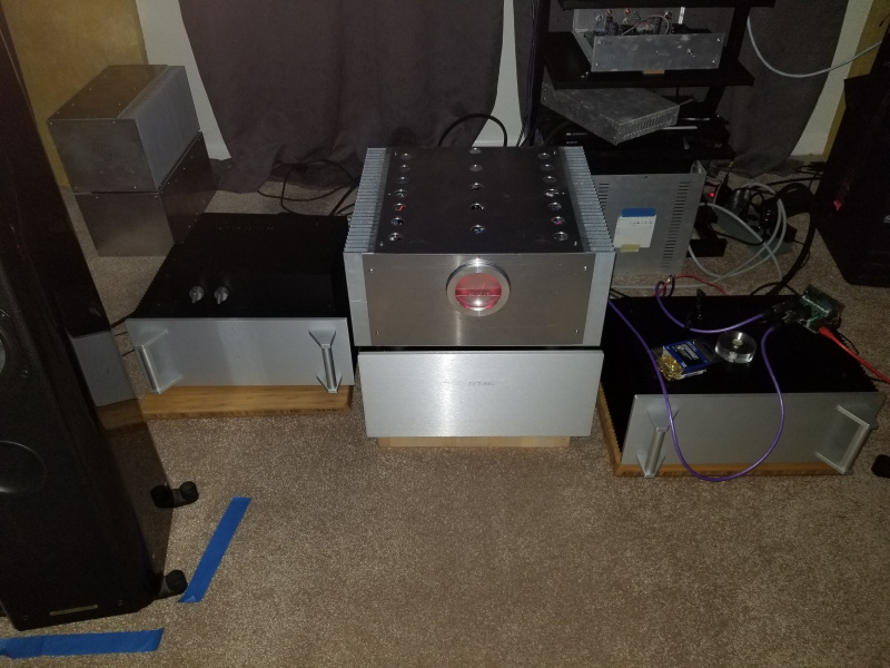

Nicely done Vince! I dig the double decker power supplies!
Thanks. The chassis below is a F5 Turbo v2, 50W version. It will go up for sale if anyone wants it. 5U case and dual mono build.
