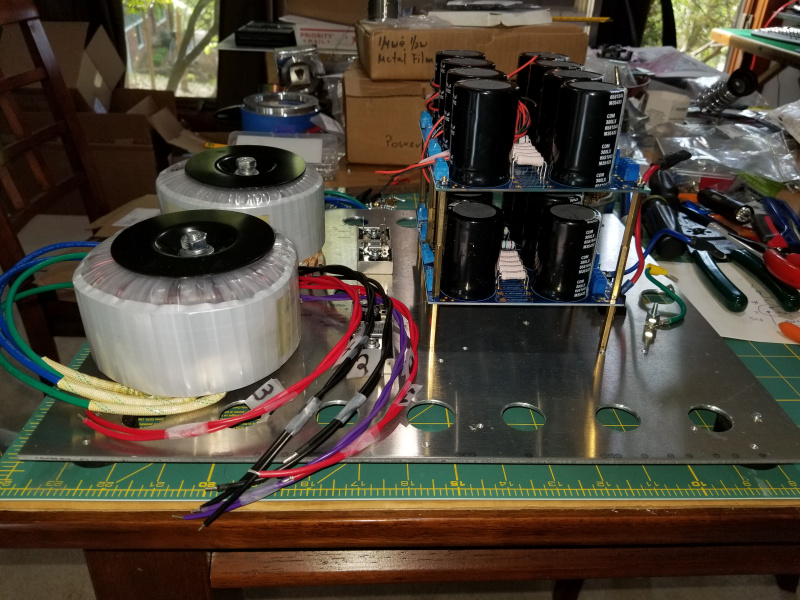

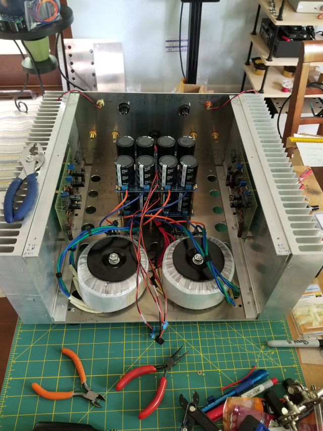

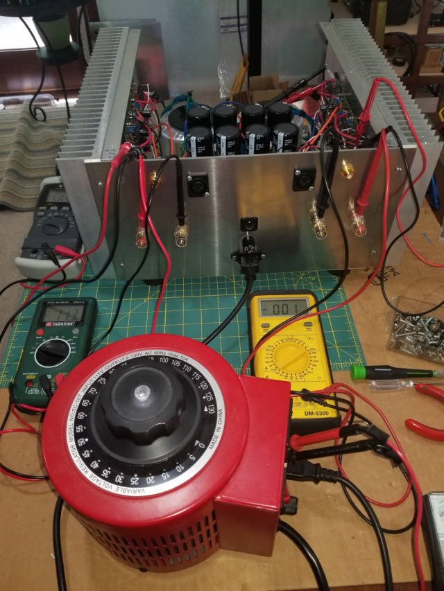

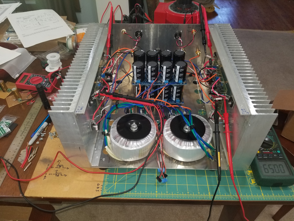

16 Years gone...
Over 16 years ago the group buy for the Aleph-X boards went down. Just finished the amp today!
I sold the boards partially populated several years ago.
Blank boards that I put up for sale no one wanted them.
Being lazy, I contacted the buyer of the populated boards and bought them back recently. It was a good move.
After setting bias and offset for a few hours, playing through some drivers to hear music, pulled it off the bench to place in the main system. Results are impressive.
Thanks to everyone's inspiration to finally motivate me to build it, thanks to Eric for the reference material all available in one place. Grey, if you're out there, thanks for the education. To Mr Pass thanks for letting it happen in the first place.
How many amplifiers can you listen to and hear something new in the music? The answer is always, "One more".
Thanks,
Vince
