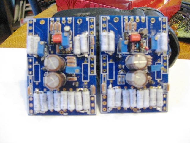

Isnt there supposed to be 2:1 ratio of feedback power resistors to fet source resistors.
Source resistors are 2x .47 ohms
Feedback resistors are 1x .47
Sorry the picture isn't the most clear

Some measurement:
PSU +-22V
Time of power up 30min
Offset 0V at 30min, cold I think about 15mV
R8= 8,9V (fixed 830ohm)
across 500ohm pot 1,8V
Voltage across 0,47 3W resistors about 500mV (+- 10mV)
The numbers look good?

Offset problem!
I have offset problems: (
Yesterday In my desk the variation was only 30mV, but in the chassis is too high!.
Some measurement with input shorted and resistor load:
0min 300mv cold
3min 30
5min 5
15min -65
20min -80
30min -100
40min -138
45min -142 stable
Both channel with similar problem..
Any Idea?
Sorry if is a silly question but this is my first Solid State project..

Did you try to trim the offset after it heated up?
What are your case temperatures. The change is most likely due to thermal drift casuing change in bias point as the fets and sinks get hot.
I was thinking about this project the other night, contemplating what might be wrong with mine, and a thought actually appeared. I know, shocking. i am not syaing it a good one, but here it goes. I think the Jango is a bad idea. While you can get the offset and Dc conditions set and stable, the AC conditions are going to be non ideal. If the SS was loaded with a simple CCS, like the F2, i would expect an improvement in performance equal to the improvement of the SS fet vs standard mosfet. With the ACS, we have something completely different. You have an active current source that is basically trying to track/follow the output of the lower fet and contribute equally, or as close as determined by ACS setting, as possible. If you had two identical fets, like in the original, I would expect excellent results, as both fets are matched and respond to the same signal in similar ways. With the Jango, you have very different fets, with different operational parameters when fed the same AC signal. While I am sure the top fet can do the job and the amp can sound nice, it seems limited from the beginning, simply because the fets will respond differently due to fact that they are different. I can see cohesive effort with similar fets, but a sort of battle, with dissimilar fets.
