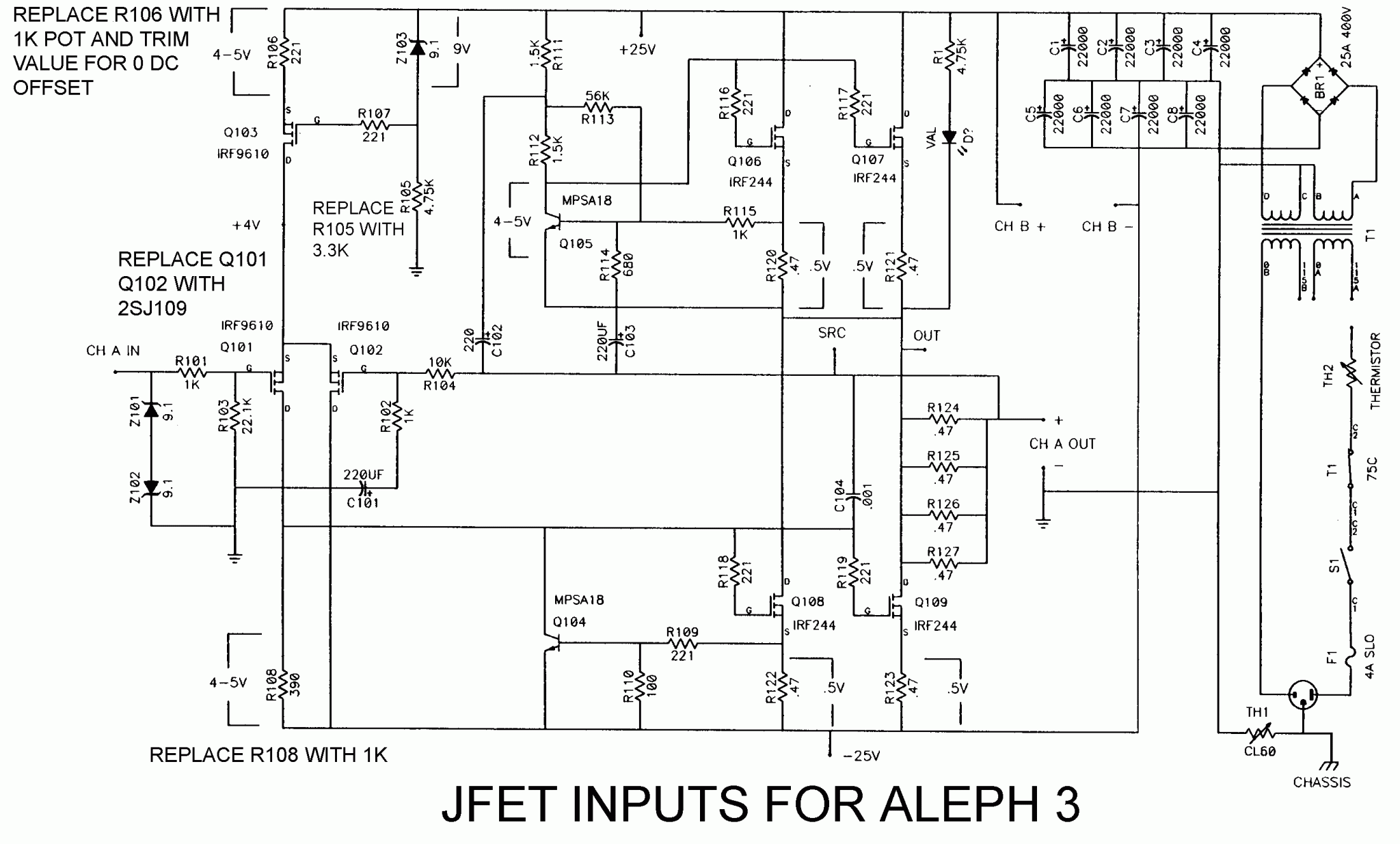

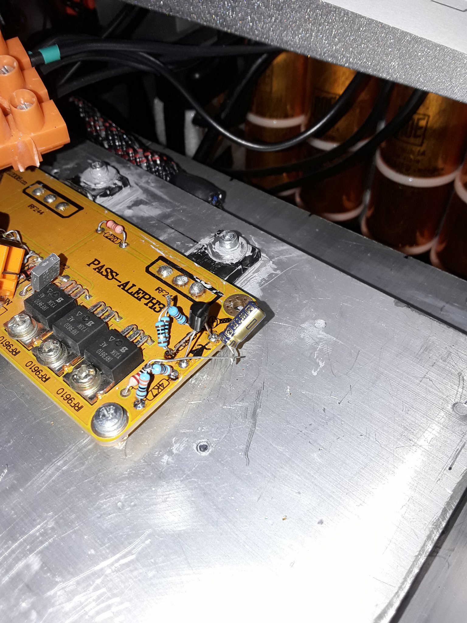

that's change around Q3 (which is IRF9610), on sch. you posted
zener out ...... you see the rest
do not obsess with sound ....... no change in sound ........ noise will be decreased

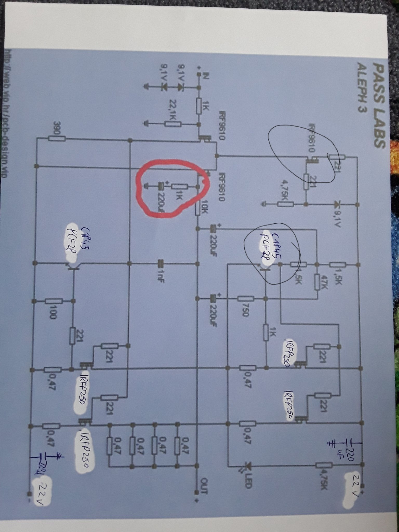

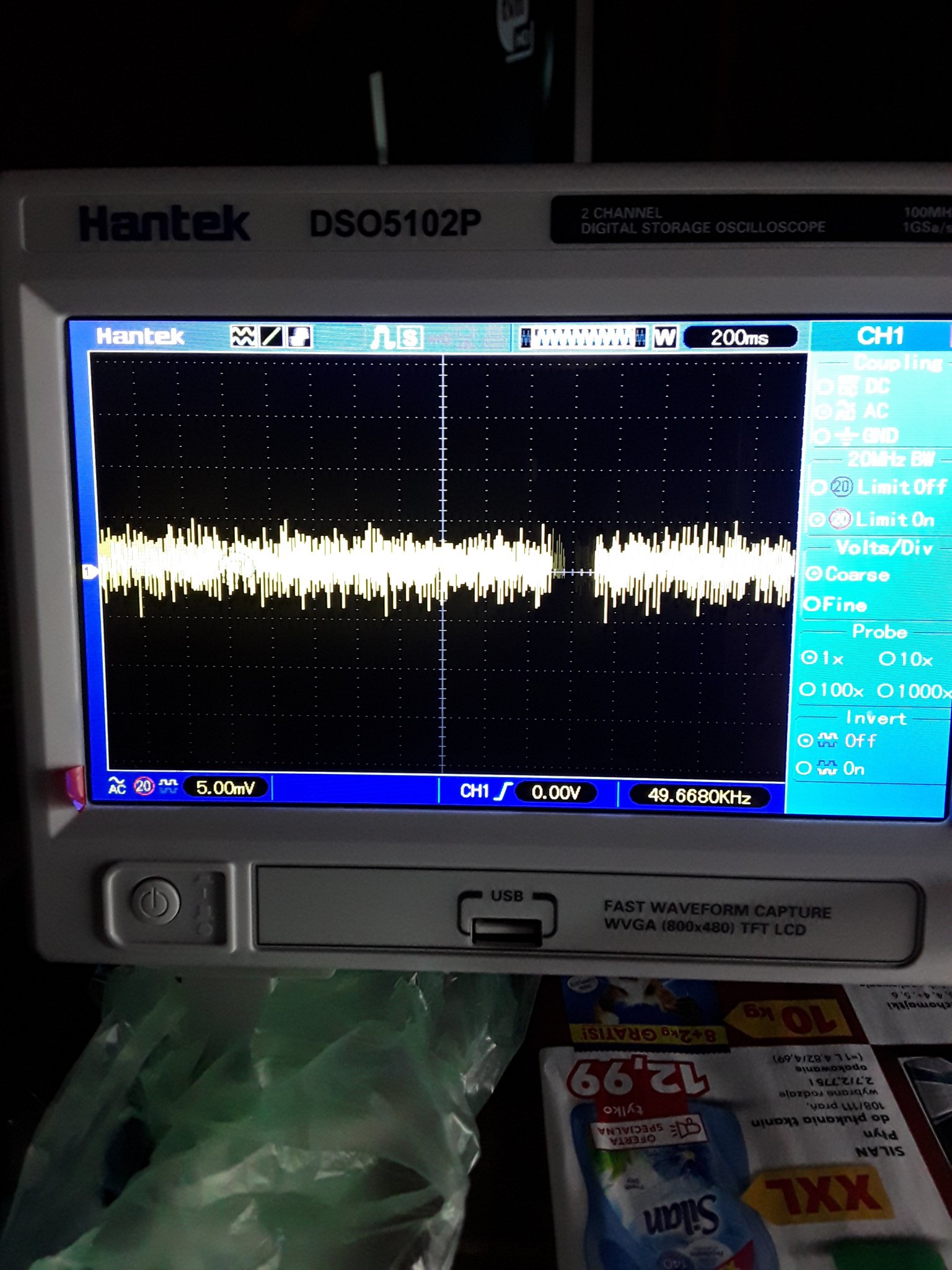

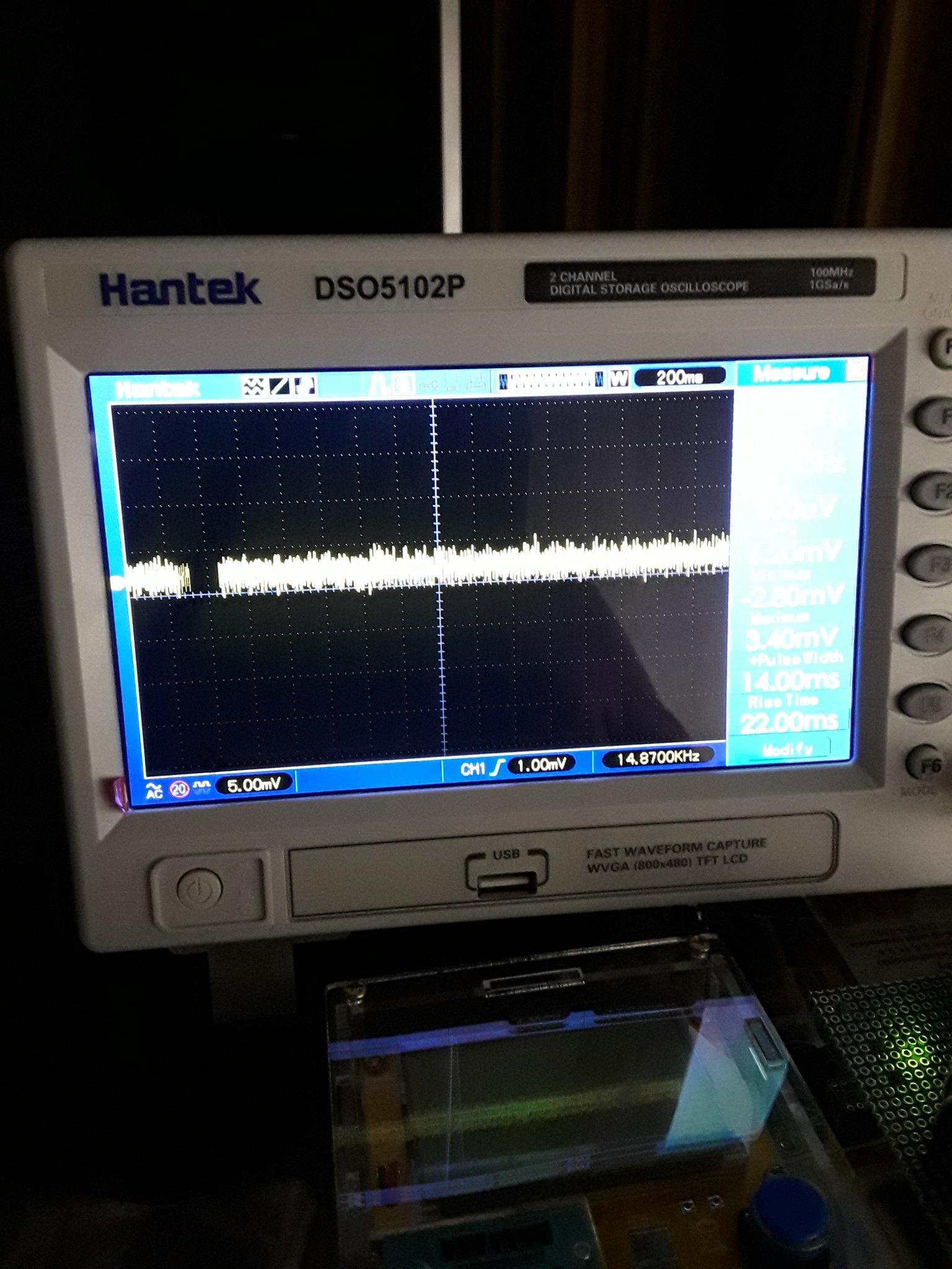

Hello i have done ccs on bc560 and i have litle better than zener with 10uf cap. On my 97db speaker from 2 metres is quiet. It is pasible to do somethink else? You mentionen that i must twist cables from power supply to aleph pcb? What about 220uf caps near mpsa18? I have seen schematic with 470uf. And what about change 9610 on jfet? or irfp250n change to irfp244? pictures show noise with just a zenner with no cap, and a ccs.Very thanks
redo the other channel with CCS I sketched and be happy with that
after that - try to find set of proper pcbs and make iteration with JFets on input (JFets available here in Store)
pcbs you have are most likely having some routing or even schmtc problem, in short - they're unreliable ( besides being sold as IP theft, unauthorized)
if you find pcbs on DIyaudio, you'll have confirmed and tested package, and no problems like you have with existing ones
and - it will sound better

if you post schematic and write "these are values I actually have on pcb" then I can answer
for now, I can only guess - you have Pirated pcbs, and you posted partial schematic which Algar_Emi posted, as help for Aleph builders , many years ago
Lots off elements are same like on schematic i added. I will disolder some resistors and measire it. Please tell me with resistor(on this schematic) is adjusting gain? 750ohms? For now you help me much. But still dont have answers it is good idea do chage 9610 on jfets? Or change irfp250n on irfp244? Sory for hard work with me
gain is set to 10x
ratio of 10K (near red circle) and 1K (in red circle)
if you want lesser gain , decrease value of said 10K
if you read this tread from start, you'll have some clues and recipes how to make it better
no need to change output mosfets
in general, with JFet input (instead of TO220 mosfets) you'll get more detailed and more pleasant sound
look for Aleph J pcbs in Store and for P channel JFets (either original Toshiba or Linear Systems)
