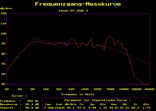

so You have 24 dB/1500 Hz and 10'' woofer?
Can You measure any output of such a system at 7 kHz at the listening position?
The 10" driver in the test was very cheap but surprisingly good.
Rockwood / Senon DY 1026 U
It is wide band. Response goes beyond 10kHz. Surely there is high freqs leaking with 4th order low pass at 1.5kHz.
HIGH-TECH-HIFI
I found this measurement of the driver.
- Elias
HIGH-TECH-HIFI
- Elias
I see so it is a wideband and it has a whizzer.
Sure there is a leaking but can it be audible in practice?
The theoretical filter attenuation at 7 kHz is already >50 dB and going down fast
