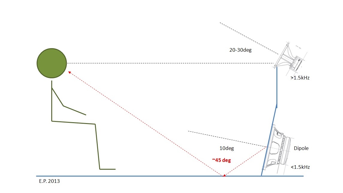

This is what I did last night.
10" PA element in a small dipole close to floor slightly tilted upwards. 18sound XD125 horn at ear height tilted upwards about 20-30 degrees. Cross over 4th order LR at 1.5 kHz.
It sounds very promising ! When the tweeter is tilted upwards it gets harder to be localised as a sound source. Looks like the old wisdom of ceiling firing can be applied here too.
Good rule of thumb here: If you can see the diaphgram through the horn at the listening position, you have too much of direct sound.
Only had one of these so cannot say yet about the stereo performance.

Elias, I assume you have no ceiling acoustic treatment?
Ceiling is painted concrete, no treatments. So it reflects sound almost 100%.
10" PA element in a small dipole close to floor slightly tilted upwards. ... Cross over 4th order LR at 1.5 kHz.
is the directivity of the 10'' high enough to prevent the influence of the floor reflection in such a relatively upright position?
