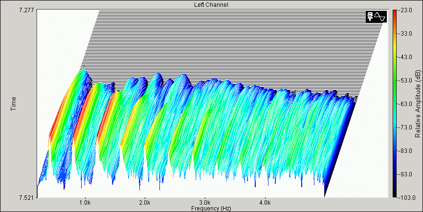

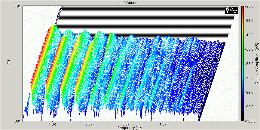

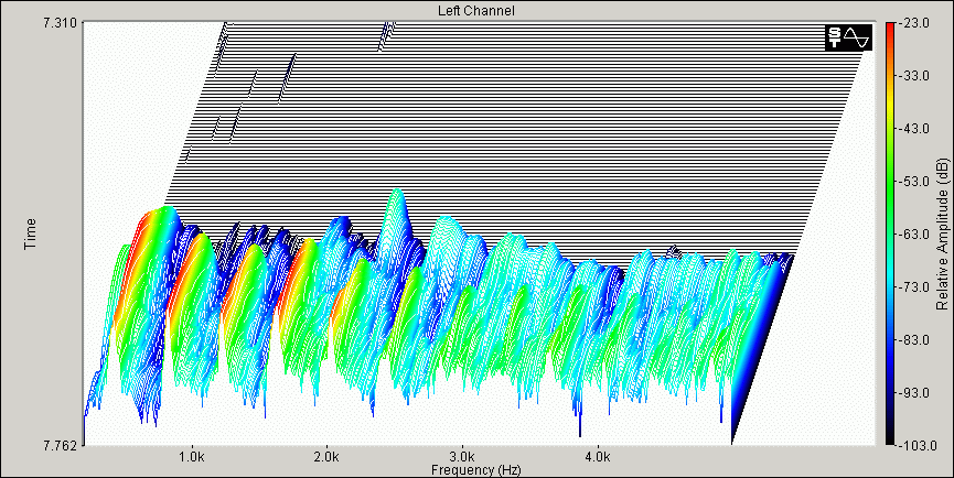

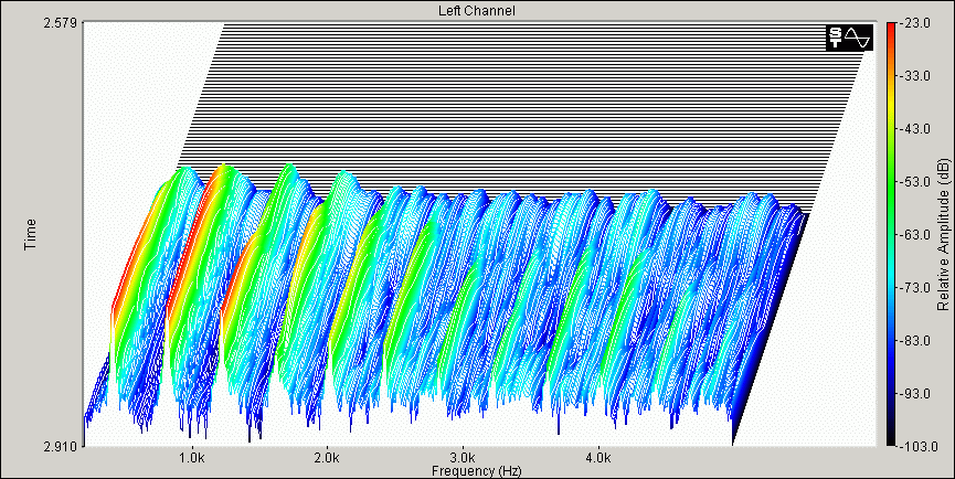

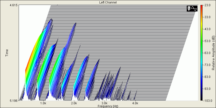

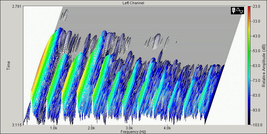

Then please try to explain how precededence effect may apply to a violin sound at all:
- transients (in the beginning of the violin's sound) are different due to direction
- resonances (modes also to be described in frequency domain) radiate selectvely towards different directions
- the envelope is different due to frequency band and direction
I do not feel you are considering my points at all ...
graaf said:
What is individual and as such identifiable seem to depend entirely on time domain factors.
What you mean is e.g. "short term spectrum changing with time", which is not "time domain".
Nearly all the properties you describe need - short term - frequency domain analysis as a prerequisite.
I don't know. The diagram doesn't show the shape of the pressure build-up of the initial transient.
Perhaps ear-brain takes many information samples and resolves it somehow. Or perhaps it doesn't because it can't?
Question is are we really able to locate the violin in the presence of strong reflections without visual cues? Was this experimentally tested?
Or perhaps - as the diagram shows that a violin is rather directional source - reflections are typically too low in level to affect DOA estimation?
Believe me I am doing my best. But I am not as technical person as You. For me this talk is an opportunity to learn. I am not trying to prove anything.
But to have "a spectrum" and a "spectral analysis" we need to have a periodicity first?
Where is this periodicity in the transient attack curve when the pressure just builds up in a specific way or even during the 50 milliseconds or so of this "inertial battle" which "produces wild spectral fluctuations", when "pitch goes haywire" etc.?
