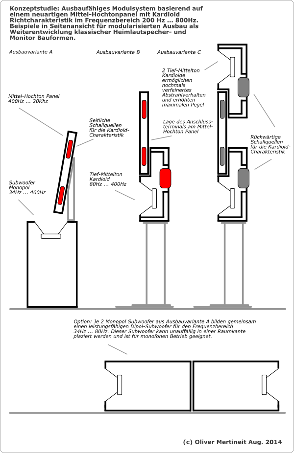

In fact it is the contrary, what i achieve in followig my current designs goals. I am far away e.g. from the "only highs in sweetspot" and "very dry" impression that many ESL produce.
It is a new kind of directivity using phase decorrelation as a new and additional "dimension of directivity".
Average DI is rather high (in order of dipoles and cardioids) but there is also reflected sound from midrange on upwards, that is sufficiently flat in energy response up to the highs.
BTW i am not just talking about matters or relying on "wishful thinking" but have also support by measurements.
I have in fact overcome the drawbacks of conventional DML.

My next "decorrelating" loudspeakers will rely on (dipole-) subwooofers and be satellites as "LF combi units" switchable from cardioid to dipole radiation pattern in the range from 80Hz to 400Hz.
The role of the current fullrange bending wave loudspeaker from midrange on upwards will be taken over by an array of mid- tweeters in a special enclosure and arrangement that morphs radiation pattern continuously from "cardioid" to "decorrelated side radiation" from about 800Hz on.
There is also a difference between the vertical and the horizontal pattern, as side reflections are preferred over ceiling and/or bottom reflections.
BTW the radiation pattern doesn't look too different from patterns of some Waveguides ... but the radiation to the sides is much wider than WG, even if reduced in level and more decorrelated from the direct sound.
But again: Not too different from the Moulton proposal either. But it is applicable in a living room without extensive absorbtion.

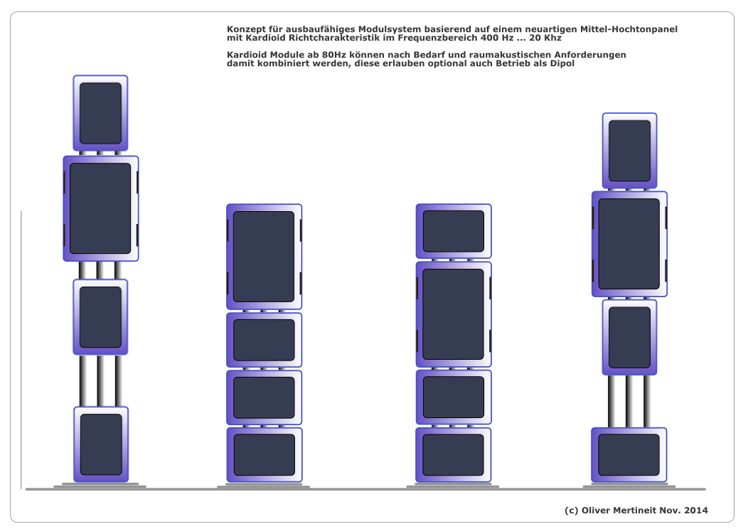

Thanks graaf ;) ,
besides the "main concept" there are many many solutions implemented "to make it work smoothly".
E.g. i won't be showing the motor units (i call them "driver boxes") which are placed at the rear of the segmented panel.
Each panel segment is operating fullrange, moving together "as a whole" for low frequencies.
The "modal overlap factor" is higher than in any musical instrument's soundboard built so far, that includes also grand pianos from the worlds-famous manufacturers. Im not kidding here ...
My initial motivation in making it work fullrange was forcing me to achieve a high modal overlap enabling a smooth bass response.
This results - as a bonus - in a modal overlap in critical midrange which is about 3 orders of magnitude higher than e.g. in a manger type bending wave transducer, where you can count the main resonances up to say 1 Khz easily in the impedance curve.
Thus my transducer is based on modal behaviour but nevertheless does not "show" resonant behaviour.

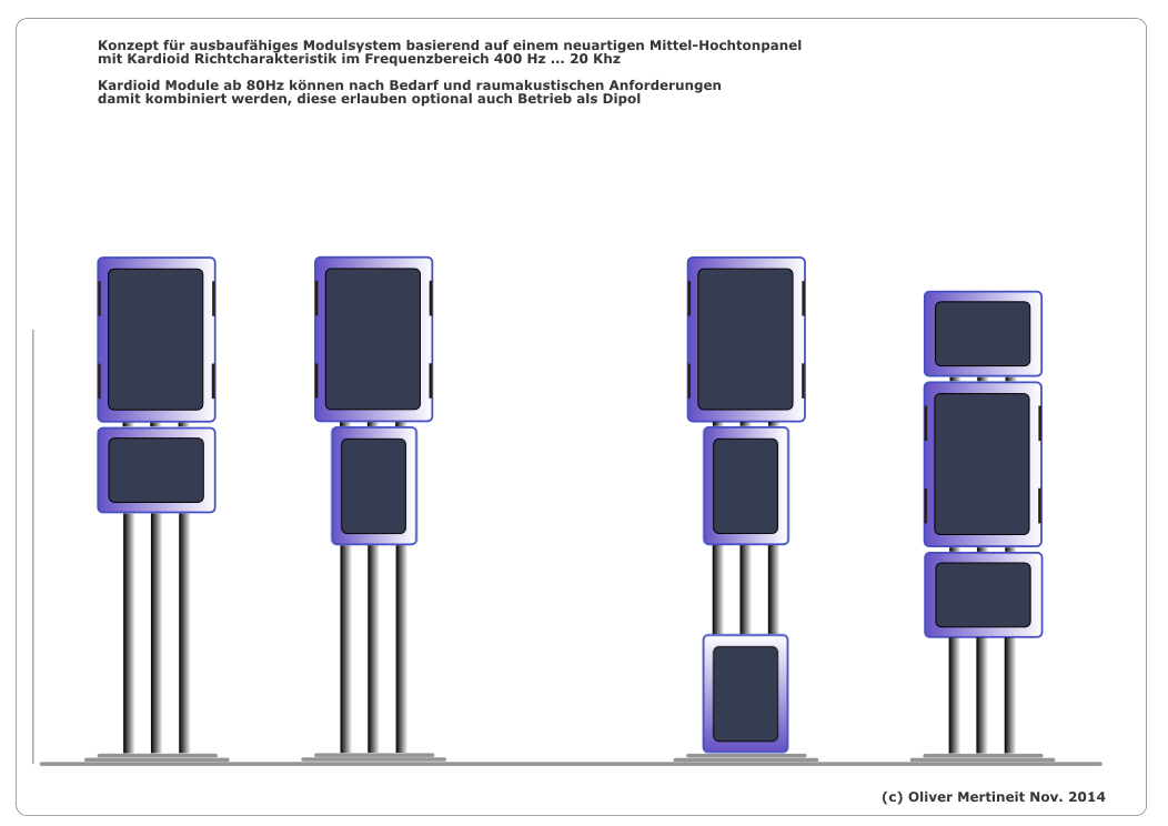

The immense effort made me think, how similar behaviour may be achieved with less effort in manufacturing.
Now i am at the start with said new multiway design comprising a new kind of array, which i refer to as "virtual bending wave transducer".
When thinking about this enough, one can get to the conclusion, that bending wave loudspeakers are not needed to mimick their own behaviour and do it - possibly - even better than "the physical original":
What we want is a radiation pattern in the end, not more not less.

@graaf:
Neverhtheless i can imagine the mid- to hirange panel arrays integrating to your preferred "FCUFS" aproach a lot better, than most conventional tweeters will do.
But such a panel should be directed at the listener and not be radically "upfiring".
Directivity and diffusivity will make it more immune due to "very early reflecions" than using e.g. a usual dome tweeters close to a room's sidewall or close to the edge of floor and sidewall, as can be seen in many examples for loudpeakers in this thread.
Attached pictures show some "fictional" options ...
First picture was already "outdated", but variant "A" could be a "blueprint" for integrating that panel into an "FCUFS". The panel shown in sideview here.
Second and third picture shows possible modular variants in integrating the panel with compact cardioid woofers, to make up cardioid satellites from 80Hz on upwards.
The cardioid woofers will cover the range from 80Hz to 400Hz. For sufficient dynamic headroom in a larger living room, 2 cardioid modules will be needed, due to listening habits regarding level.
Kind Regards
