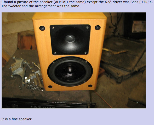

I found a picture of the speaker (ALMOST the same) except the 6.5" driver was Seas P17REX. The tweeter and the arrangement was the same.
It is a fine speaker.
But when I listened it placed on the floor it sounded like a radio, if such a comparison can be made

Interesting, that shows a bit wider dispersion than I expected considering the ceiling reflection was louder than the initial impulse in the wavelet chart.
looks like Amphion or sth
so it is an Amphion, isn't it?
dispersion is similar to Elias' speaker.
yes indeed, even very similar
