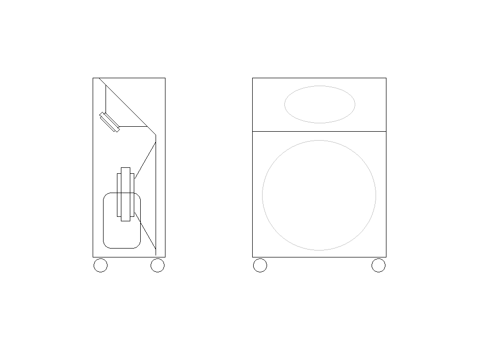

maybe I have posted this before but in this thread I guess its ok to post it twice
That is not floor coupled
But I now it will work very well. How do I know, because I have tried something very similar.
I posted this before, too, but cannot remember which thread Nevermind, as this thread is famous for double posts here is picture of my earlier experiment.
Floor level dipole and upwards tilted tweeter horn at ear level:
