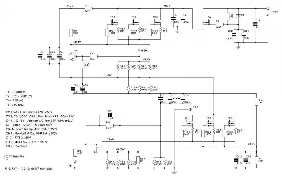

Your work is so remarkable. I want to do the same experiment. But need to confirm the final circuit. could you share the 50W version?

Yes, I use two separate external power supplies with 800VA trafos each, 48V secondary, approx +60V rail voltage under 3,8A load. Connection of power supply with main block is made by cable on the basis of Analysis-Plus speaker cable, connectors are original Neutrik Speakon. Rectifier uses Shottky diodes (100V and from 30A to 50A would be OK). 50000uF inside each power supply and 2x90000uF in the main block. Every electrolytic capacitor is shunted by polypropylene or polistyrene (near 0,1uF). Connection point to the capacitors rails should be chosen by measuring impedance in various possible connection points.

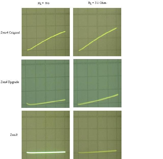

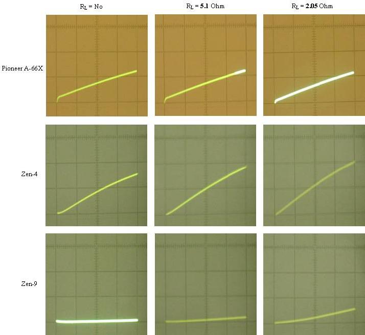

Just for testing low frequency features of Zen4 and Zen9 I measured square wave responce (10Hz, 30V peak-to-peak) at various resistive loads. Also the Pioneer A-66X amp was measured. The negative parts of square wave are shown in the picture. With 2.05 Ohm load the output current is close to 6 Amps. It seems that both Zen4 and Pioneer have some problems with the values of interstage coupling capacitors, they can not keep on square signal even without load.
I have managed to add 50 uF film capacitor to C2 (Zen4 schematics). Now square wave looks better, but general impression from Zen9 sound is better still. Upgraded Zen9 sounds as a big amp without any reservation, while with Zen4 one should justify it by its belonging to FirstWatt league.

Zen9 is probably a most suitable schematics for easy power upgrade. With 48V AC transformer secondary voltage I have nearly 60V power supply output voltage at 3,8 A bias current. Output power can be calculated from: 54V peak-to-peak voltage and 7,6A maximum current. Everything important for making the upgrade has been wrote by Nelson in his Zen articles. To make first step from the original Zen9, just use more transformer power, larger number of capacitors in PS filter, shottky diodes rectifier, good output electrolytic capacitors, bigger film shunting capacitors, and use also film shunt with the Aleph current source capacitor. Outcome will be essential. Sound is very clear, situation with no traces of capacitors artefacts can be achieved, and on the top of this it is a sweet single-ended schematics.

I have tested very simple way of achieving good bass reproduction. In Zen9, just changed resistors of NFB divider to 3k4 and 6k8, also adjusted NFB compensation cap to 30...60pF. Zout now are 0,34 and 0,15 Ohms, it is comparable with speaker cables resistance. Power supplies are external, 2x1kW trafos.
Bass now almost perfect. Very tight and powerful in 6x5,5x3m room. As for highs, they are the same, or very little worse, almost impossible to distinguish.

- The 50W version of Zen9
