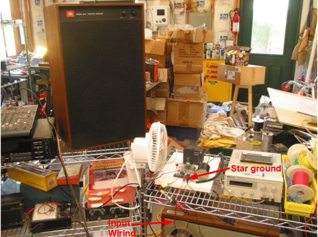

Well, I connected the 10AWG ground wire to a barrier strip on the bench so I have a single point ground reference. Then I set up isolation transformers for the computer and monitor since the computer is the most likely source of noise. I can see it on the sound card output even though in loop back it looks clean.
It made a slight improvement.

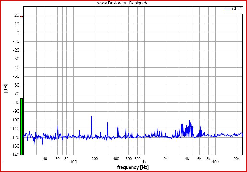

Here's an FFT of another Adcom 565 I am working on -- it was averaged 64X. The cables are decent quality 50 ohm RG-58/U

-100dB down is beyond my working brain: I'm much noisier than that. However, even at -80down I found my bench was contributing to the hum; the old trick of slipping a sheet of ally between the mat and bench and grounding it to the chassis works wonders.

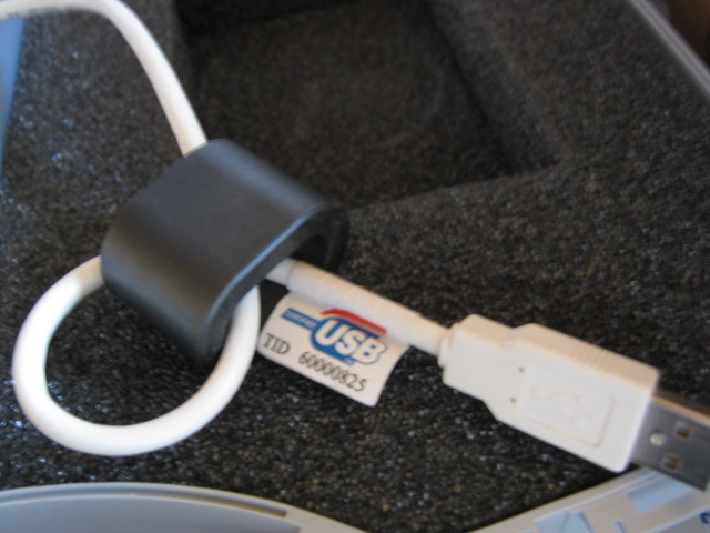

Also got a large sized ferrite ? a couple of turns of the USB cord also reduced unwanted spikes as did the mouse cable.

I'll try the mouse and keyboard cables.
I put ferites on the audio in, out and both together with no effect.

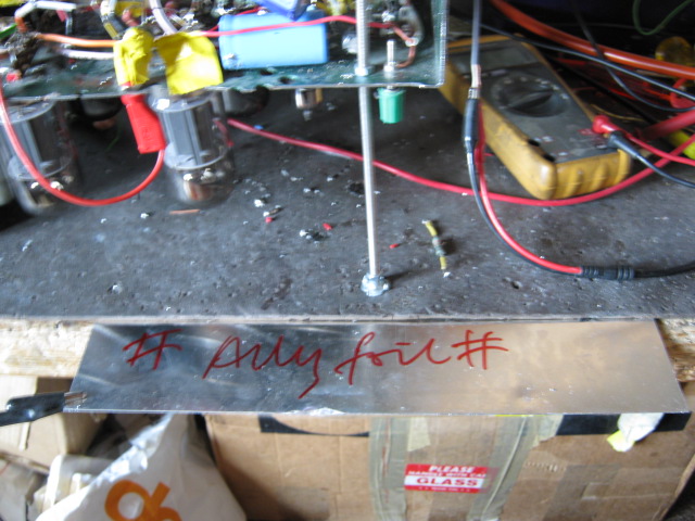

I've considered putting copper sheet on the workbench. I think I have a piece of .032" that is 12" x 6' that I could make a ground plane out of.
Hmmm. I think you still have grounding issues to work out before building the 10x10x10 Faraday cage ;-) It's more likely going through a wire than the air.
Make sure there is exactly one conductive path from each piece of gear to your ground. I think there may be someting going on between your computer power supply and soundcard ground from your description. Try lifting the shields at one end...

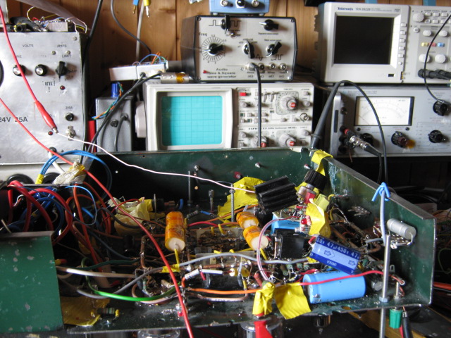

Looking at the photo, there are other benches looking like an element of havoc (mine) in this forum, Kein wunder the noise is up but it works ! Experience counts.

bench... you were lucky to have a bench... I had to build amps on a pair of wire shelves ;-)

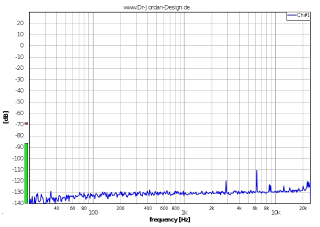

my -100db/1W breadboard (probably closer to -90db rms noise):

Here's the performance of the transformers in an HP353A Patch Panel:
Quite good, I would say, considering that they can be had for next to nothing at hamfests. The Jensen JT-123 is close to flat from 2Hz to 200kHz but will set you back over $80.
