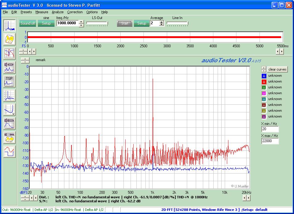

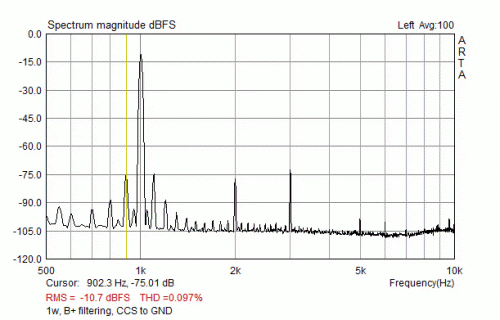

I am experiencing problems trying to take FFT readings (s/n, THD, IM, etc) of a single triode gain stage 6NP1 AV 30.
My problem is the high background noise level I see when I run the amp with the reference return connected to chassis ground which is tied to safety earth (green wire on power plug). Reference return is tied to chassis ground via two anti-parallel 1N4007s.

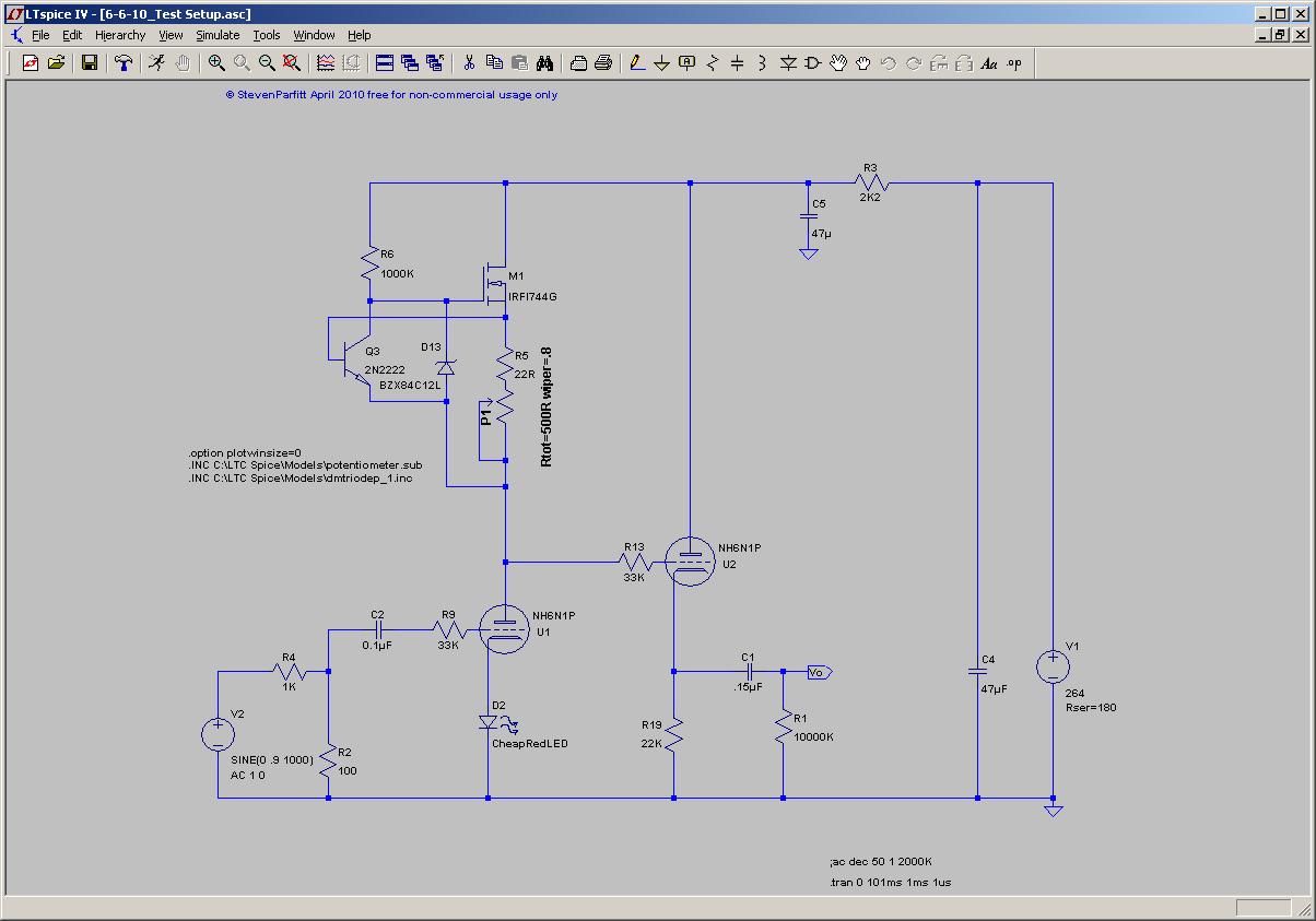

First figure is LT spice of the amp circuit.

I use a 10:1 resistive divider on the output of the sound card to the input of the UUT to allow me to run M-192 near -18dB output level to maintain a higher signal to noise ratio on the output from the sound card. The output of the sound card is adjusted to give a 1.0Vrms output from the UUT back to the sound card input.
The output of the gain stage is buffered with a cathode follower as I have seen loading issues when driving the sound card vs HP333A Distortion analyzer. (Is this an acceptable way of buffering? Would a FET source follower be better? Something else?).

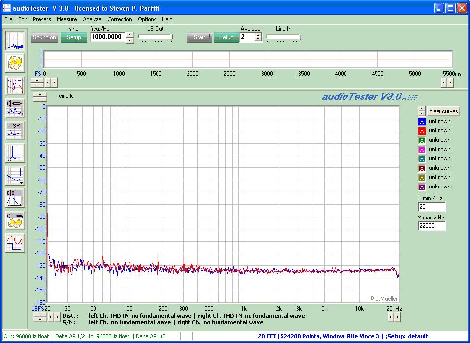

Loopback of the M-192 to itself shows a fairly clean plot (plot 1).

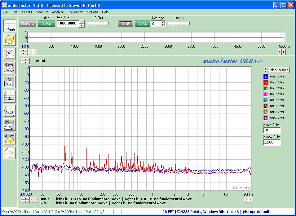

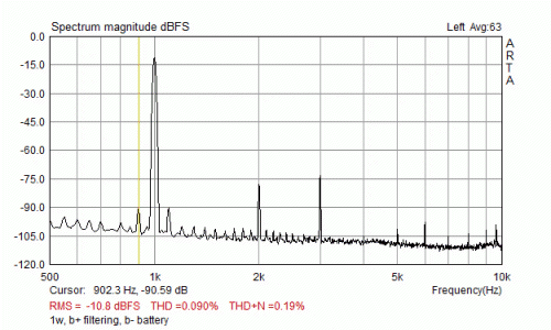

With the M-192 output off to the UUT and the UUD driving the M-192 input (filament but no B+) there is a lot of noise already present. This noise seems to be pretty broad banded although 60Hz and its harmonics are also pretty strong. (plot 2)

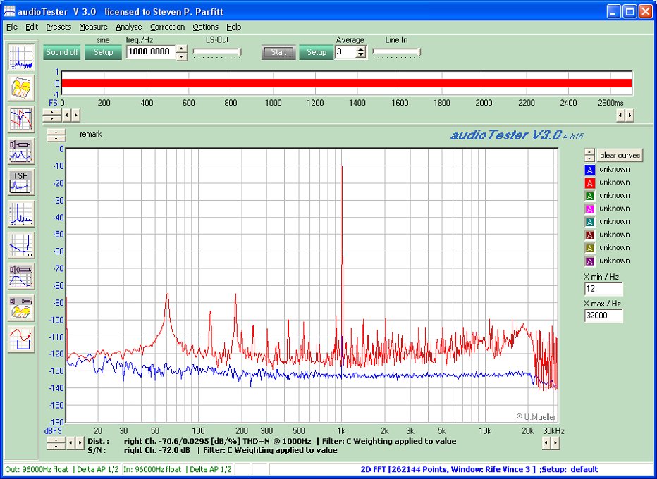

Turning on the 1KHz output and B+ results in a significant increase in noise level with a s/n of only -62dB and THD of 0.0807 which for a single gain stage seems pretty poor to me. (plot 3).
Last night I shout off all the CFLs in the house to see if they were a problem, but did not see any difference in the plots.
At least out to 300Hz there seems to be a lot of harmonic content from the 60Hz mains. Beyond that I can’t tell if the noise is related to power line harmonics or not, but if I have 300Hz within 5dB of 60Hz it looks to me like I have a serious line noise problem.
I’ve tried a line filter (and noted the specs don’t show any attenuation below about 40KHz so it is useless), and I’ve tried an Isolation transformer in attempts to isolate the UUT. Neither helped.
Any ideas on how to rule out noise from the computer?

There's a lot of potential sources for the noise (note that it's not a lot of noise- it's mostly sub -100dB). The computer itself, with its radiation being picked up by the interconnects. Lights, especially CFLs (you turned yours off, but were there any others nearby?). The unit under test acting as an antenna. Nearby motors. Refrigerators.

Your results look normal if you are doing a single ended measurement with the M-Audio card. I get similar results.
If you want to do a clean measurement you need to make a balanced probe setup. Connect the + input from the sound card to the preamp output as you are currently doing. Connect the - input from the sound card to the output signal ground of the preamp.
By using both inputs from the sound card you are measuring the voltage output of the preamp and subtracting any noise that is on the signal ground.
The down side to making measurements with a high performance sound card is you quickly learn that it is a loosing proposition to expect clean signal transfer using single ended connections between different audio devices. Based on the experience of trying to make clean measurements on the bench with single ended cabling, all connections in my main music system are balanced.
Also, for the safety of the sound card you need at minimum to setup clamp diodes to prevent over voltage input from damaging the sound card input opamp. The input of the M-Audio card has no protection on the input- unless you consider a 5K series resistor on the inputs of the 5532 opamp protection...
If you are planning on using the sound card for measurement purposes you should build some sort of interface box to to buffer the signal, provide attenuation/gain, and protect the sound card. Pete Millet's input buffer project is nice. I designed a 2 channel fully balanced buffer/attenuator interface 5 years ago that is indispensable on the bench. After I become jobless in September I may pursue offering up a semi kit like Pete has.

What is the impedance of the 10:1 voltage divider? THings I do to reduce noise is to run cables as fart apart from each other as possible, and when they cross od it at 90 degrees. Use shielded signal cable. I also use Pete's sound card interface which makes it better.
Reality is that maybe the circuit is picking up the noise. The loopback, providing it is of similar impedance, is showing you what you have from the computer and soundcard.

Coincidentally (or not) I just went through the same set of issues to get my measurement noise floor below 100db.
My ADDA converter is an Alesis AI-3 which uses ADAT lightpipe to/from the computer so there is no ground loop there.
First, I did a loopback test and noticed as you did that the analog levels must be kept below about 1VRMS (even on pro audio gear like the AI-3) or the A/D and D/A will add it's own harmonic distortion.
Then when I hooked it up to an amp circuit for testing, there was power supply noise everywhere. I was using an external bench supply with it's own AC ground that was creating a noise current loop ("ground loop") due to the multiple ground connections in the wiring of the test harness.
Before I took the time to think it through, I first tried as you did to add an additional brute-force ground, which made things worse.
Then I back-tracked and started probing with a scpope on the amp with no signal. I found that 100mv of noise was appearing at the amp's input terminals.
My power supply was floating over 100mV of noise across a length of 16 gauge wire (power cable ground wiring) between the power supply and the ADDA box.
The solution for me was to put an isolation transformer in the AC line to the bench supply and connect the bench supply ground to the amp ground. What I did was in fact create a star ground on my workbench at the amp power connector for all of the AC and signal returns.

Take a look at Pete Milletts sound card interface, this is what you need to do in order to make good, repeatable (and sound card safe) measurements using your sound card.
I am using this with an M-Audio 24192 and Audio Tester 2.4 (I'll upgrade to 3.0 shortly - looks way better.)
Pete's thread is here: http://www.diyaudio.com/forums/tubes-valves/155405-test-measurement-interface-soundcard.html
This takes care of a lot of the sort of issues you are dealing with.
Ground loops and radiation from the computer and monitor (somewhat less of an issue with LCD monitors, a bear with CRTs - not that I have any except for my TV now).
Mike's suggestions regarding star ground and isolation transformer will also help a great deal. Do not succumb to the temptation to float the PC, the PSU in many PCs has appreciable leakage current and you could create a minor or not so minor hazard.

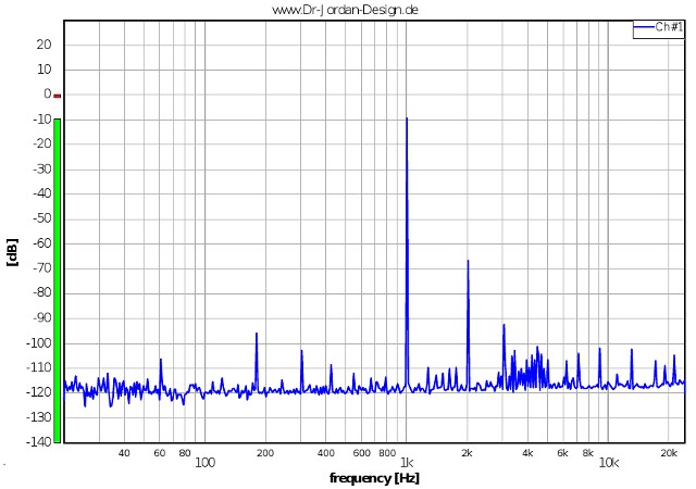

I use notebook PCs for my measurements, preferably running off battery. This avoids most noise problems.
When using the built-in sound I/O, the noise floor will only be around -100dB compared to the 130dB in a premium sound-card, but good enough for most of my purposes.
Attachment is a PP power amp.
SveinB.

That's pretty good resolution for a laptop sound card. You do need the battery; with the typical AC adapter, now required in many locations to pass the ground through, these things are useless for audio when AC-connected.
Looks like you're on 100Hz power. Here's an example of the ripple intermodulation often referred to; sideband energy at f+100 and f-100 Hz, -60db
Edit; Sorry that would be 50 Hz power, 100Hz ripple. Be curious to see the effect of a SS ripple reducer in the B+
Michael
The IM is produced by the LTP driver. Cleaning up the negative voltage and LED reference for the CCS and better filtering of B+ reduces the IM.
Svein

Well, I connected the 10AWG ground wire to a barrier strip on the bench so I have a single point ground reference. Then I set up isolation transformers for the computer and monitor since the computer is the most likely source of noise. I can see it on the sound card output even though in loop back it looks clean.
It made a slight improvement.
Now that I have the bench cleaned off I'll wire both inputs of the sound card so I can use one for the ground reference input.
Next order to Edcor I'll get a couple of isolation transformers to play with. Thanks dsavitsk.
Latest plot shows lower distortion and higher s/n so I'm moving in the right direction.
Which brings me to the question of what standard to test to?
what weighting? "C weighted"? I turned it on.
What cut off frequency for the lower cutoff ? I've been using the default 200Hz.
Is there any standard for comparison purposes or is it just a matter of 'whatever floats your boat'?
