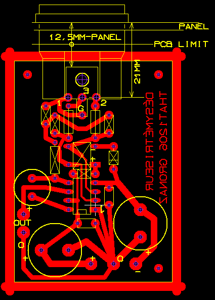

Balancer AND unbalancer
Hi guys, here is the job for DIYers, with RF & EMI protections like in THAT datasheets. Ferrite beads I selected are 2661023801 from Fair-Rite, zeners BZX79B-12 and protection diodes on both PCB are Vishay's bridge 1000V/1A with relatively low leakage DF10M-E3 for availability.
There is an optionnal OPA227/8 input amp on the line driver you can cut out if not usefull, or keep and possibely adjust gain.
Some optionnal components are not mounted (the ones with a cross insde) or replaced by a strapp (the ones with a straight line inside): refer to datasheet.
Guys, is my design "Pin-1 problem" free?
bye bye

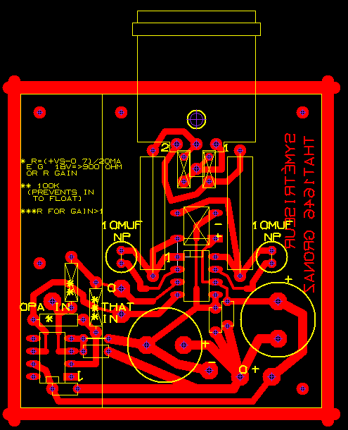

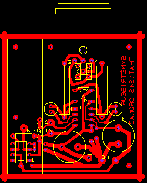

bye bye

Hi Colinh
I don't sell pcbs. Instead I get them made by my local electronic shop here in south-west France.
WARNING: there seems to be an error in my driver 1646 PCB at the OPA227 traces (input pins swapped together and feedback resistor misplaced: the pcb "seemed" to work when used with unity gain OPA227 wiring... I still don't know why:eek:; ) Give me some days to correct it)
Sorry
Inputs are not swapped. Unity gain at OPA227 as worked as is. The error is in feedback resistor when-used-instead-of-a-strapp (OPA227 with gain>1) misplaced/mistraced/misrouted: in this case you find the 1646 input (pin4) linked to OPA227 inverting input instead of output.
As said give me some hours/days to correct this. The steven2992 guy I forked the ideas from THAT 1646 unbalanced to balanced line driver also added a 100k to ground on OPA227 input, whose necessity depends on whether you may have this input floating or not.
"...you may have this input floating or not..." also/mainly means unplugged, although equivalent situation may happen with unpowered circuitry before the OP am, depending on it's unpowered output impedance... I'd rather add this 100kΩ resistor... after I check the datasheet...
Don't forget (as I did :rolleyes:) this PCB doesn't provide any trace from supply 0V to input 0V. This is intended to prevent any hidden ground loop.
So if your design carefully isolates input jack ground from chassis or any other ground, think to connect the input ground of this PCB to the 0V of its supply.
