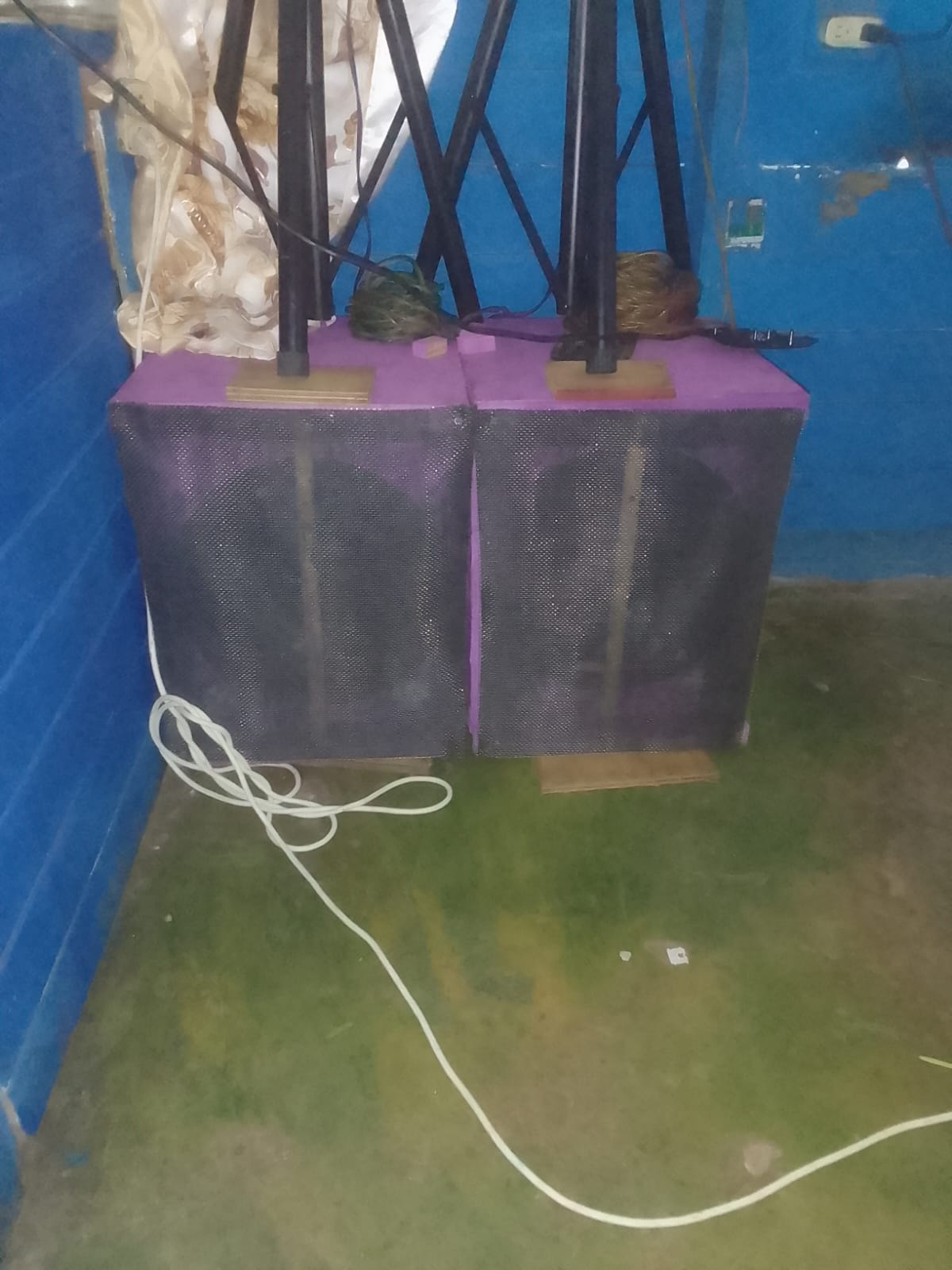

It is the general consensus of the DIY community over here to use 18mm ply for sub duty, even more if you are going to use as a mobile PA operator, somebody over here shared a tale that a 15mm ply sub he made only lasted for 2 or 3 gigs, the thing disintegrated apart from the forces inside the horn.
That is not my personal opinion, it is the voice of the community.
That being said, if you still want to drown , I don't think somebody will waste their time converting from 18mm to 15mm and making a cut sheet.
If that is your choice I guess you are on your own.
Yes I know this, every cabinet I build I add sufficient bracing to minimize flex, I just need more out of my 15s in a relatively small package you know. Bass reflex isnt cutting it and I'm totally fine with the bandwidth that the THAM15 is efficient in.
I would have gone with the SS15 but that is slightly to big for my use and I like the simplicity of the Tham, its just a nice little cute box hehehe
A 8mm ply box joined correctly only on the edges together with 4 trusses can take over 60hp and all the dynamic loads of years of commercial use without losing a single seam, when built correctly! And not suffer from panel resonances!
Don't intend to be rude, but just how badly is community building their boxes that a speaker can make it fly apart? I take it that you guys are all designing and making the boxes as furniture and using those practices rather than making true monocoques for holding an electric motor with reciprocating action

Ok, show your 8mm plans that can take years of commercial use......
Personally I have never seen anything less than 15mm ply PA sub and that is Jbell SS15 that used 15mm ply, everthyng else use 18 ply.
But I'm not blind to some undiscovered scientific achievement, enlight me with your wisdom.

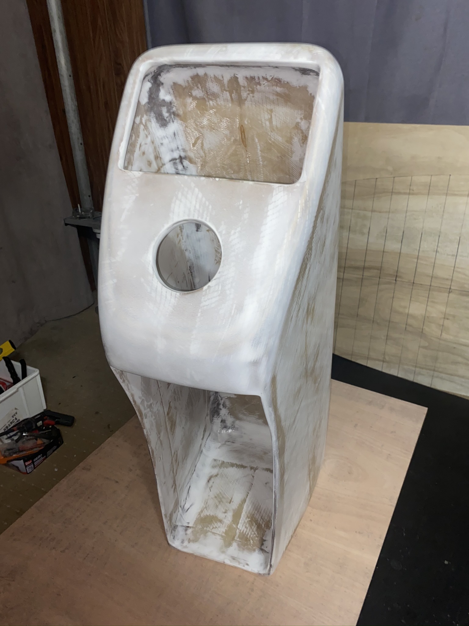

Save your sarcasm man, if you want to ignore the correct way of using ply as a panel material for motor mounted structures and rather build crates then that's your prerogative. There is a whole industry out there using ply panels with much more advanced engineering. Even the furniture in those systems recognise the dynamic loads and use the system. The only thing made as "box" is the shipping crate for the motor
Plywood construction
Here is my first attempt, in commercial use for the last 10 years and withstood a number of tropical cyclones including the category 5 Winston. 8mm ply
https://www.facebook.com/media/set/?set=a.731462436942426&type=3
Here is the console that is going in my CC. This boat is a wave jumper, :D How do you feel about this as PA cab for longevity over something built like a furniture box?. It's built according to the book out of 6 and 8mm
Reactions: 1 users
