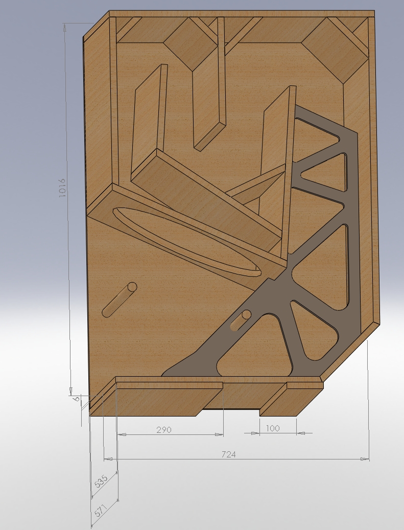

Okay gettin there! Cut out the brace using the spare wood, yes it was a pain in the ***! Please excuse the cuts I know they look like a 3 year old cut them out, my jig saw sucks, as do my jig saw skills lol

Yeah i can put those in after the side is glued on. I don't think i need a ton of bracing, correct? one should suffice just to stop the flexing...?
Correct me if I'm wrong, but danley's sub doesn't have a large brace down the center like this one, does it? Any insight as to why he doesn't use one? I don't think he is using a superior material....

Some use aluminium pipes with 'draadeind' (sorry that's dutch but I haven't a clue for the English word) in them.
That way the diameter is the smallest and you have a easy way to fix the bracing with it. The pipes will keep the inner distance perfect and choose shallow end nuts (you can make them drop in the wood, sorry for the English again) and something like 2 component machine glue for both nuts to fix them from the outside.
In other words: nut, side wall left, pipe, middle bracing, pipe, side wall right, nut and then the 'draadeind' trough all of them...... pffffffffff....and some rings....
With wooden 'broomsticks' use at least 3,5cm (35mm) but make sure you glue them and fix them with extra long screw bolts (pre-drill the wood to prevent splitting) from the outside. If you don't want them to go trough the bracing in the middle, you can use a two tapped end screw type (connecting screws? two side screws?)

Bracing the mouth
Hi Y'all,
Nice job!
I would suggest using three sideways braces, two up front, and one behind the driver.
Maybe schedule 120 1/2" PVC pipe (O.D. .840 / I.D. .480 / Wall .170 nom.) w/ a 3/8-16 allthread? Or just 3/4" - 1" wood dowels with #12 wood screws?

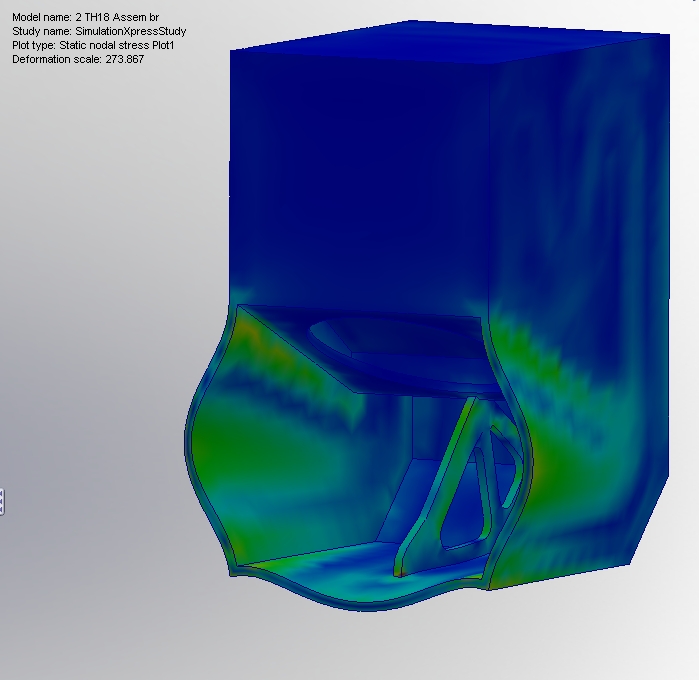

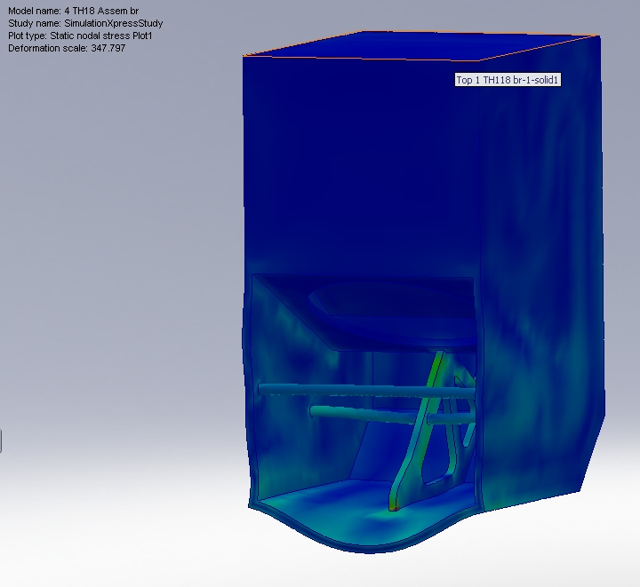

Hi All
3 screen prints showing the TH 18 being blown apart with internal pressure on the panels
First without no ties
Second with 2 ties as Djims suggestion
Third with 2 ties and some double material added to the speaker base.
The pressure is consistent for all 3 sims the telling parameter is the scaling factor used. The last sim shows deformation of less than one third of the first.
That's why I prefer to use the tie bars with the combination of an enforced grill. It's the combination of horizontal and vertical reinforcements.Even with the doubling of the base there is still more deviation in the base than the sides with the tiebars
