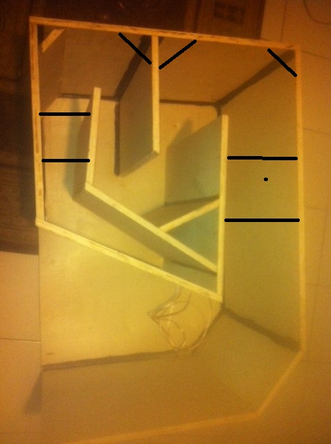

good day to all. this is a picture of the two cabs i built. i used the original design before lerning about all of the internal bracing. i used all four of the reflectors and went back in later and installed two braces where i could.this is a picture from when i first started the build and had to ink in the reflectors and added braces, sorry for not having a proper picture.
http://www.diyaudio.com/forums/attachment.php?attachmentid=399802&stc=1&d=1392381194
i am using 18sound 2400s in them and recently added new equipment to my system. i havnt hardly used these while waiting to upgrade my system
here is a list of what i have now
two th18 subs loaded with 18sound 2400s
two jbell12 tops (dayton 310-8 and selenium 220ti-8 compression drivers)
two dual 18 cabinets
two single 18 sub cabinets
beringher inuke nu6000dsp
crown macrotech 3600
crown macrotech 2402
qsc rmx 2450
DBX driverack DRPA+
Firstly i would like to know if the th18s will be ok without the remainder of the bracing as they have been glued and cannot be opened without major damage. also would the 18sound 2400s be ok using in these cabs and if so set to what hpf and lpf as to not burn them up.
if anyone out there has had experience with the driverack drpa+ would you be able to help me with setting up my system properly so as not to damage anything.
if any of this is not supposed to be posted here i do apologise but i really do need some professional opinions. i have learned alot by reading this forum but want to be sure not to damage my system.
thank you all and have a great day
