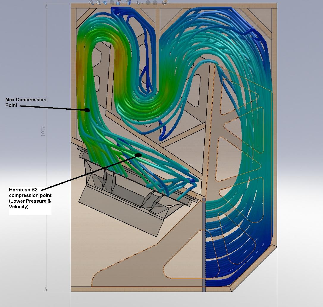

Compression Ratio?
I’m Thinking about the horn throat design for the TH18:scratch:
My first observation is about the compression ratio (as reported in Hornresp when you hover over the S2 area.)
Most people on DIYaudio try to keep this ratio fairly low. 2:1 or thereabouts.
At this point in a TH you are only looking at half the driver, the other half is past that point in the horn. Does this reduce the supposed compression ratio at the S2 area by at least 50%.?????
Your thoughts please!
Regards Martin. (Xoc1)

Hi Johan, that makes sense but only at low frequencies. Is that not what happens when the driver becomes unloaded below the resonant frequency and a hi-pass filter is needed to avoid excessive excursion.
I think that the maximum compression in the TH horn is reached at the point in the horn next to the edge of the driver, not the centre.
As such the Hornresp compression ratio reported is still useful information but does not specifically relate to the actual S2 point in the horn.
Flow analysis sim screenshot attached to illustrate this.
I am trying to concider what is really happening in the TH horn throat.:)
Regards Martin
