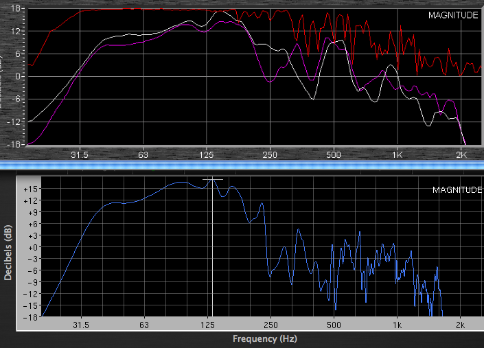

The DSL TH-118 rolls off at around 24 dB per octave rate, not very gradual.
DSLs graphs are rather "stretched" when compared to Hornresp.
The graphs below shows one of Langston Holland's TH-118 and TH-115 on top, my Keystone 18" TH below.
Frequency and phase response are similar, excursion goes up rapidly below the low corner.

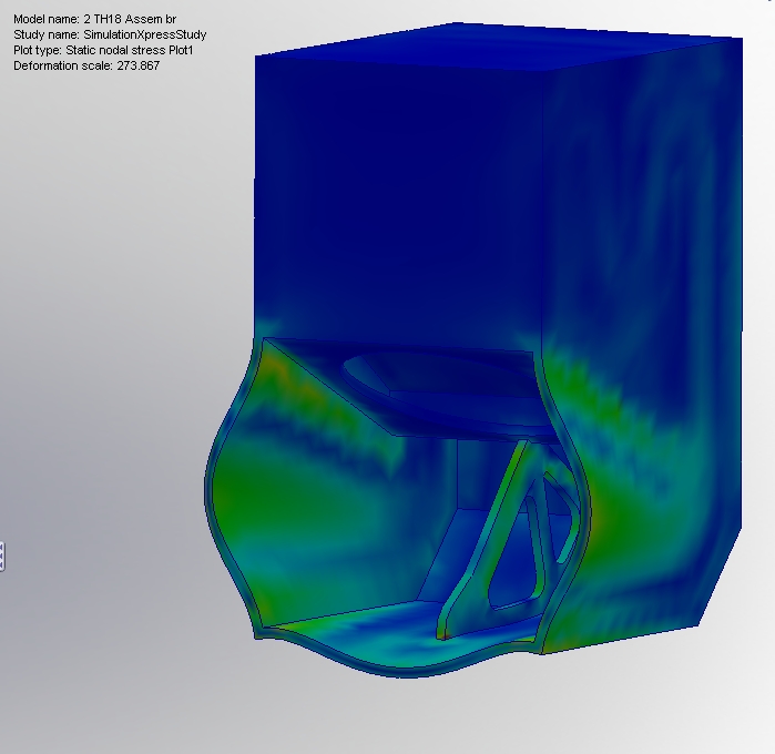

Thinking if it helps fix similar slots to the sides from the front/mouth to the back to avoid any vibration at that points.
Could be thinner solid wood slots as teached by Weems in Designing Building and testing your Own speakers Systems
regards,
The strips on the bottom are placed across the grain. Would it be better to place the strips on the sides across the grain as well (up & down opposed to front to back)?
Yeah, they're a grip of cash - for sure! They were the first I saw to use this material in cones. I soon after searched to find Morel and Alpine also using this material as well. Totally different end of the spectrum as far as price is concerned ;) Haven't followed up to study their different methods in how they use Rohacell compared to one another.
Less delamination and turbulence potential front to back.
Since plywood grain alternates each layer, not much difference from a stiffness ratio, though side to side would probably be a tad stiffer in this configuration.
If a front grill is fitted, it will add cross stiffness.
If no screen is fitted, easier to sweep out debris the way it was done ;).
