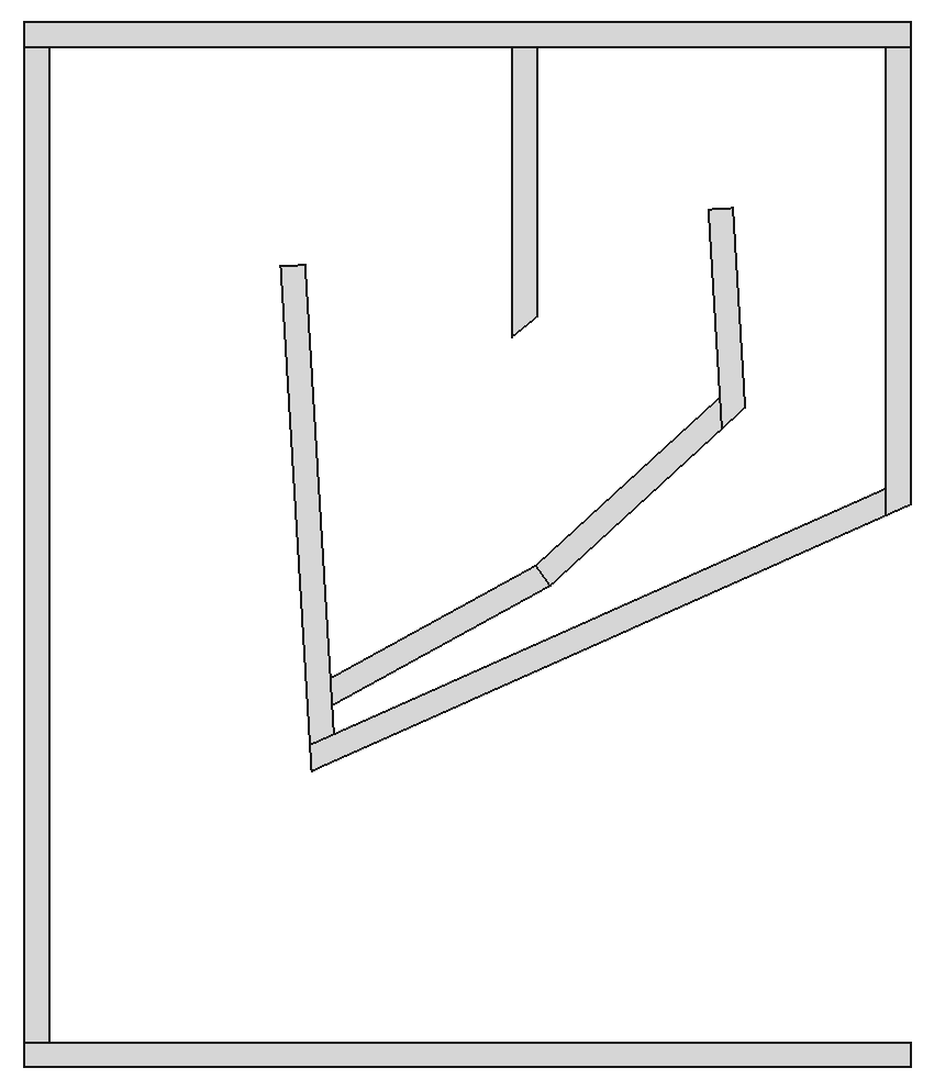

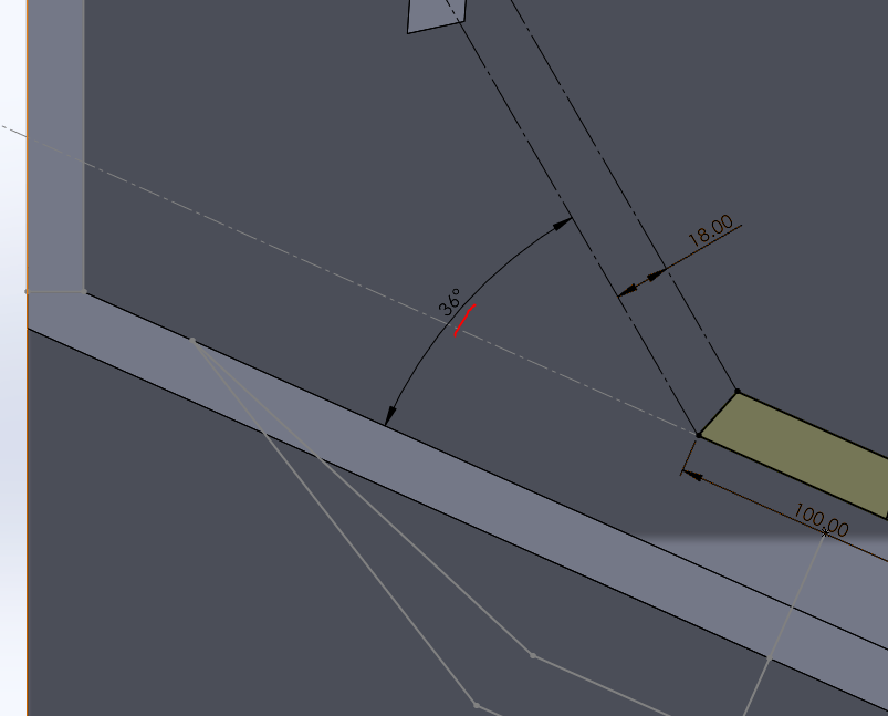

Morning @Xoc1,I looked at some of my models and I suggest that the inner panel angle is too steep - causing the initial expansion.
Appreciate the response. We're going to take a look at generating the hornpath of this iteration of the TH18, and will post here when it's complete.
With respect to the inner panel (too steep), it's current at 36deg - see below. This matches your sketch in post #2963 as far as we can see. Are we missing something here?

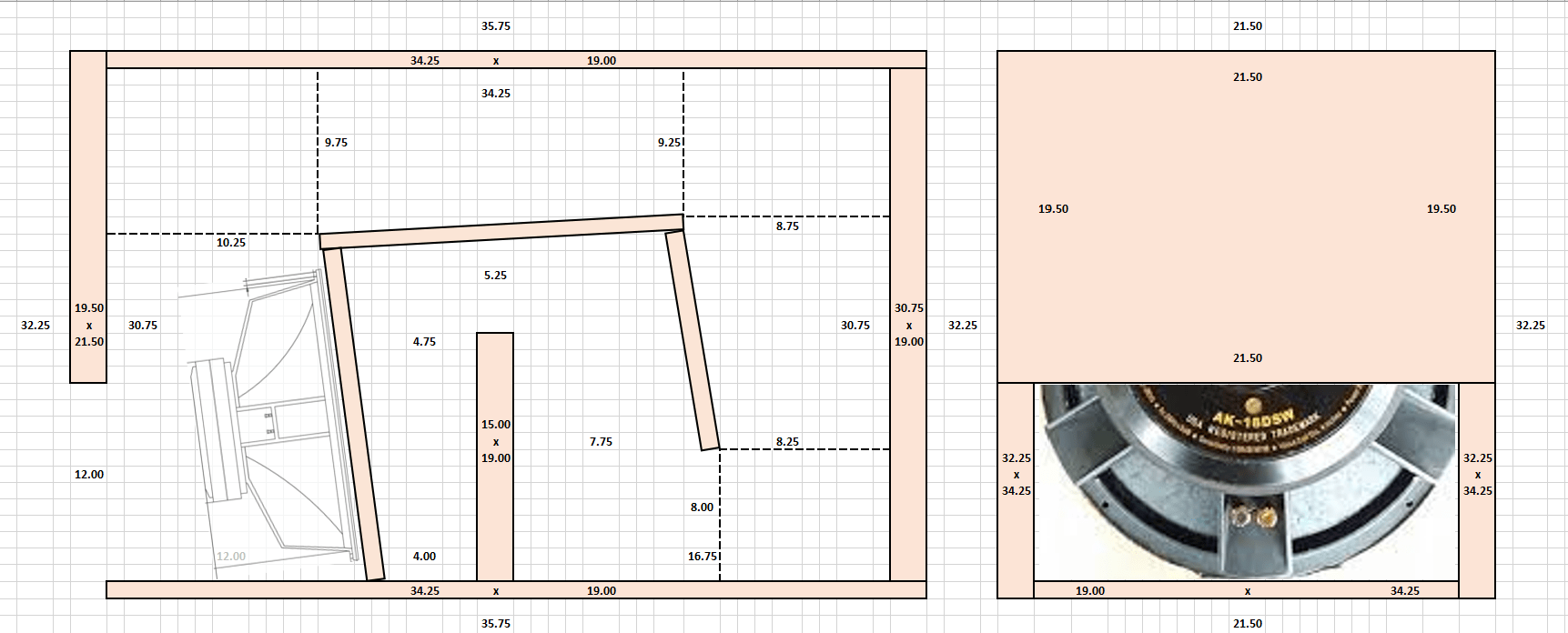

This thread is for anyone who builds his box. I figured I would start because I think I am one of the first to do so!
I will go pick up some good high quality 3/4" Birch tomorrow and get started on this. Pictures to follow asap!!
Here is the Sketch plus a nice cut list...
Extra bracing which Djim suggested...

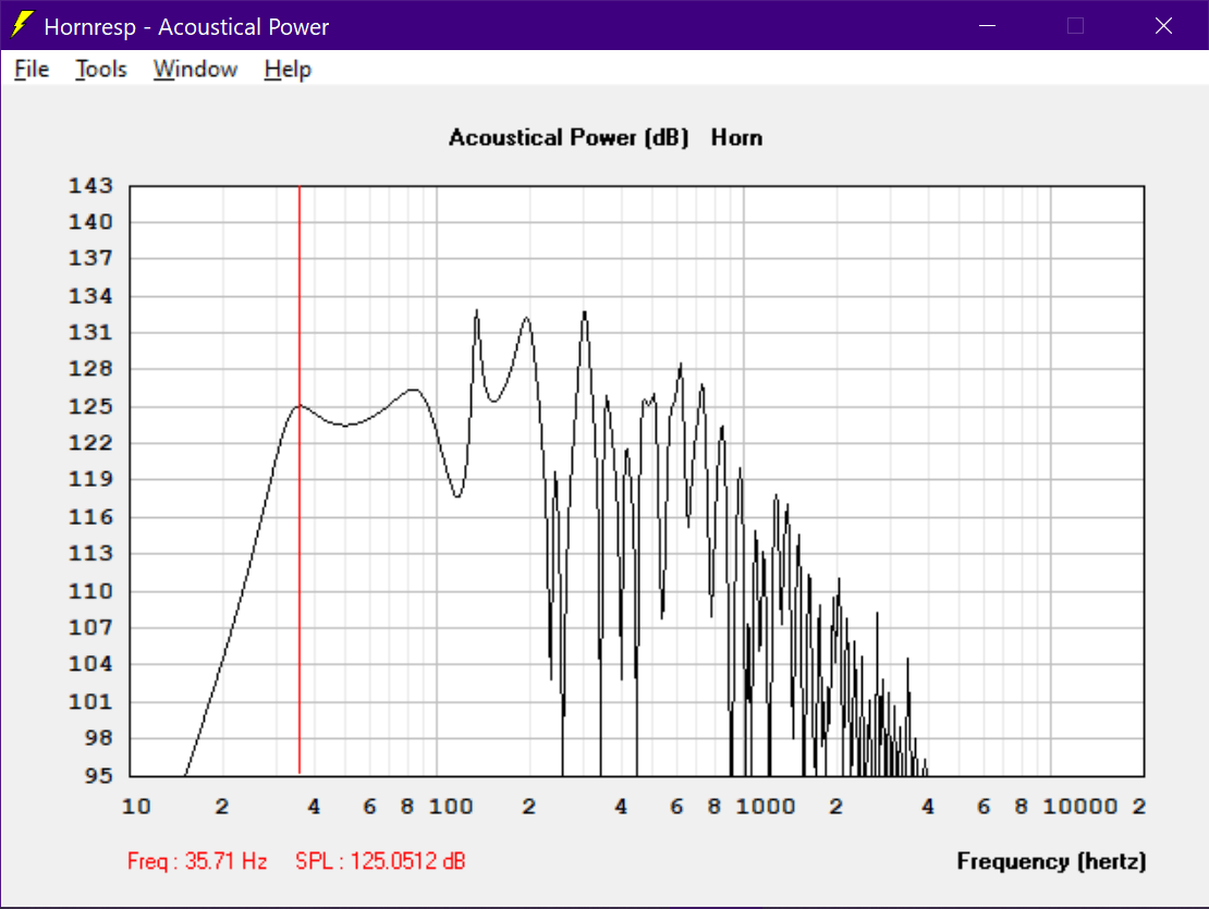

Here is a sim for 4 cabs at xmax + with the 18 sound 2400 drivers...

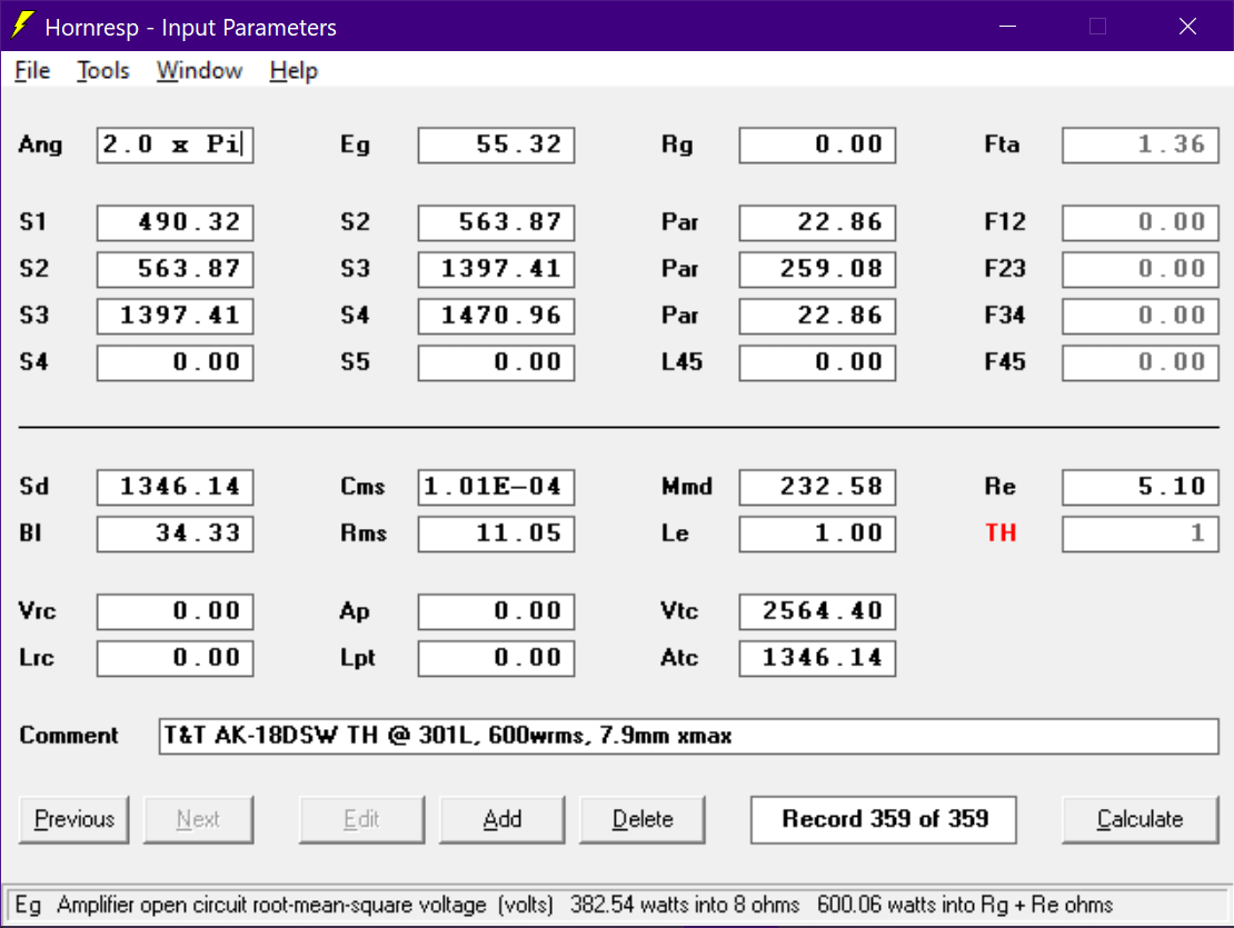

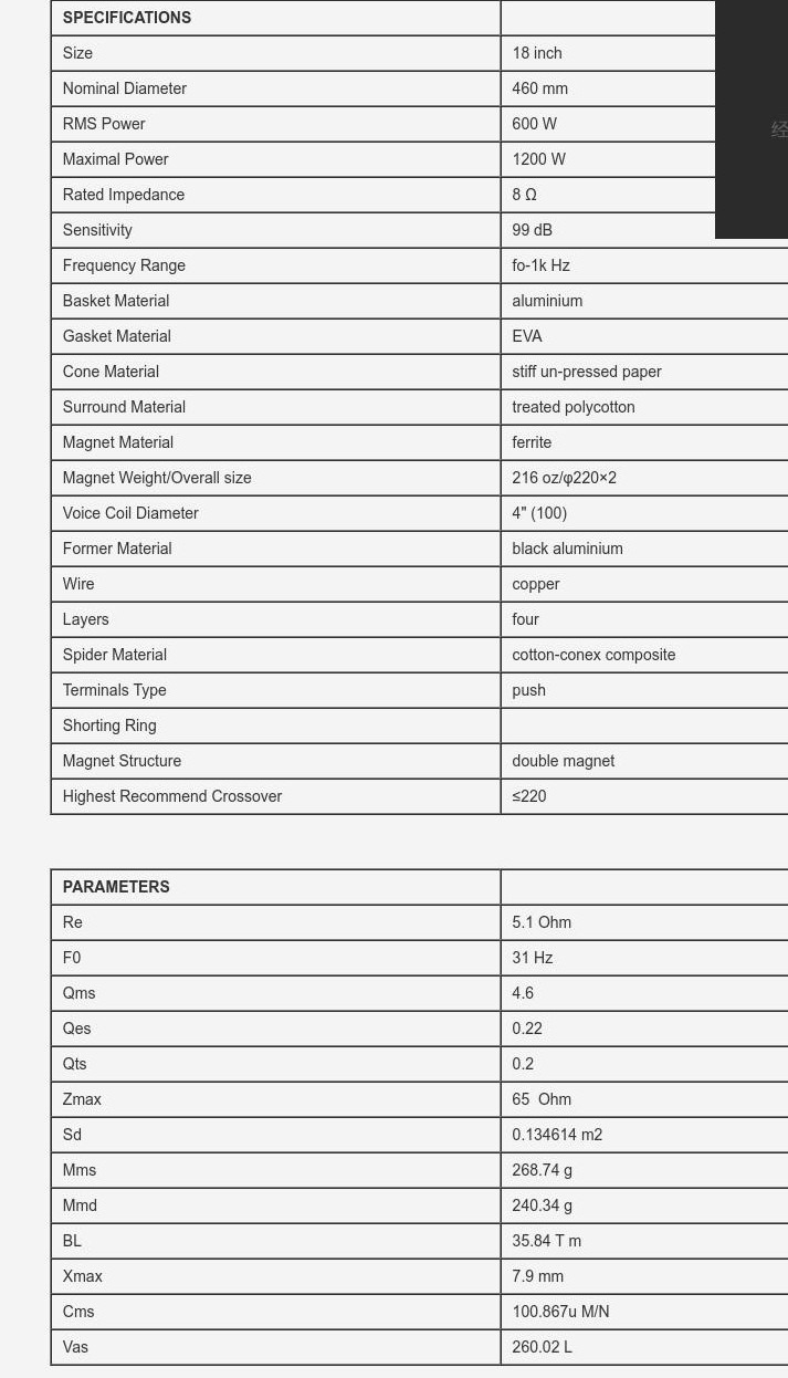

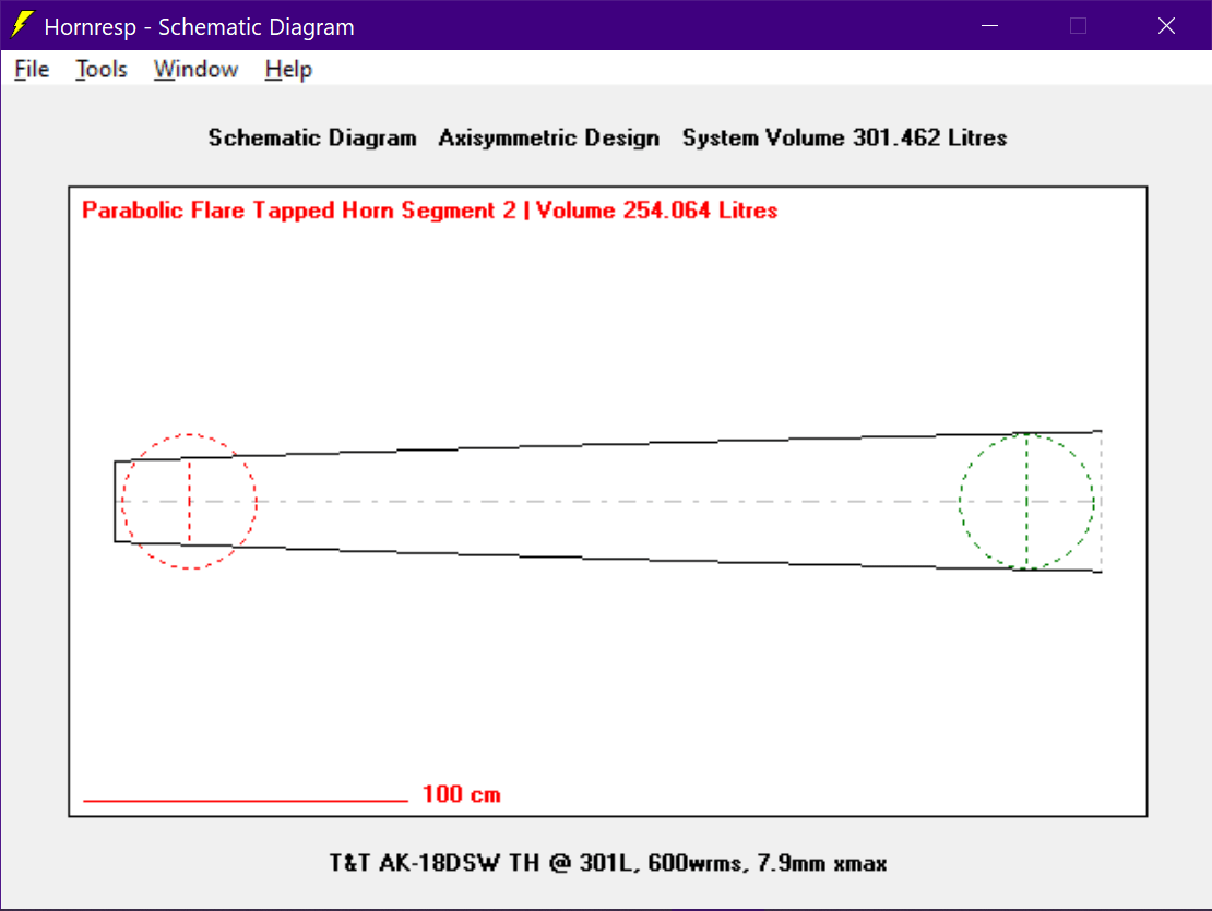

The Xmax is too low 7.9Hi everyone! I wonder if this driver is man enough for this Th design ?
But the BL is on the high side ,
What brand and model is it?
It's ak18dsw from TtspeakerThe Xmax is too low 7.9

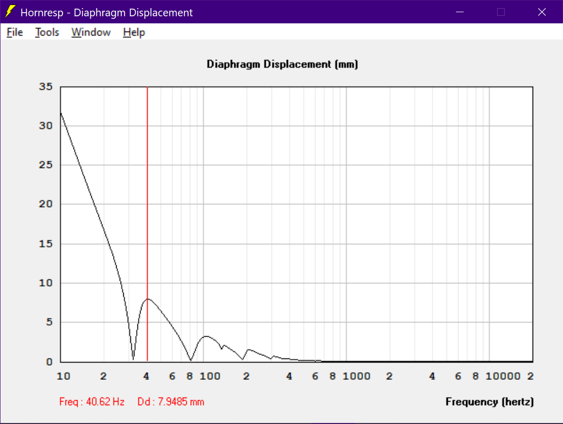

hard to tell how xmax is defined here.... if its pure geometrical xmax, its not too bad. The total power is not a lot with 600 Watts... Looking at the magnet here:
http://en.ttspeaker.com/products_detail/productId=212.html
I´d suspect that BL is either not valid or that the VC is very short and xmax is determined by the typical equation... VAS is quite hight, too.... My feeling tells me, its not too suited..
I´d fire up hornresp or WiniSD, input the given parameters and cross-check if BL etc.. add up....
Considering the real displacement will be lower then predicted from Hornresp you could also add 20%~30% over it. You can go even further regarding the distortion you consider acceptable but of course i would require to check the diaphragm displacement at Peak Power condition (if I remember well, 4 * AES RMS power) and it needs to be lower then X-mech.
