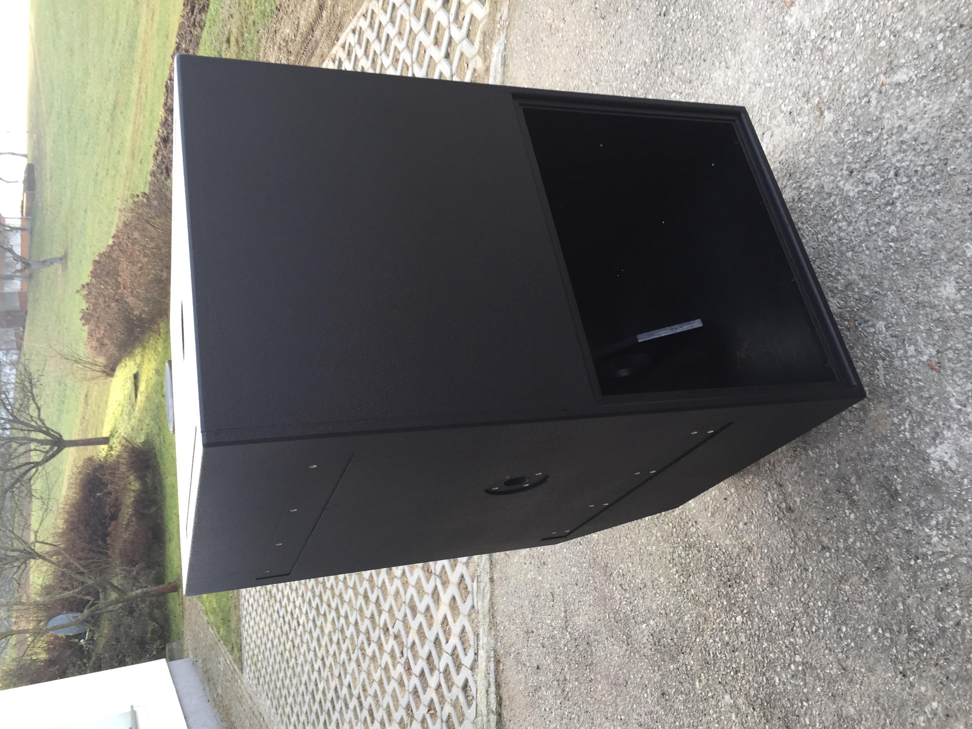

we are 5 diyers scattered across the country. so we never had all the cabinets at one place yet. personally i'm building 8 pcs, from that 4 pcs are active powered with pascal x-pro modules, my friends do all their subs passive. we're using 8ohm drivers, because the 18hp1060 has less power than b&c sw115 but higher sensitivity. xmax is lower but controllable. we're using dsp and amplifieres like powersoft k8 and lexa L10kx. so no problem to drive 4 subs per channel. all the woodwork was done by cnc. the size of the housing is adapted to metric "standards" (100x60x78cm hxwxd). i hope you can see the pics showing some naked boxes and the first painted prototype.

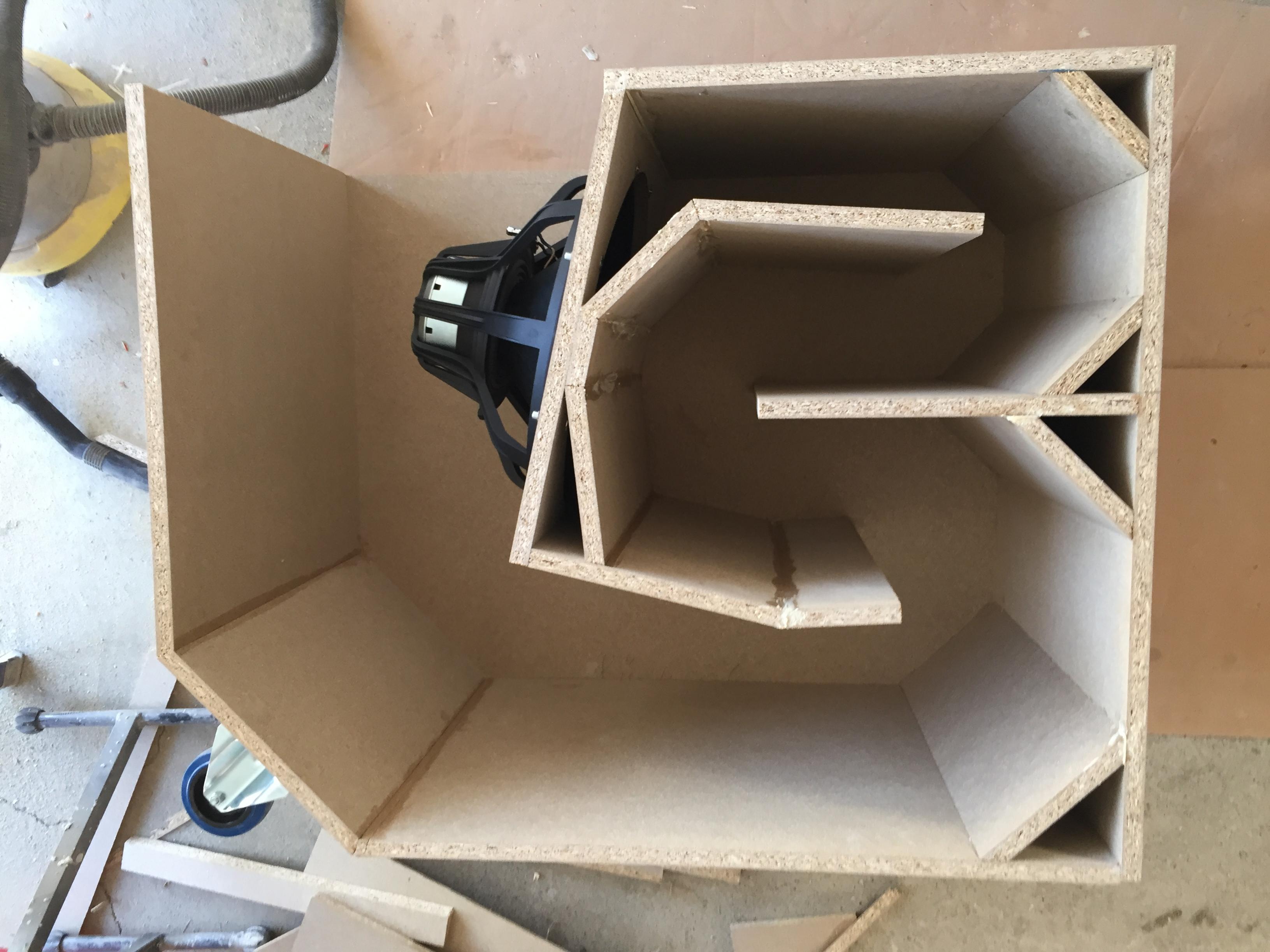

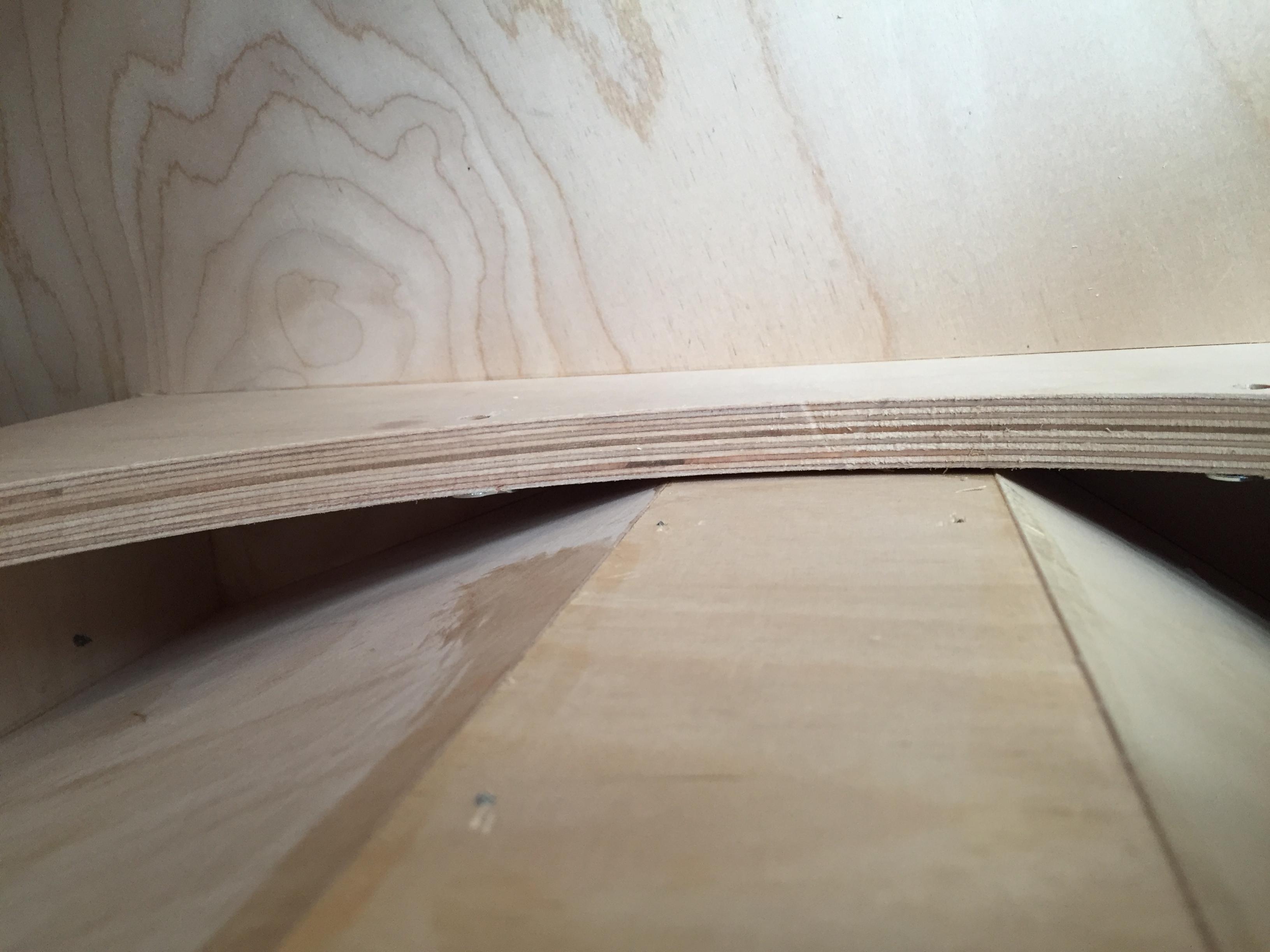

Looking at the photo of the prototype I just hope you left enough room for the excursion of the speaker cone. x-mech looks very close to hitting the internals.
Assuming that that is a single thickness of 18mm (3/4") for the baffle, and x-damage for the Faital 18HP1060 is 21mm.:scratch:
Hi xoc1

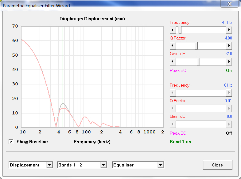

its exactly 19+2mm. have a look the gap. the prototype was only 19mm, so you were right. the sims and also the measurements are showing xmax is about 12mm at 47Hz with Pmax.
at 47Hz center we have a little hump, a correction of -2dB in this range brings xmax back to 9mm. i think loading is good, when testing the later versions we find out no problems with xmax. i hope we are far away from xdamage😉

rectification: xmax is 12.5mm, the prototype was made with 19mm pressboard. please excuse my confusion. the grinding dust makes a little dizzy....

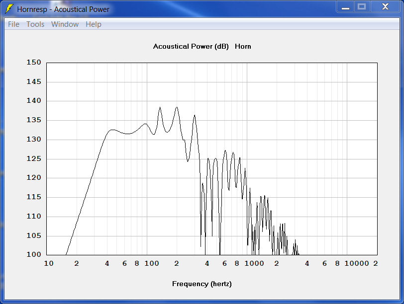

this simulations came very close to our measuring we did in different situations ( except the resonances above 100Hz).

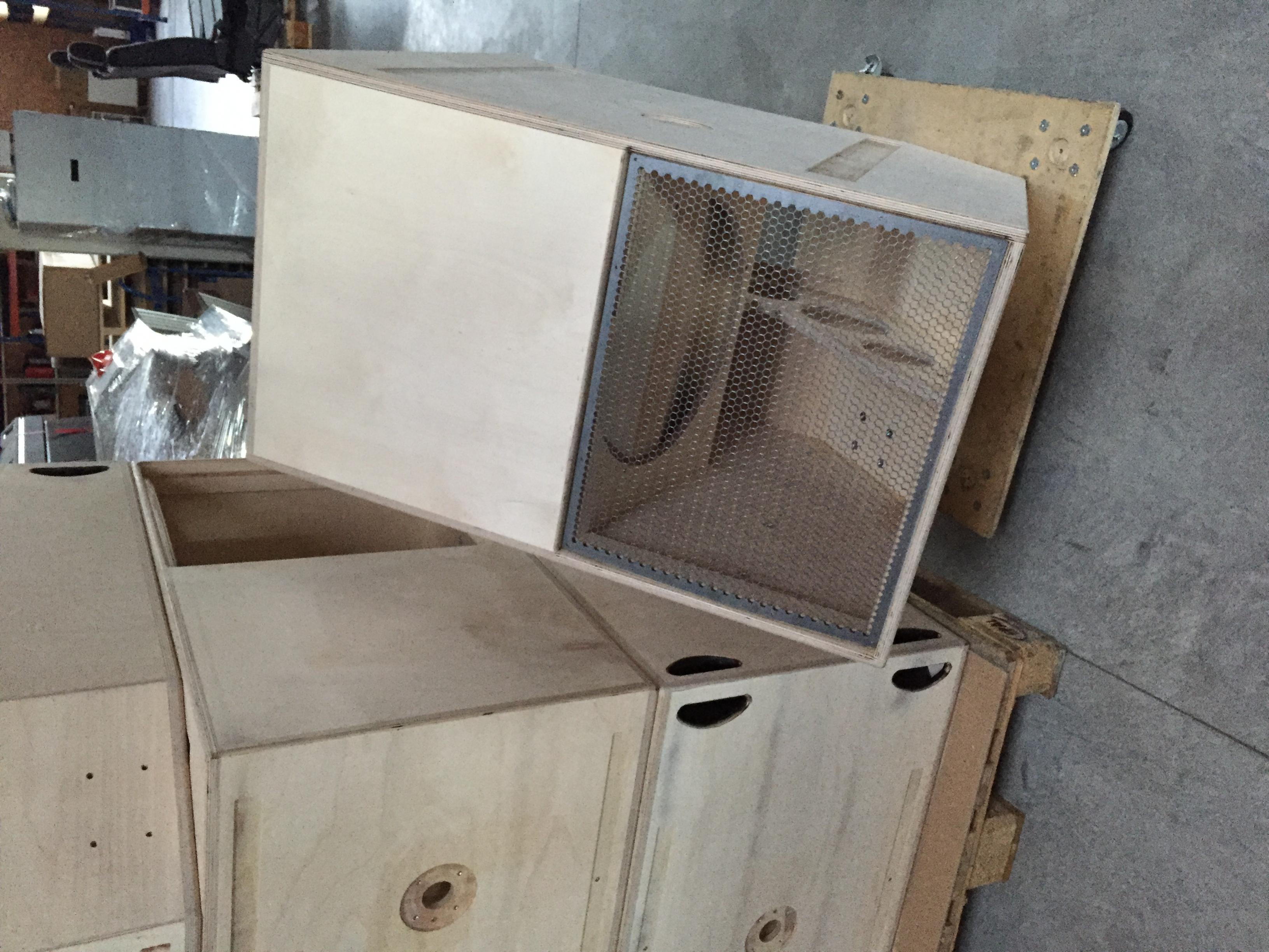

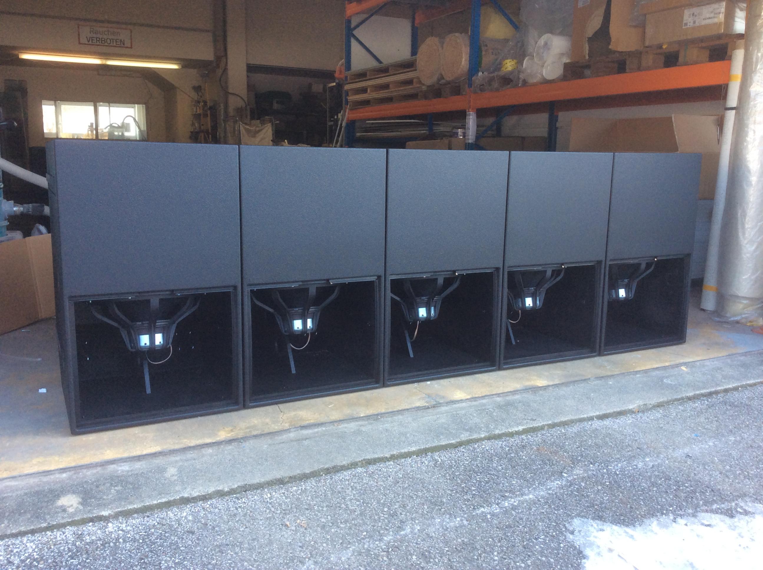

the main reason for the 18HP1060 was the best price/performance ratio. we do not targeting maximum output from a single box. what we want is the characteristic sound of the tapped horn. with a little EQing you can manage almost every setup. the fellows (300km away from me) already did a few smaller gigs with their cabs (see picture showing some of their cabs after painting and assembling) and they are very happy.
@xoc1: what do you think about?

The cabinets look very professional. Should be a lot of fun to run them all together. How you are going to arrange all these cabinets?
The spec sheet says x-max is 12.45mm, which as we know is what we aim for, as once it is exceeded distortion starts to increase. But during 'rock & roll' this could be exceeded and probably will. It only takes an enthusiastic DJ, or an unlimited kick drum. The speaker should be designed to take dynamic transients as and when these occur.
I don't know if the EQ will be very helpful. A large signal at that 47Hz frequency will just drive the speaker as far as the amplifier can manage. I usually aim to sim a high pass filter that gives the same displacement below the lowest minimum as above. Final assessment of the filter should then be done by practical testing with visual inspection of what the speaker cone is actually doing.
Remember that the Danley TH118 has a double thickness baffle, so the dimension you have made 21mm would be nearer 36mm. You don't want the inner pleat of the driver to touch the cabinet. On some speaker designs where the clearance to the edge of the cone is minimal, small grooves are machined to avoid any chance of contact.
If nothing else could be done I would be tempted to add a packing piece between the driver and the baffle to increase the clearance. This would be more economical than replacing 36 cones when somebody drops the mic.
this would be vers simple to improve using a router and a copy ring. only a small cut of lets say 5mm in the Area of the triple-roll.
when we visualy tested (looking at the coil wires and measuring the movement) never have seen an excess of the cone movement also at extreme levels. we used dynamic signals and sine-waves. but we found out one thing: sinewave 31Hz@Pmax longer the 30 sec makes the coil smell��. no damage but not recommended.
the only pro of our clique is preparing some stacking options by using bass mangement software. i think most of the time we need 2 subs per side... we will see
