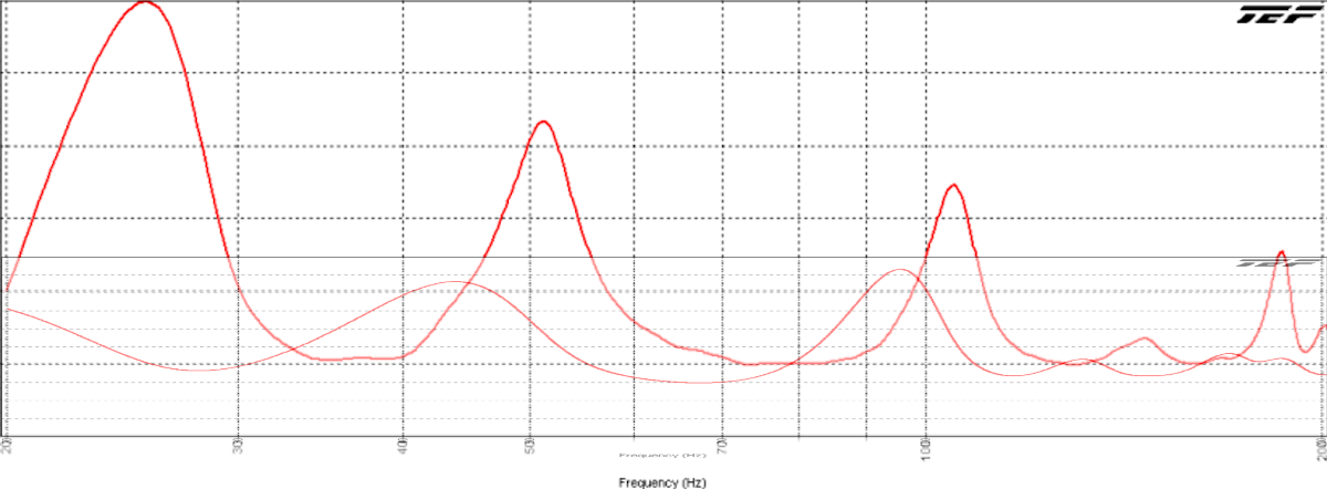

The lower resonance point is a function of the horn's geometry, not the driver used in it.
Here's my rough attempt to overlay the impedance curve for the TH118 on the published on for the TH115, which is basically the same horn with a 15" driver. Note where the lower resonance point is for both. Basically it looks like the whole impedance measurement has been shifted down by 10 Hz, and the impedance magnitudes reduced by a factor of three.
Hmm, maybe that's exactly what happened... :).
