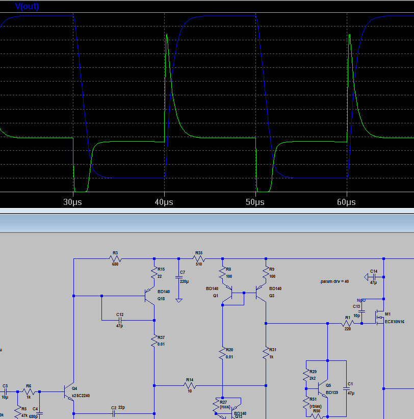

I dropped the Cdom and phase lead down to 22p and 10p, respectively, on one of my spare TGM8 boards. This with a KSA1381 VAS transistor. No signs of oscillation but I dared not go lower. I can't be sure whether it sounded better or worse than before - either way it sure sounds great to me

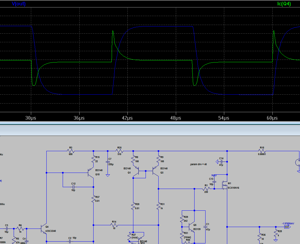

I believe in my actual build (with 47p Cdom and BD140) the input transistor is having difficulties charging Cdom at high frequencies so there is compression.... Lowish slew rate issues.
Simulation shows compression on the negative spikes of the current on the collector of the input device.

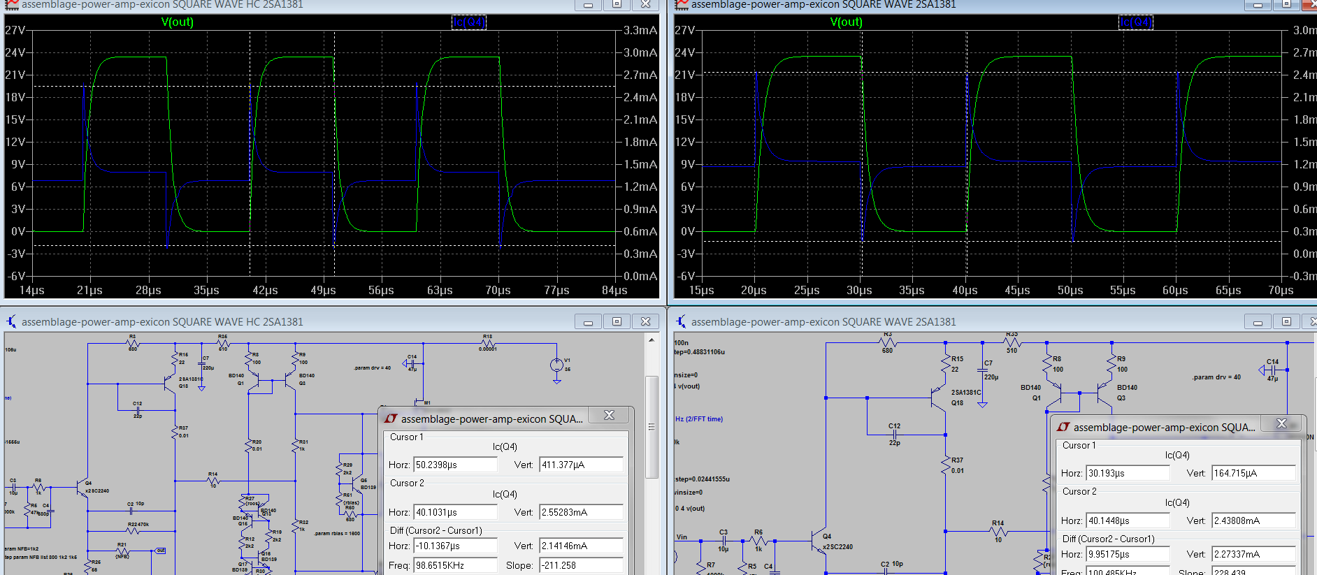

Now look at what I got when using the lower Cob KSA and the latest suggestion for Cdom and Clead.....
Much better spike symmetry and the lowest point of the curve does not reach zero possibly indicating no compression.
On the left you can see the simulation with 8mA current on the VAS and on the right the "normal" 5mA version.
I do not know if there is any sonic benefit but I was instructed that the VAS should run at highish currents so I am inclined to try the HC high current version.

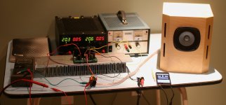

Today is Canadian Thanksgiving holiday and I found a couple of hours to install the power devices in the 2nd channel, clean up the board of solder flux. I've made the 'LED fix' and swapped around the orientation of C3 on both channels so they're both fully functional.
I also powered up both boards on a bench supply at +/-40V rails to ensure dc-offset and bias were at reasonable settings. I had a chance to listen to a bit of music through my sons iPod and my Moon Onken speaker - the first time I've heard the amplifier this year - it still sounds good even with an iPod
