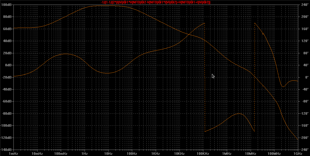

I think using alternate compensation techniques, an amplifier can be made which is impervious to capacitive loading. With traditional Miller compensation, the output impedance goes to -180 degrees. This is negative impedance, no wonder why they always oscillate into caps. I don't think this kind of amplifier can be unconditionally stable unless it has either high output impedance (and/or low NFB), or a zobel.
Just for intrigue I've attached the OLG of one of my latest experiments. Compensation is an open field, I think there is more to be "discovered" here.

I agree that an amplifier should be stable into any cable, and I wouldn't want to live meters away from an RF transmitter. Cordell talks of terminating speaker and interconnect cables to eliminate their transmission line properties, which can excite the instabilities of the amplifier.
