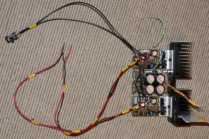

I don't have much in the way of inductors in my junk box, at least nothing that wouldn't melt. But so far no indications it's unhappy driving my two way (cross-over) floor-standers via fairly long hose pipe sized cables. I may be able to dig out something close to 300uH.
The next couple of days I'm going to draw a line under these tests and close out this stage of the project. It's been interesting, I have learned the value of making these things robust and will do some reading on this topic before I start my next project.

The output inductor will only give so much protection and it is actually better to do these tests without one in place.
To get the compensation "just right" (from a 'sonics' perspective) may be a noble cause but it can mean the amp is teetering on the brink of oscillation. I have found simulation to be the best way to get to a close value and to check phase margin. You can even run these capacitive / inductive tests via simulation to get a hint as to how the amp will behave.

Of course it's your fault fortunately I bought 50 output pairs for TGM in the first place over a year ago - Digikey had an attractive price break. However, the pcb gets abused each time I replace them so I don't fancy doing this often.
Are the oscillations I provoked with the capacitive load an indication that I need to make further changes or does it simply mark the boundaries of where the amplifier can operate and I leave things as-is ?
Would changing Cdom actually help if the oscillations were confined to the EF output stage - I've seen base-emitter caps added to output stages before ?

The reason for compensation is to get the phase of the feedback signal correct, so that there is no positive feedback. Changing the value of cdom will be the 'dominant' factor. As far as I know, oscillation is not confined to any stage. The outputs will not withstand a lot of high frequency signal, regardless of the source - they will overheat and fail. The small signal stages before it will cope with HF no problem.

I thought it was possible to have oscillations locally, anywhere there is a local feedback loop. The output stage is EF, so it has local feedback built-in via Re. Although some folk don't like to think of EF as having local feedback it's there all the same and can oscillate all by itself. I'm not sure if the front end of the amp can do much to help - it requires the zobel and output inductor for that ????

If there are (guessing here, not an expert), they are probably not strong enough to damage your outputs. A low amplitude oscillation can exist and not have any real impact on the overall performance or sound quality.
Try a higher value for cdom and see how it goes.
For what it's worth, I have never had to use lead compensation in any of the amps I've built so far. Look at that too - it may be the cause.

I tried removing the phase lead and it's unconditionally unstable even with more Cdom
Reduced the phase lead to 10pF (it's pretty toxic so I prefer this to the 22pF I had before) and boosted Cdom from 68p to 90p and then to 112pF.
With 10p lead and 112pF lag the thing is stable into loads of 10nF, 20nF, 470nF, 940nF and 1.4uF. Ringing is non existent up to 20nF but appears at 470nF and gets slightly worse with higher capacitance.
Test duration kept very short - don't want to destroy it again.
So it seems some phase lead is needed and then it's a case of higher Cdom as you suggested.

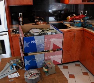

Trying to clean my kitchen and make spaghetti sauce simultaneously. My kitchen can become the remote assembly area sometimes:

I like that photo, I can use that with my wife - she'll be happy that I'm doing all this in the basement and keeping my tools off the counter top afterall !!!

Yes, was looking less like a kitchen and more like my garage - my garage is a frakking disaster.

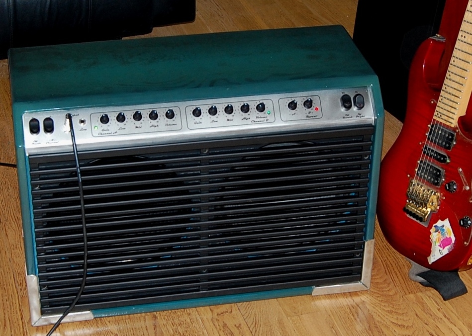

I'm 'playing' a guitar:

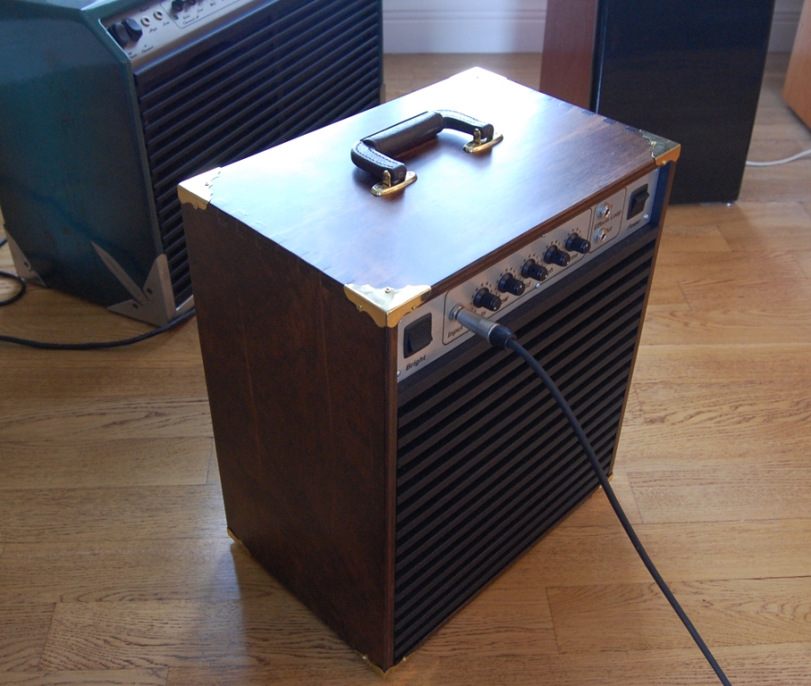

It looks superb - the guitar especially. I know I couldn't make that - maybe you enjoyed it so much you'd like to make another one
Joined 2009
Very nice guitar amp - not sure why you needed two ?
