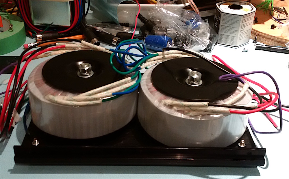

I've given up trying to squeeze a decent power supply into the small chassis that I'm using for my power amp. I've bought a box off of ePay and I'm going to build a power supply into that. It will power my power-amp over a short cable and also provide power to a separate pre-amp.
So far I drilled out the base-plate and mounted the Toroids. There are two, one for the L channel, one for the R channel. I'll be keeping the power grounds separate but both will be connected to mains earth through a ground-loop interruptor (diodes). Photo shows progress.
There will be rectifier and caps to go in the box too. The transformers are 36Va.c. and I expect around 42Vd.c. after rectification.
Not yet sure what kind of connectors to use for the dc supply umbilical to the power amp. Ideally, 7 pins, conveying V+, V-, GND for L and R channel plus a spare. I have some 7-pin DIN sockets and DIN plugs which would fit nicely but they aren't the largest most robust connectors. However, being on-hand they are likely what will be used.

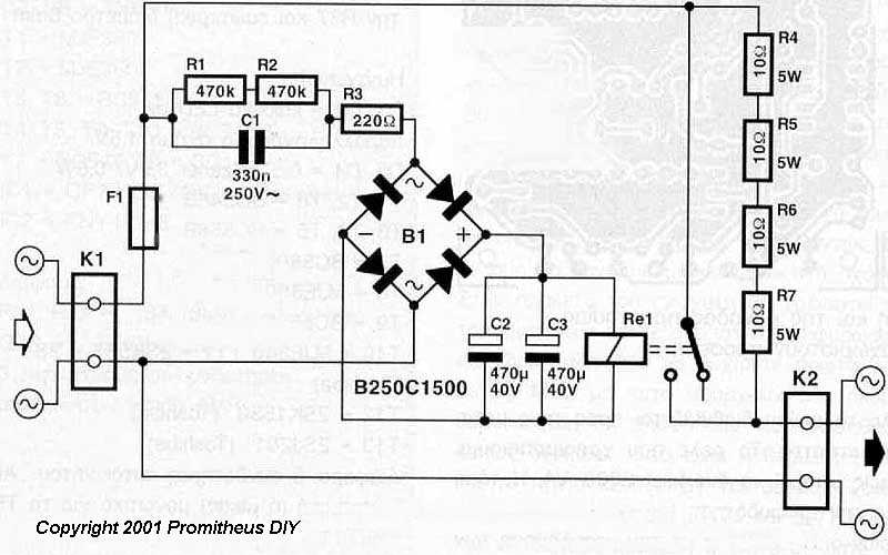

mains dc-blocking ? - I haven't provided for this. If I need this, I may not have space to include it. Do you have a recommended approach/circuit ?
Joined 2011
Many threads here on DIYA about mains DC blocking. One big controversy in them is: do you, or don't you, need to install two electrolytics in series? Rod Elliott's article emphatically screams YES. However, Bryston (Canadian high end mfr) ships product without two electrolytics in series, yet their gear is famously reliable. Tell me what to do, Obi-Wan?! I'm scared and I want Someone Else to make this decision for me??!!

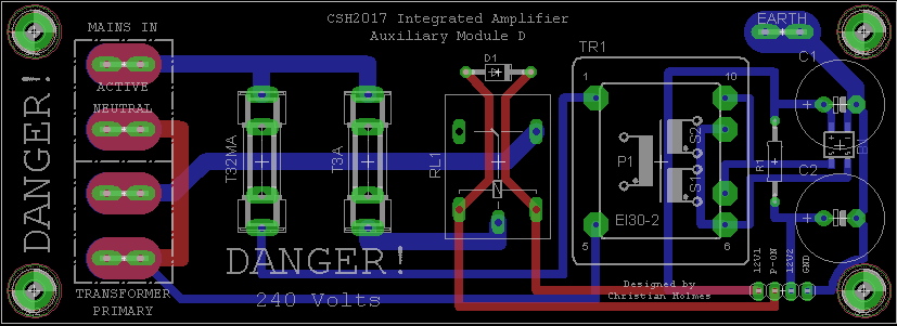

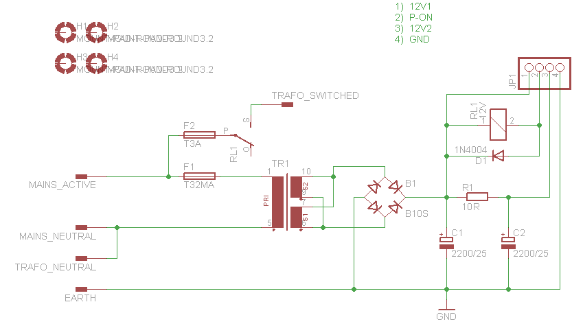

Hi Bigun
Here's the sch and pcb for a simple mains input module that you might find interesting. Its designed to sit at the back corner of the amplifier chassis, in front of the IEC socket.
It holds a small onboard 9V transformer that powers a housekeeping microcontroller and 12V for the main transformer control relay and smoothed 12V used to drive the signal relays used to select the source/line input.
My main transformer is a 200VA with modest smoothing caps behind it and I've never felt the need for inrush limiting, but if you are using bigger transformers this is definitely something to think about.
The main transformer secondaries go directly to the main amplifier pcb, which includes output muting/speaker protection circuitry and drops out on loss of AC. AC is sensed after the secondary fuses.

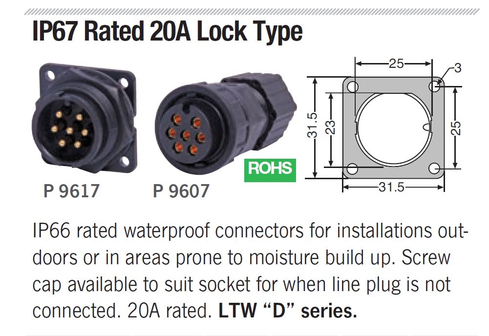

Bigun,
I suggest you use the Amphenol 7pin 20amp LTW series connector between the power supply and the amplifier.
Don't forget that you need to extend the chassis earth from the power supply chassis to the
amplifier chassis, so you will need 7 pins and not just 6. I think you can get a cable from Amphenol that has the plug pre terminated with a reasonable length of cable.

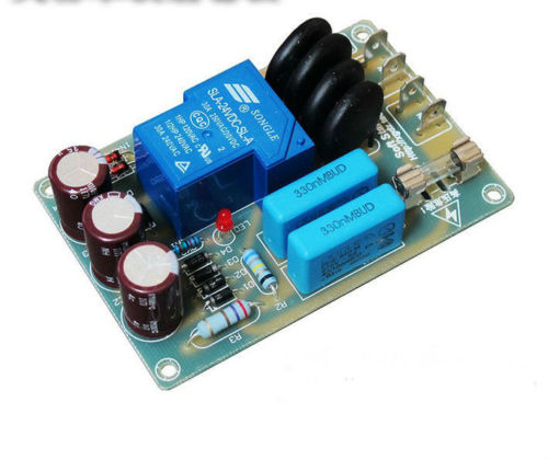

Attached photo of what I have used in the past and no issues. It's not as elegant as your solution and has less functionality but in my desire to get something moving here I already hit the 'buy' button and have one on it's way to me from the East.

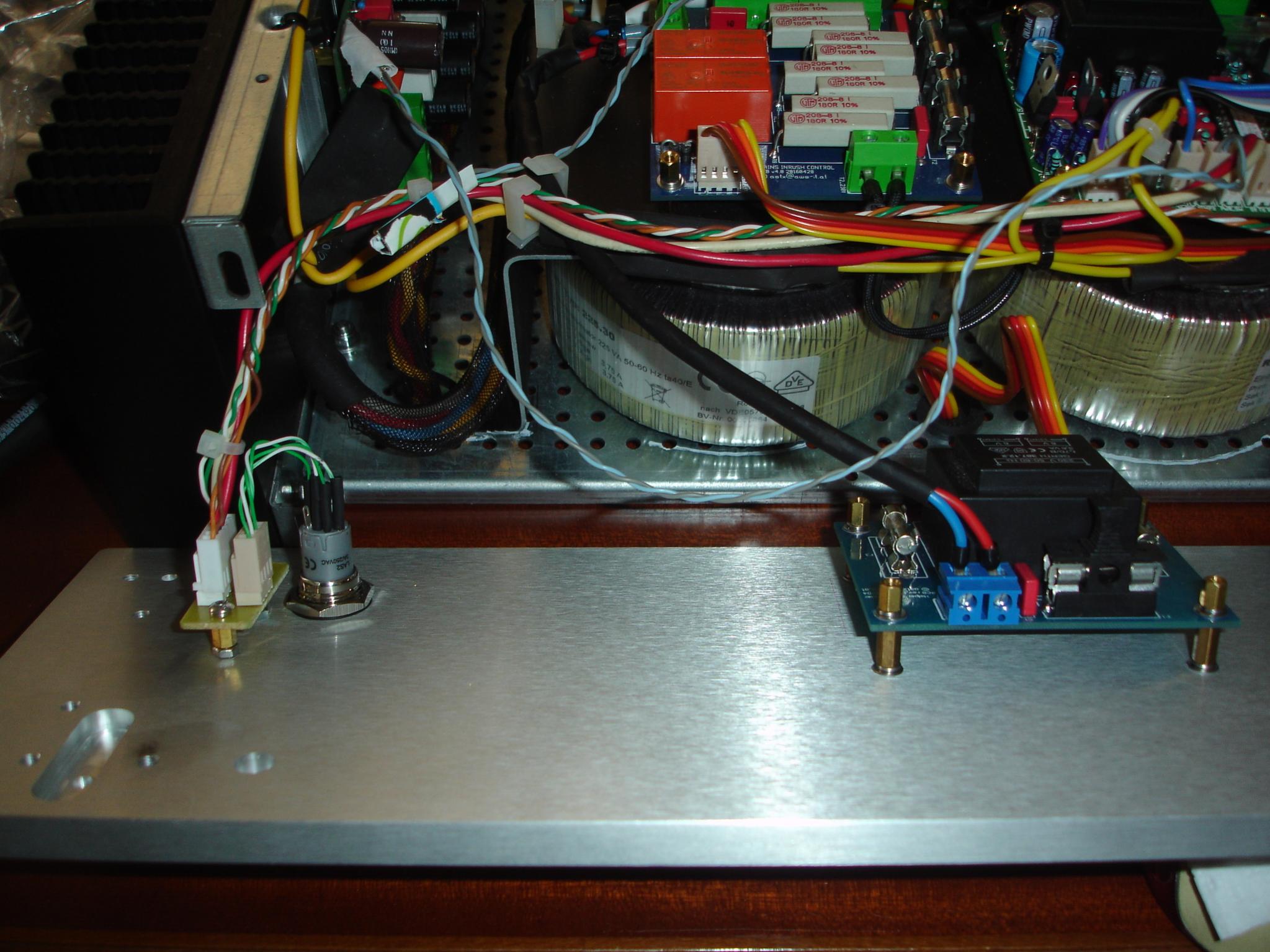

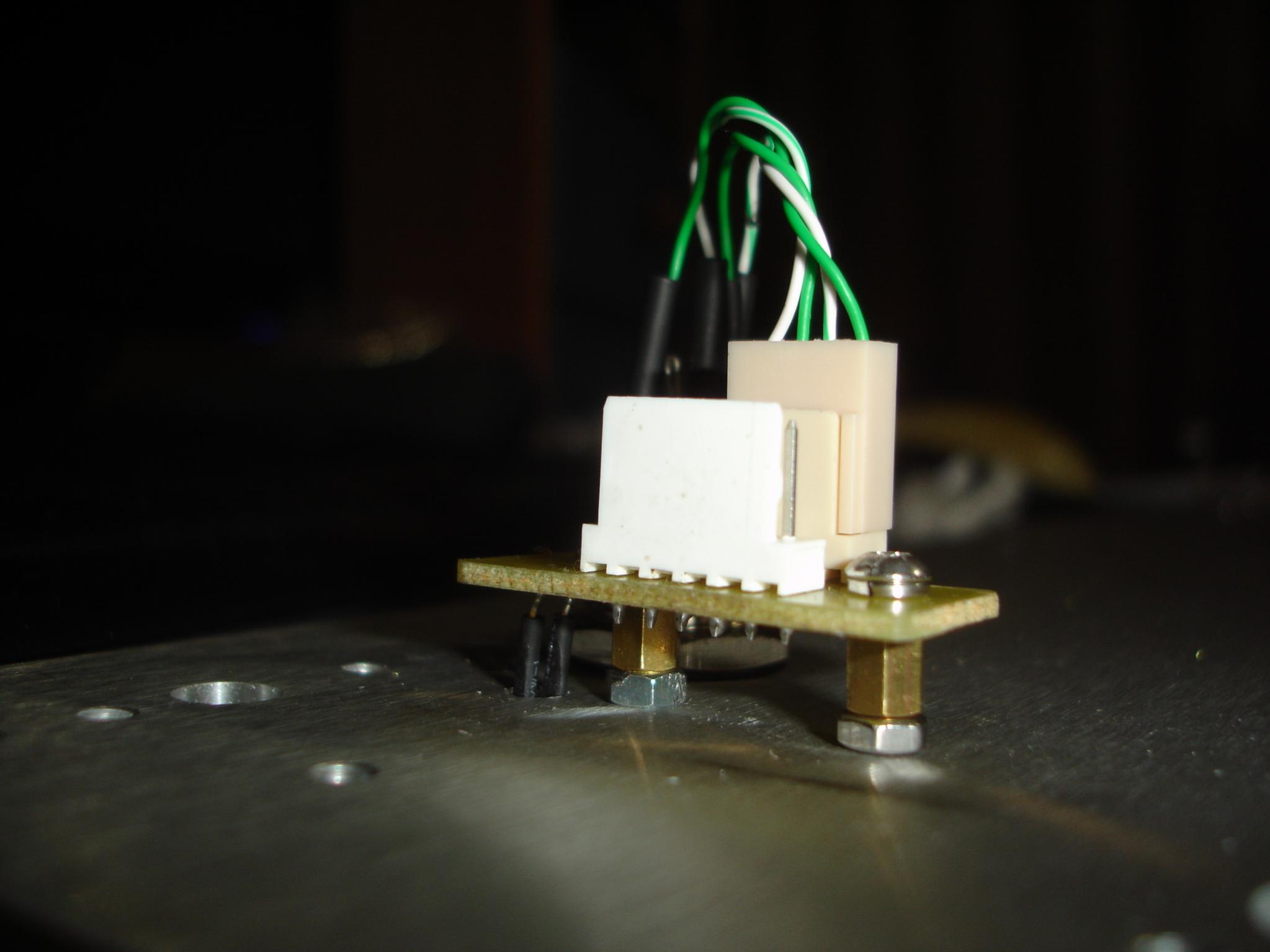

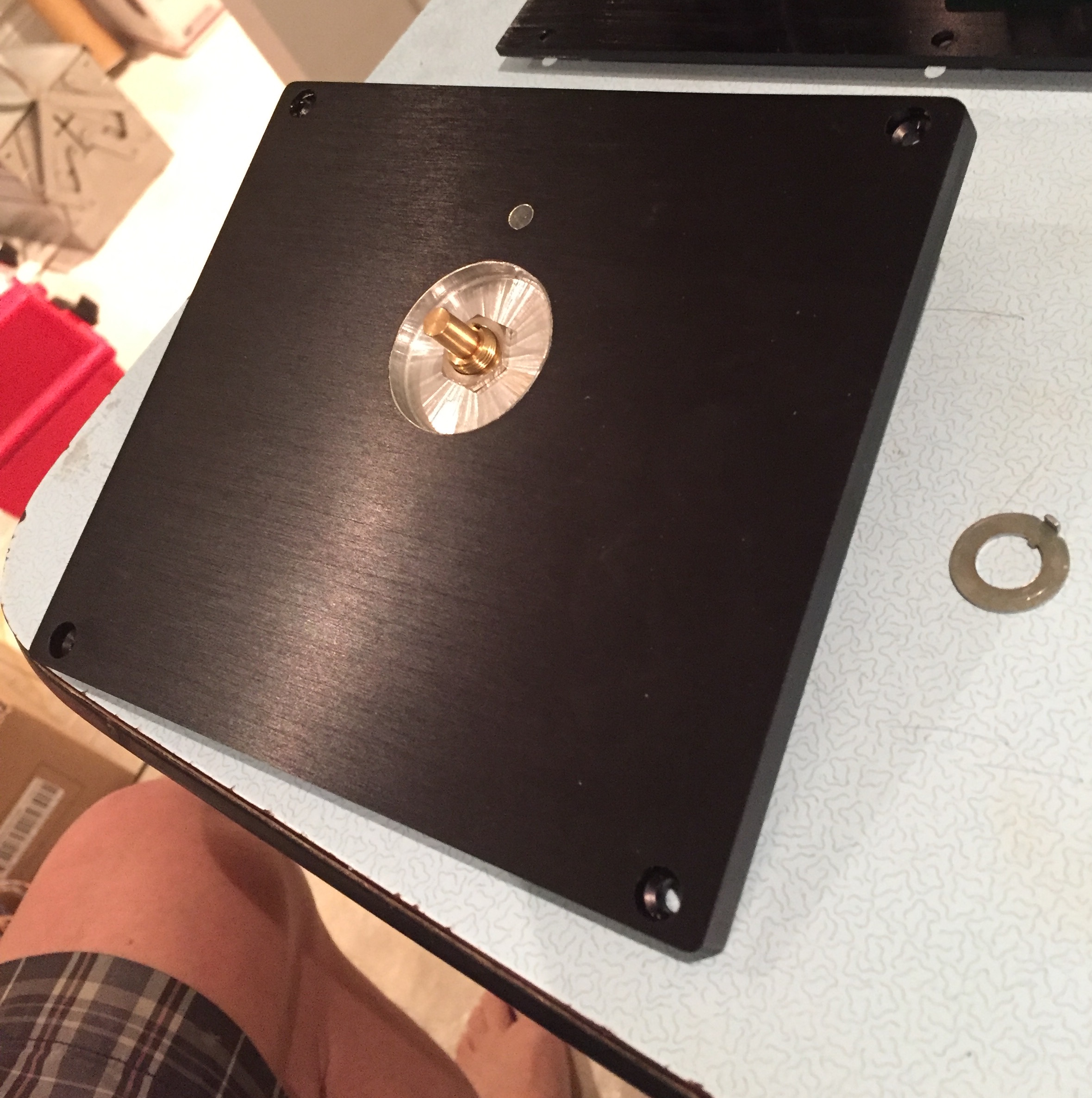

some progress, it's very slow, but day job and house job....
I powered up the drill press and created a rebate to mount the on/off switch on the front panel of the power supply along with a 5mm dia hole for an indicator LED. I'll hunt down a piece of 5mm perspex rod to stick in the front and poke in a 5mm LED from the back - the plate is 8mm thick!
