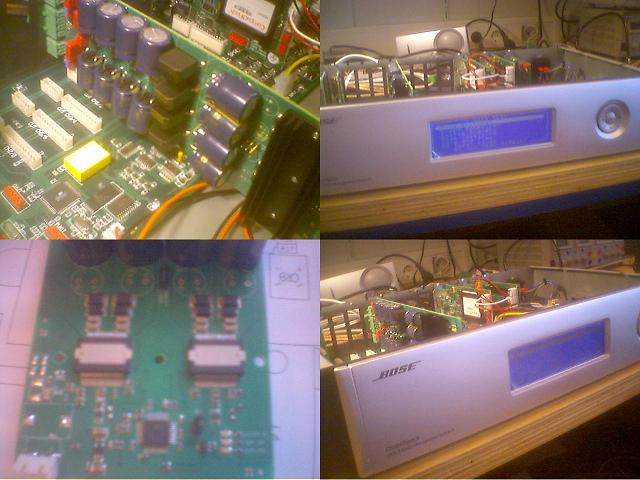

I've got some experience with the TAS5261 and build upto 10 boards with them. The results are quite good and come close to the specs in the datasheets. I've used an AP ATS2 to do the measurments. At this moment I'm thinking of designing a small module with PWM controller on board. So people can use this as a module to work with. Maybe this can be interesting for someone on this forum?
Hello Sproggit,
The pictures are from the first test board. On the board are 2 TAS5261's with a PWM controller TAS5021 (I didn't want to make a software prototype just hardware). It's adapted to work in a Bose audio managment system but only to test the principle. Currently I'm working out a stand alone version. But I'm not quite sure how complete it's going to be (DSP on it or not, and what inputs to put on it). Maybe you can give me some input on that.
