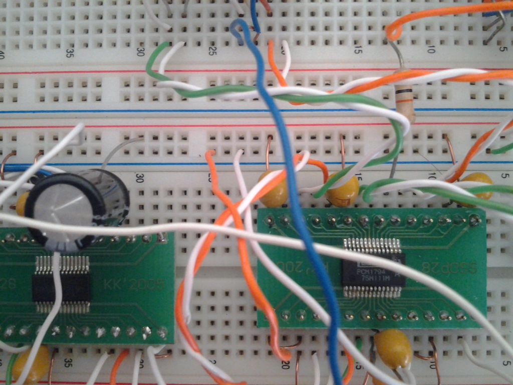

This tests were made with pcm1794 and dir9001 in a breadboard.

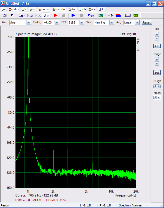

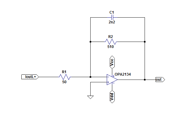

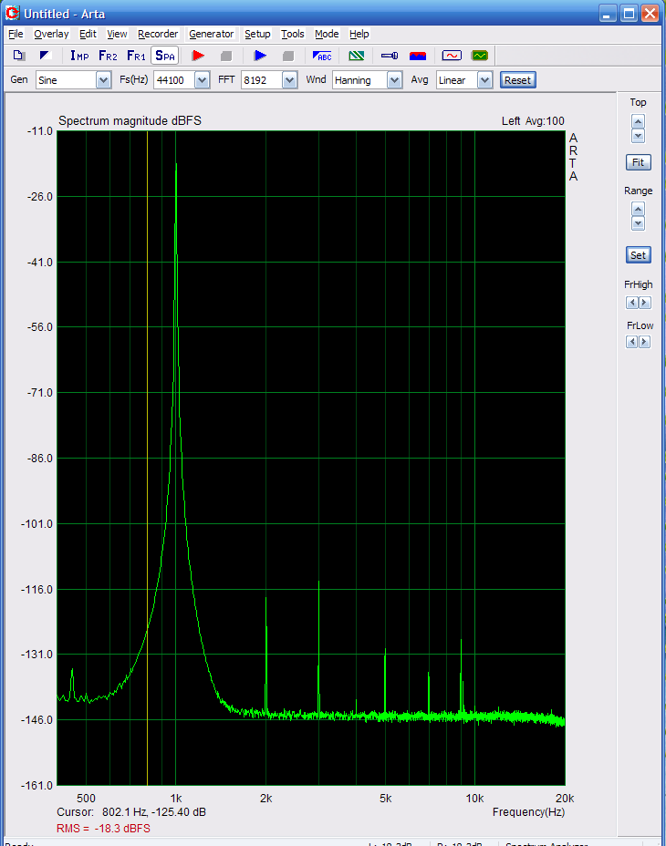

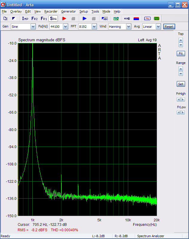

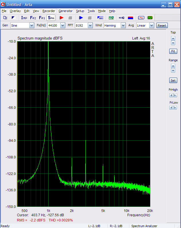

this first test is about the distortion level caused by the impedance at the output of the pcm1794. There is the widespread idea that the lower the output impedance seen by the dac the better. but how low is enough?
this test was made by connecting the pin IoutL+ to a classical ampop I/V converter (opa2134) with a resistor of 50 , 100, and 150 ohms in serie.
the pin IoutL- was connected to ground.
the first picture is with no resistence in serie, the 2º is with 100 ohms (r1) , the 3º is with 150 ohms. the picture with 50 ohms is ommited because there is no visible difference between the one that has no serie resistence.

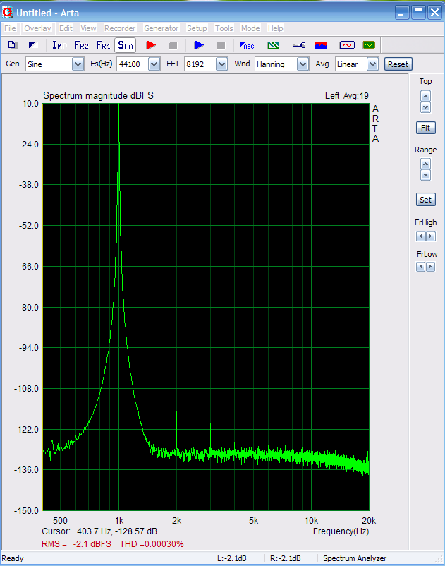

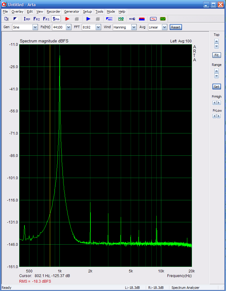

this test was made by connecting the pin IoutL+ with a resistor of 50 ohms to ground and measure the distortion at the pin IoutL+.
The pin IoutL- was connected to ground.
The distortion and noise are real low. (0,0005%) the output level of the dac was -1 dbFS.

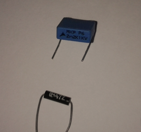

One thing that is important in the case you opt by using this type of I/V converter is to choose a high quality capacitor for C1 (polipropilene or C0G ceramic). this pictures are the distortion of using a polipropilene (MKP) capacitor or a bad quality capacitor.

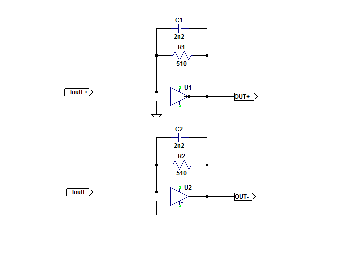

this test use a differencial I/V converter.

summarizing:
There is no problem using a I/V converter with a input impedance of 50 ohms or lower.
There is not a great difference between differencial or single end.
Ween using a passive resistence as a I/V converter connect the IoutL- and IoutR- pins to the ground.

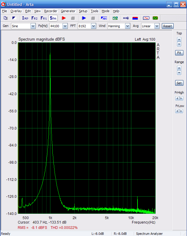

In post #4 i use 1k ohm , this post is just to warn about the use of bad quality capacitor in the feedback path, that can have a huge impact in the linearity.
the best results in balanced mode was 0.00022%, that is also the limit of the emu1212m.
But breadboard is not the most perfect environment for sensible audio equipment ( a good ground is very important to keep the distortion and noise values low).
In this test i use 510 ohms and no capacitor.

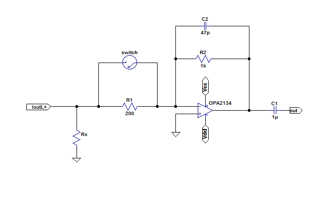

output impedance of the PCM1794
One important value is the output impedance of the PCM1794.
Some say it is 2k ohms, others say is less than 1K ohms, Ti says is 2 Mega ohms.
By my experience it is more than 100K ohms .
I have use the following circuit to come up to this result.
first i have use a 10k in "Rx", and measure the output with the switch close and then with the switch open, then i repeat the same procedure with 20k , 100k and at last without Rx. the results are this:
switch - close - open
10k - 21.16db - 21.33db
20k - 21.16db - 21.24db
100k - 21.16db - 21.18db
Zero - 21.16db - 21.16db
As there is no diference in output voltage when there is no resistence in parallel with the output of the dac, i assume the impedance is greater than 100k , because when we use 100k, we can sense a difference betwen the switch is close and when is open.
I have try this with -1db , -21db , -43db ,always with the same result.
It is very difficult to measure better than this, because of the temperature and noise. the 2 Mega ohms that Texas presents is plausible but i can not measure that.

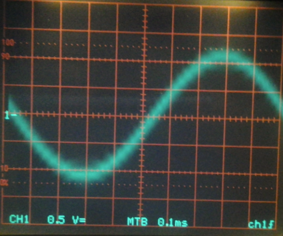

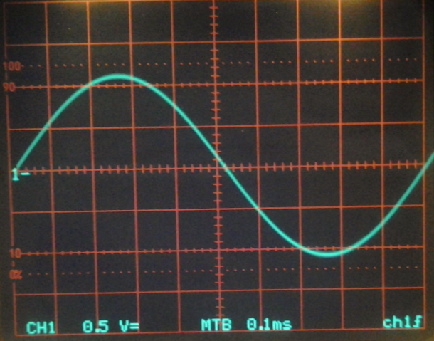

This is the output voltage of the PCM1794 without filter and with a first-order filter.
The cutoff frequency is 72Khz, its a litle bit low , but this is only for demostration.

Can you please detail the 510 ohm I/V resistor placement in your differential test circuit having the low 0.00022% THD?
That was a test to see the impact that ground have in distortion, i was changing the ground wires and test the distortion, i dont think that have 510 ohms or 1k made great diference, the low distortion numbers are mainly due to better ground in this test. A proper PCB is a must in this type of circuitry.
